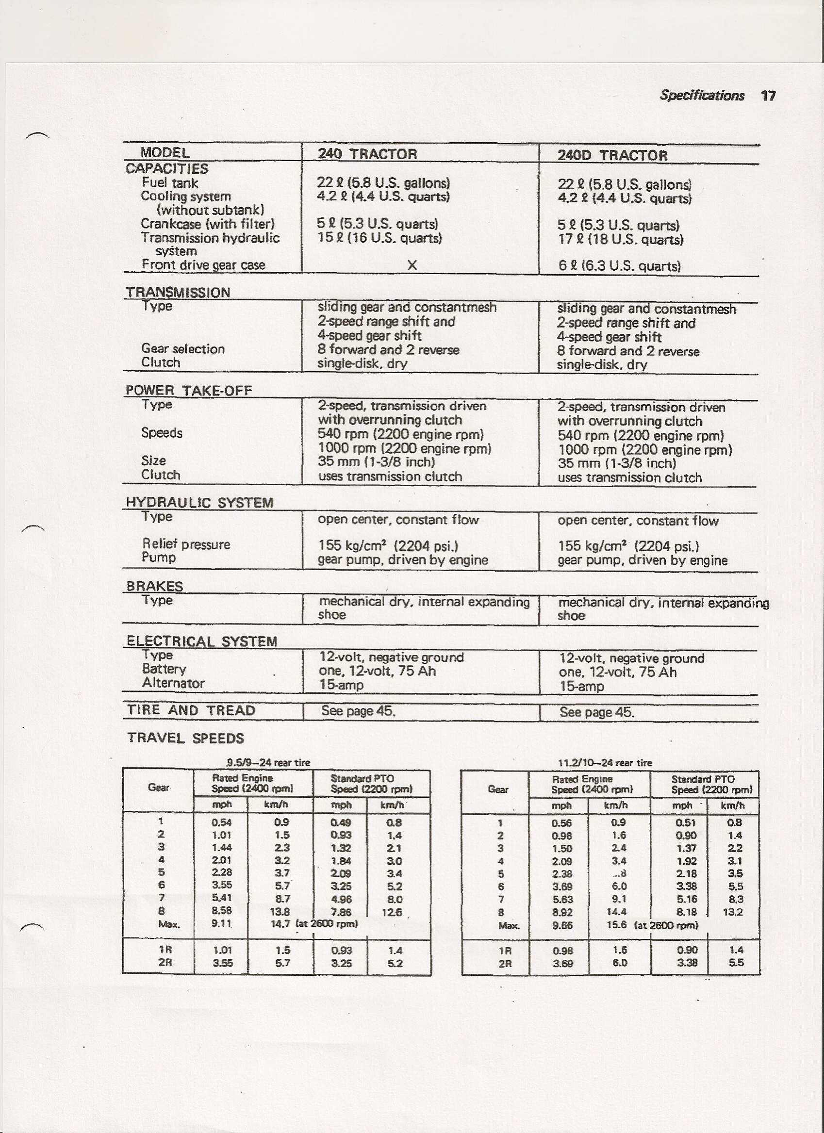

I find 2nd range, 3rd gear good for my ym2002d running at 2000 to 2200rpm. Don't know whether this will help you or not but here is the speeds for a ym240, I believe the same as the ym2000.

Thanks for posting that attachement - interesting information.
It would seem that you mow quite a bit faster than I do.

i also slash at this speed and find it spot on.

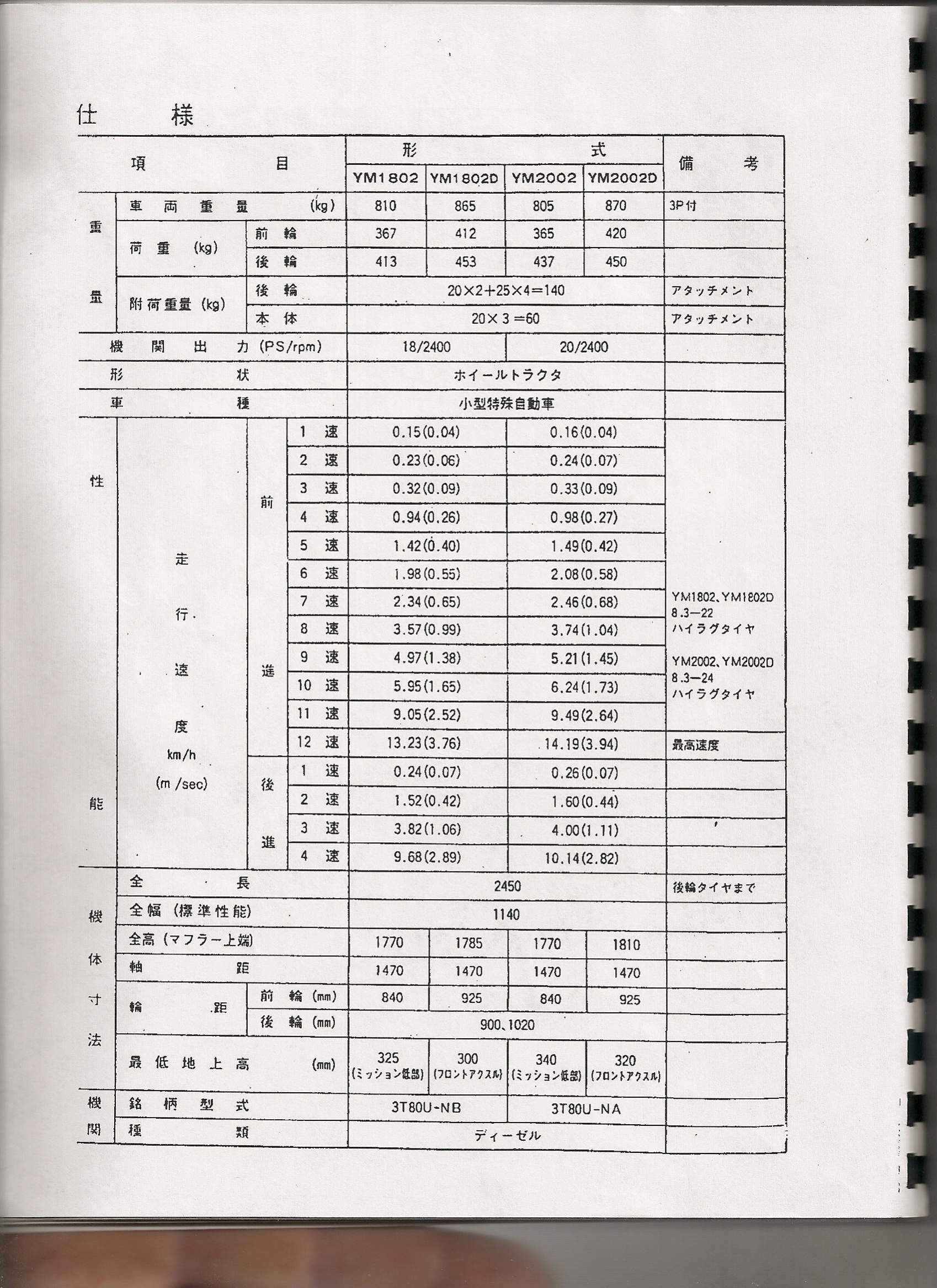

Not sure I do mow faster. I don't know the ground speeds on my 2002. I have 4 range gears and 3 transmission gears. I do move pretty good with the finish mower. When shredding I sometimes reduce throttle some, all depends on what and where I am shredding.
I just found this ground speed chart in my 1802/2002 parts manual. I guess I must be flying. I am assuming I am actually running in #9 if I understand the chart right. I also notice the biggest jump is when you shift into high range.

I try and mow in my 7th gear on my 2000. wi mow about 2000-2200rpm so it would be between 4.5-5mph. If its really bumpy or thick grass i drop to 6th gear and thats about 3mph. If its just bumpy and low grass i just reduce throttle in 7th.
But i was thinking that 5th gear is on the low side and 4th is on the high side? Meaning the top gear on the low side of a 2000 is faster than the lowest on the high range? getting my service manual
/ F215 Gearing for mowing #8
I was right your chart does not show it but the service manual does. 4ths gear is actually 1 on the gearshift but in the High range and 5th is actually 4th on the gear shift but on the high range. I will try and expalin better if this does not make sense but if you have lookedat the gear 3' son a 2000 it makes sense as they have the stick numbered funny for this reason.

.. or described another way, the lowest gear in High Range is *lower* than the top gear in Low Range.
So if you really need to go up through the gears in sequence, then the next gear after Low 3rd is Hi 1st, followed by Low 4th.
No I don't know why they did it that way. Maybe they made 4th in each range far higher than 3rd, so the top gear would be a good high speed road gear. I can't think of any other reason to do it that way.

I think it was ernie that explained the point of it so that your in the low gear set you can have a "travel" gear so that you can get from point A to B with out haveing to stop put it in high and then back in Low. This would be for in Japan where they may only go 15 feet between fields or on a turn around or say from a shed right next to a field. Its not the case for us here in the US as we have more land usually. Plus i almost never do anything in Low anyway, but if i moved in Low 3 i would not use Low 4 to get to my areas from my farm house. Some of them are 150 yards away and some 300 yards, so if that was the case i would put it in high, i would save a few mins over that low speed 4!!
