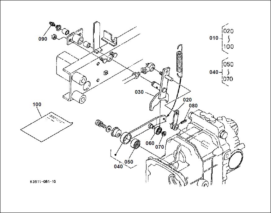

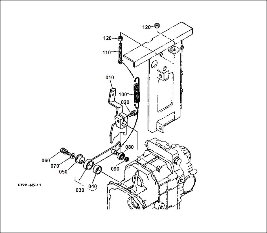

I don’t see any levers on my machine that looks like the parts breakdown illustration of the lever. I can’t tell exactly where the lever would be located with the parts breakdown schematic drawing, but I doubt I have the cruise option.

/ F 3060 #24
I have a few unused slots in my side console. One I believe is for an optional set of hydraulic remotes. The other might be for a cruise control.
/ F 3060 #25
I found a Youtube video of a machine with then cruise control option. The lever would be on the same panel as all the other levers. And yes, no cruise control on my machine. The pertinent section starts at around 3:30.
Doug
Interesting video, thank you Doug!
I glanced at the F3060 operator's manual and did not see any mention of cruise control, but it looks like it was available as shown in the video and mentioned in the spare parts listing.
Looks like your mower's speed control linkage could've had that, but was never installed by customer choice?
Since it's a different linkage, it may only have one zerk fitting and it should be below the fender, where the pedal bushings & shaft are.
Cheers
/ F 3060 #26
Cheers
Arto,
I was beginning to think the same thing, although I cannot see any other linkage that might be related to the cruise control system. I am aware of where the pedal zerk is, so I have that one covered. Also, I am glad to hear I am not crazy.:LOL:
Doug

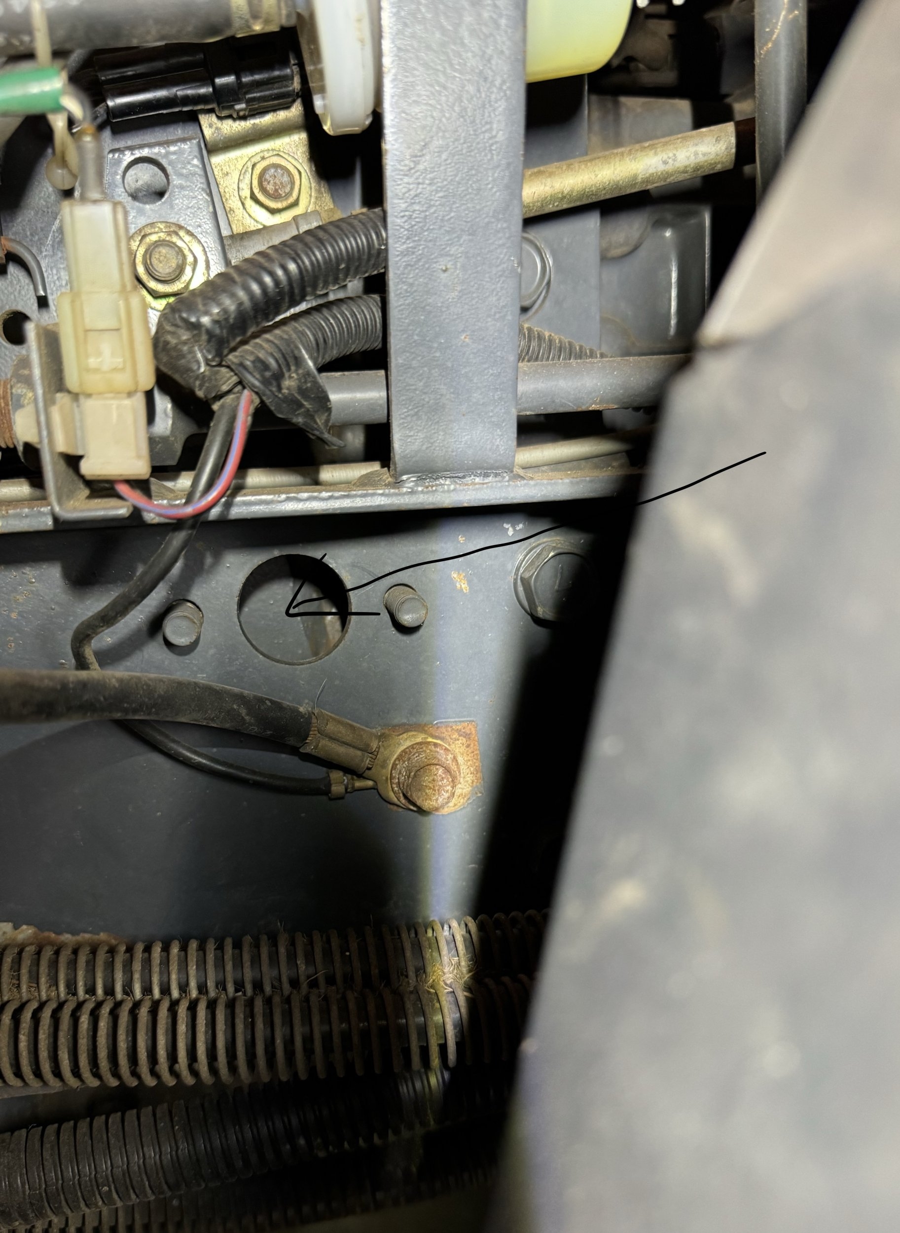

/ F 3060
#27
I ordered speed related ball bearing and bushings will replace for a new reference point.
In the mean time I did grease/oil all related items seems a bit smoother. I did discover the cruise control handle interferes with the the 2 spd hydro handle. CC was pushing fast speed toward neutral.
In addition I'm running 24.12.12 which seems to rub the hydro handle. Not sure I would be using cc too many challenging cut areas. Those issues were resolved.

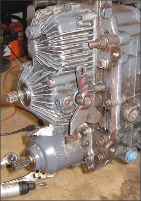

/ F 3060
#32
Just finished speed change parts install fairly simple job. I did find the bushing was missing and bearing spun freely but replaced anyway. Didn't get a chance to mess with adj the linkage, other obligations.
I had noticed prior to this repair the pedal needed to be nudged fwd to engage the brake. And, I manually used the pedal to slow/transition movement to stop.
Where do you start adj first, make sure the neutral is correct (spring adj) then to the linkage? Thanks
/ F 3060 #33
I would adjust the neutral first.

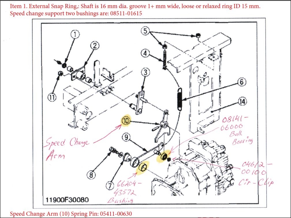

/ F 3060
#34

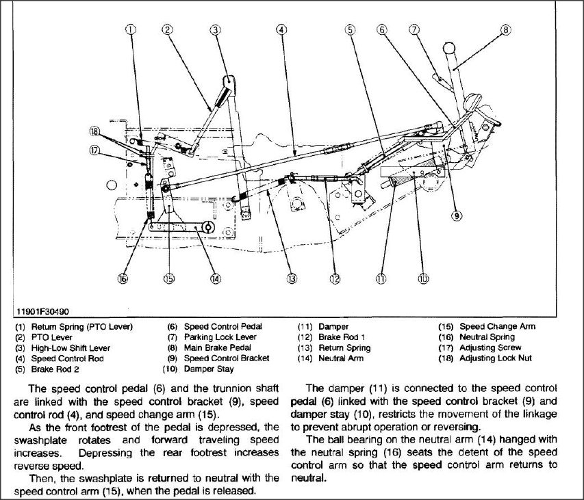

I didn't document the slit positions of the holder shaft (#7) of the neutral arm. It appears to be at 6/12 now are the slits intended for adj to neutral? I did set the pedal then tighten the bolt otherwise having a difficult time find neutral. I still get a little reverse no pedal and slight grind, fwd. Am I missing a step? Thanks
/ F 3060 #35
Loosen the bolt 8. for item 7. (the round piece with wide screwdriver slots) and rotate it when the engine is idling, until the mower no longer creeps either forward or reverse when the speed control pedal is in the neutral position.
IE. The small ball bearing is in the dent of the neutral arm & neutral spring has just adequate tension to hold it in the dent.

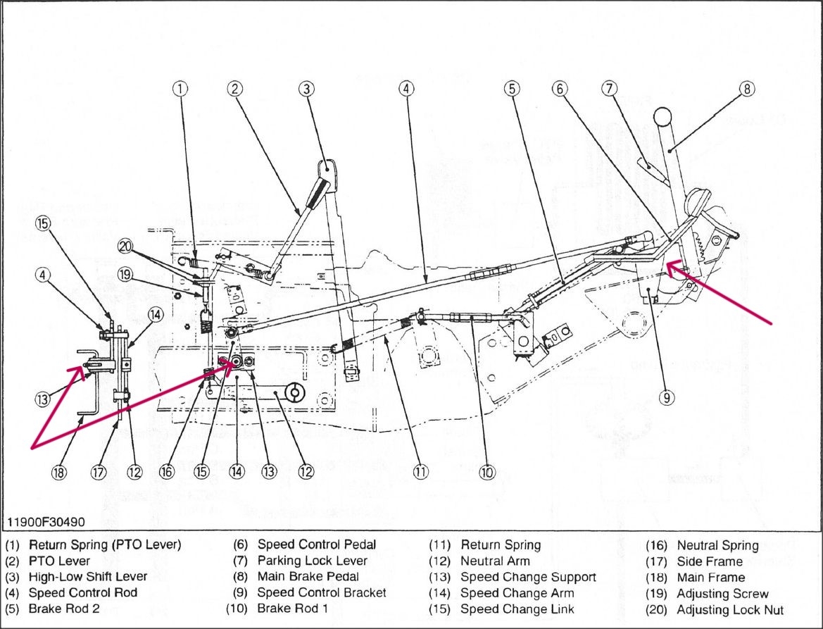

/ F 3060 #36
It would be great to have cruise control. I hate trying to keep the pedal steady.
/ F 3060 #37
Interesting, I have never noticed any issues with that.
F3060 has a damper (Item 11) in the linkage, not sure if all F's have something similar?

My 3060 doesn't have a damper. I was able to adj #7 all is well there. Now next adj best address abrupt off pedal, stopping? thanks

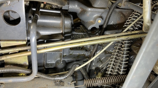

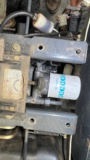

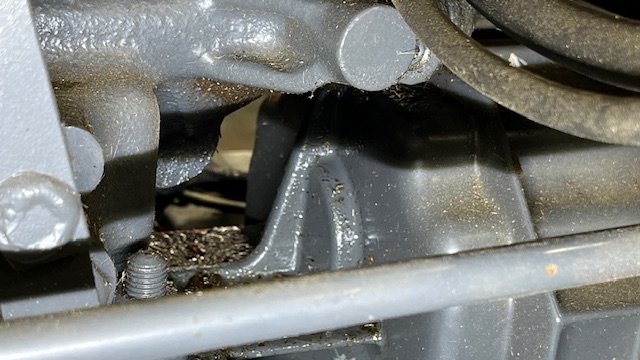

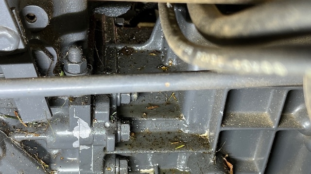

Now, I have noticed some oil drops which have gone from a drop or 2 to several. There aren't any obvious simple sources of that oil, any thoughts?
Thanks
