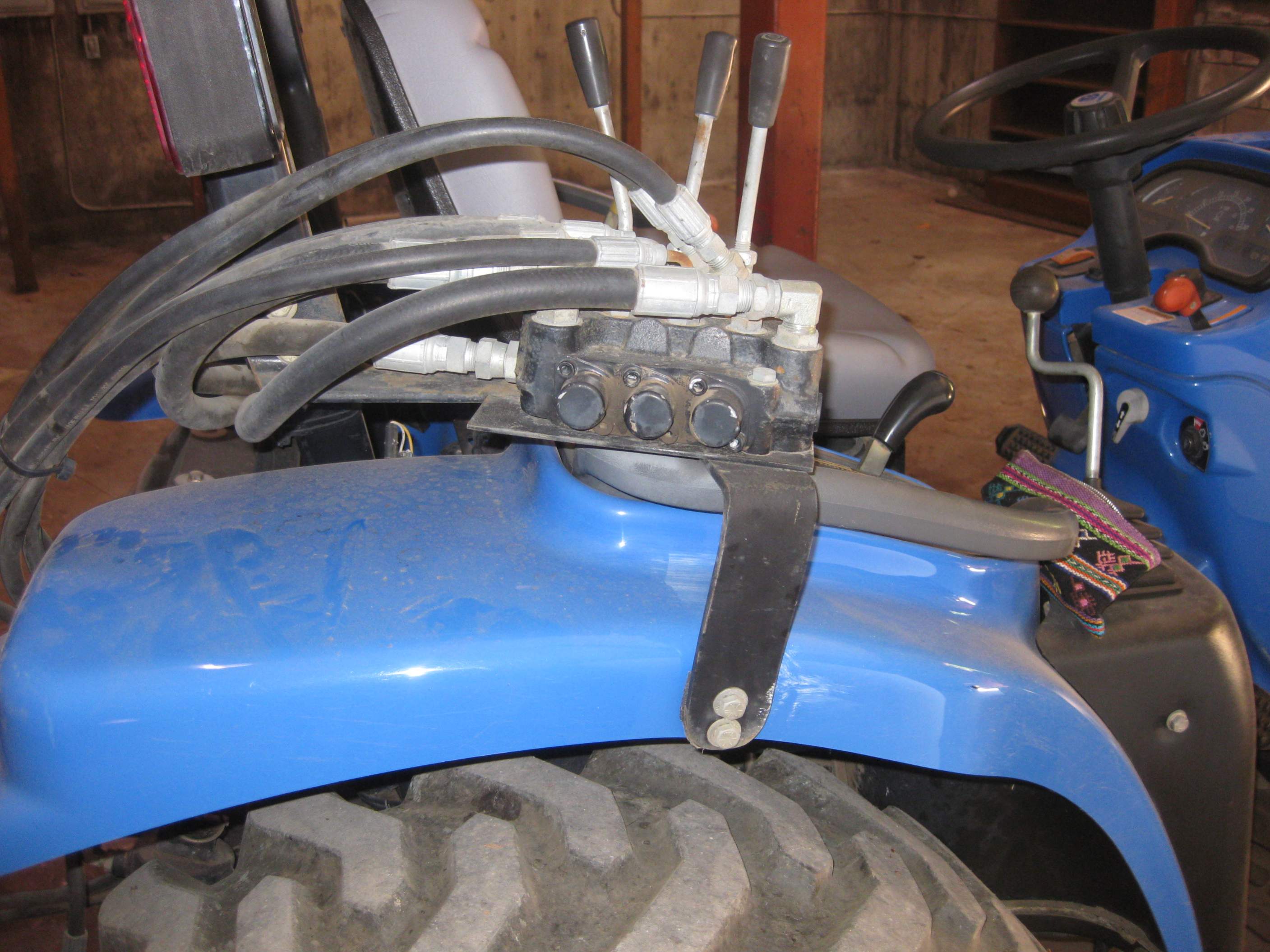

Hi All,
I just bought my first tractor and it came with what must be a top and tilt system that was added. The tractor has a gannon box scraper with a ripper and there are three levers on the right fender where I can control the tilt, inclination and ripper. Now, I want to remove the gannon and put on a rototiller. However, it looks like I'll need to do something with the hydralics to the ripper cylinder. There aren't any quick disconnects. Do I remove the lines and replace with some sort of caps? Will this be a messy job (any pressure on these while the tractor is turned off?) :confused:
Your help and advice is appreciated!

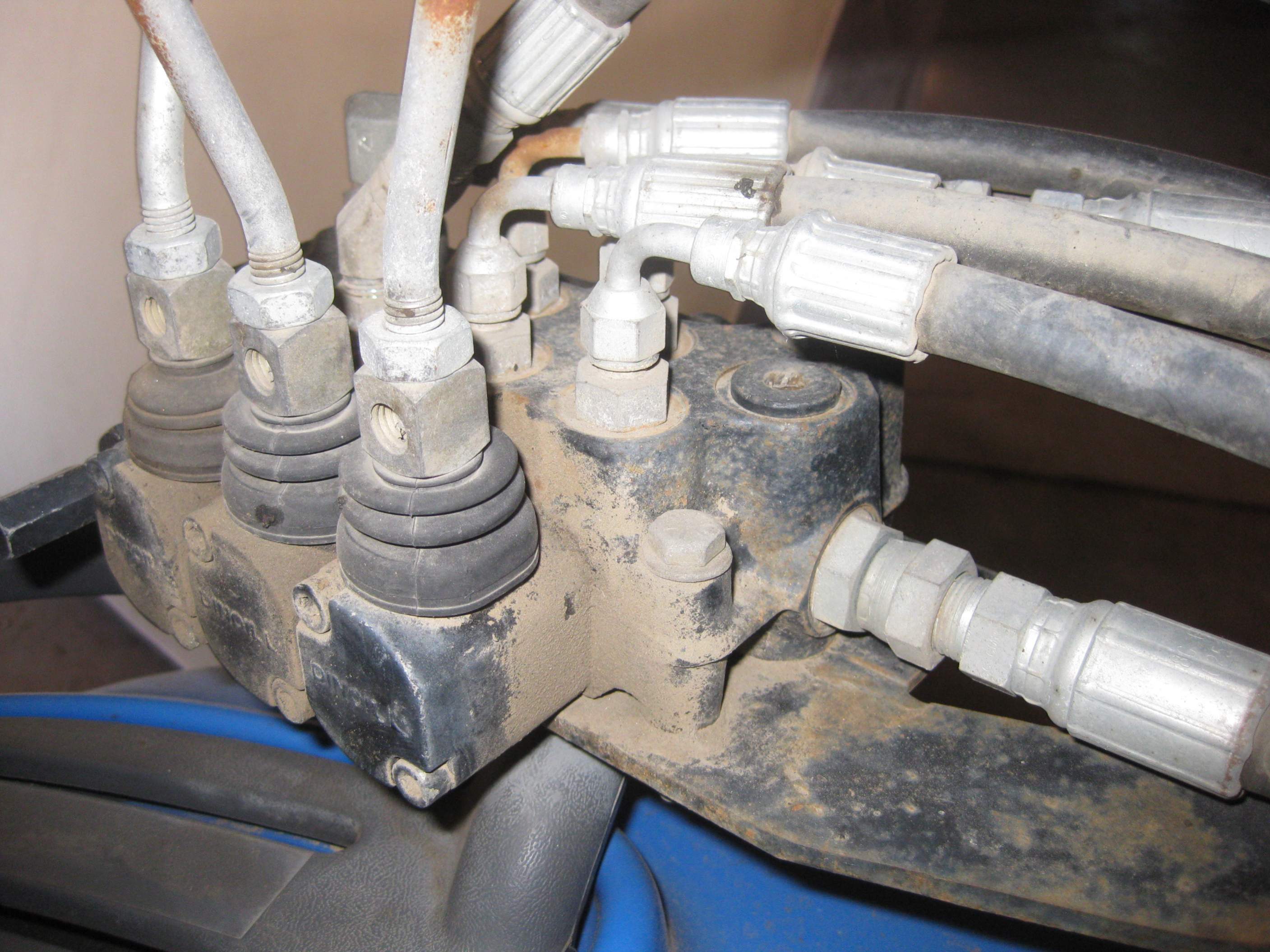

Took the photos today. It's the lever closest to the back of the tractor that I'll need to disconnect.

Plug the unused work ports or install QD's.
/ Extra Hydralic Lines When Switching Attachments
Thank you JJ. Are the QDs going to be a standard size? Not sure what to order.
#12
Thanks, JJ. Judging from the photos, can you tell if I'm looking at 1/2" or 3/8"?
/ Extra Hydralic Lines When Switching Attachments #13
Typically your work ports will be 1/2" pipe thread. Not sure what your hoses are, almost look like 3/8" JIC ends to me, but you should take either the hose or a fitting with you when you go to get the QD's if you don't actually know. 1/2" AG quick disconnects are what is std, but in your situation you may be able to use 3/8" and be better off room wise.
You may want to change those 45*s up front also. Get some long 90*s to put in there and then those hose's won't be pointing up in the air. Just a suggestion.
Good luck

QDs are very bulky. Mounting several on a valve may be prohibitive. You could mount them to the ends of short hoses permanently installed on the valve.

Larry, I think that he is only going to do the 2 hoses that get used for the rippers on his box blade. But yes, all 6 would be a problem and should have a separate mount for the QD's further towards the rear of the tractor.
