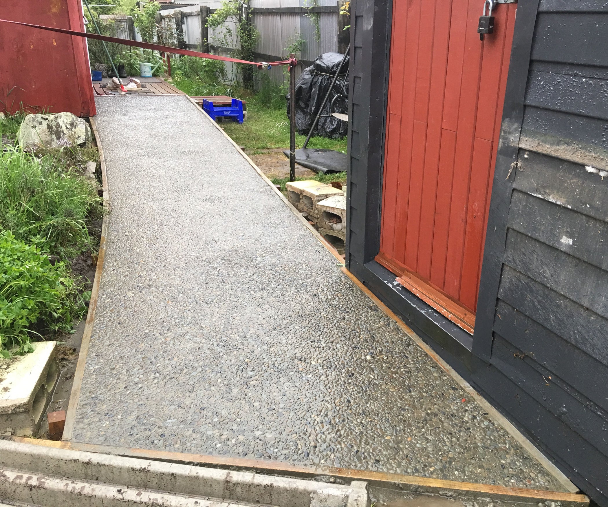

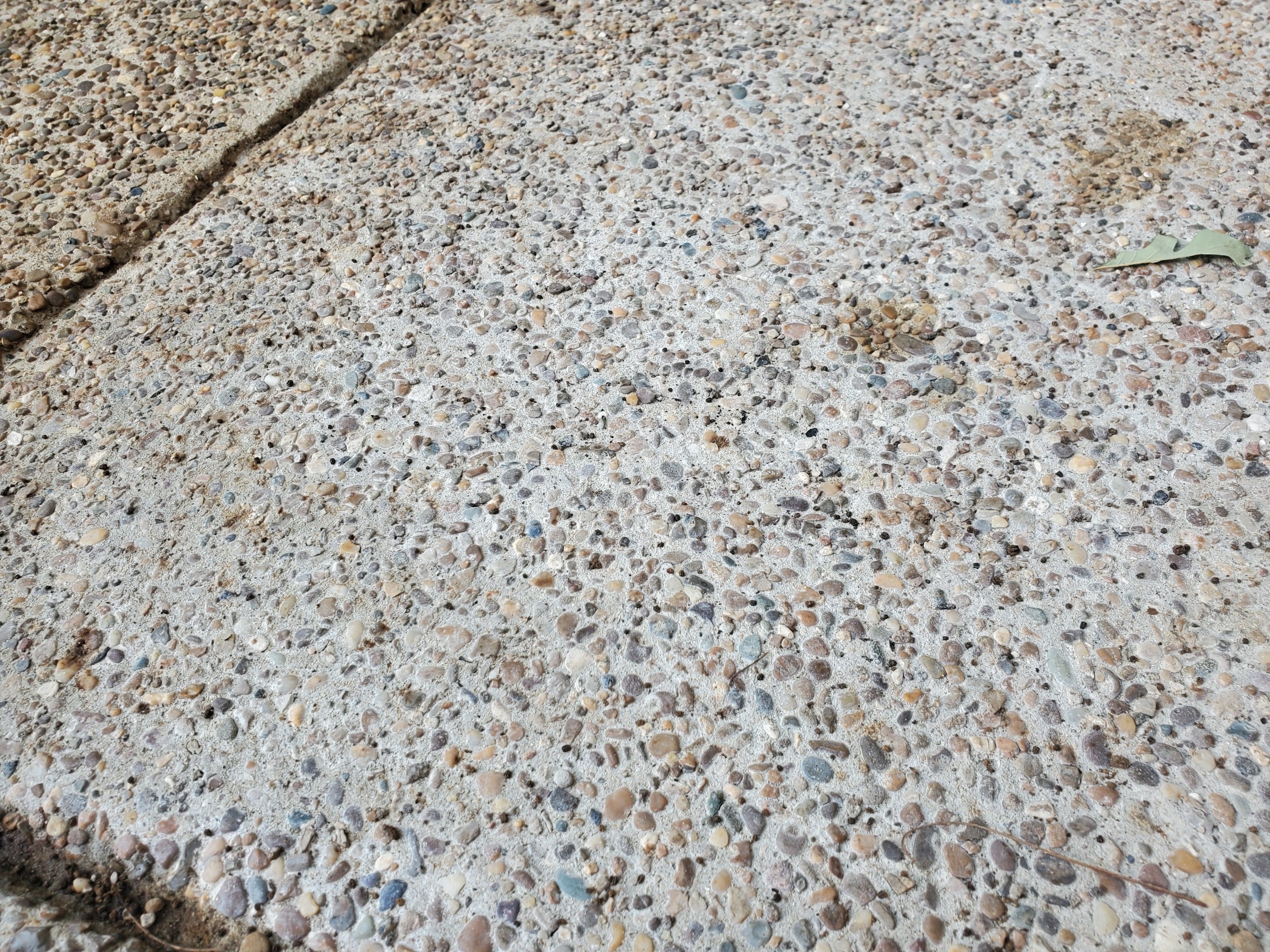

Tried it as well, the wire wheel leaves black/gray/silver metal color on the rocks, looks ugly.
Here is what i was expecting:
amanda1-1024x768-jpg.811057
Not this:
20230712_175002-jpg.811058

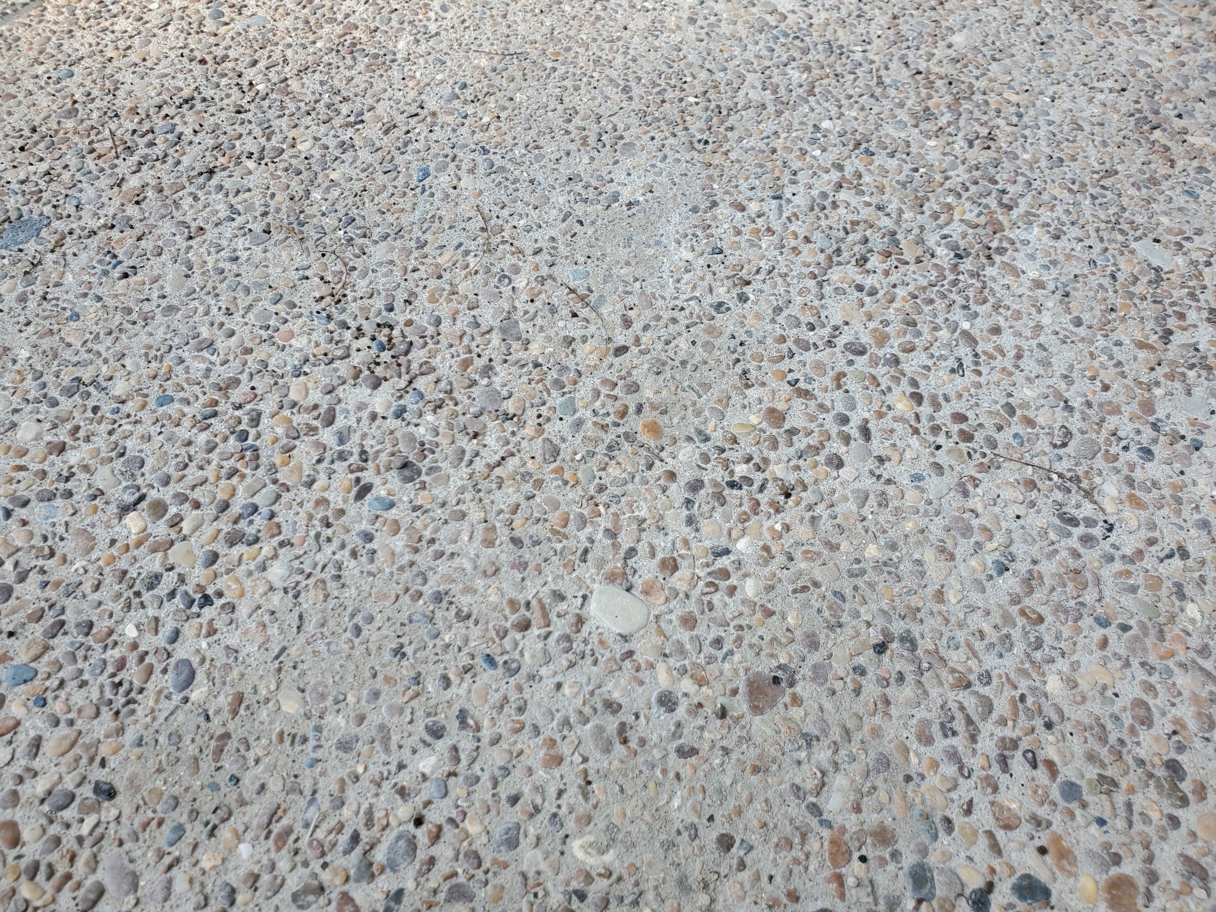

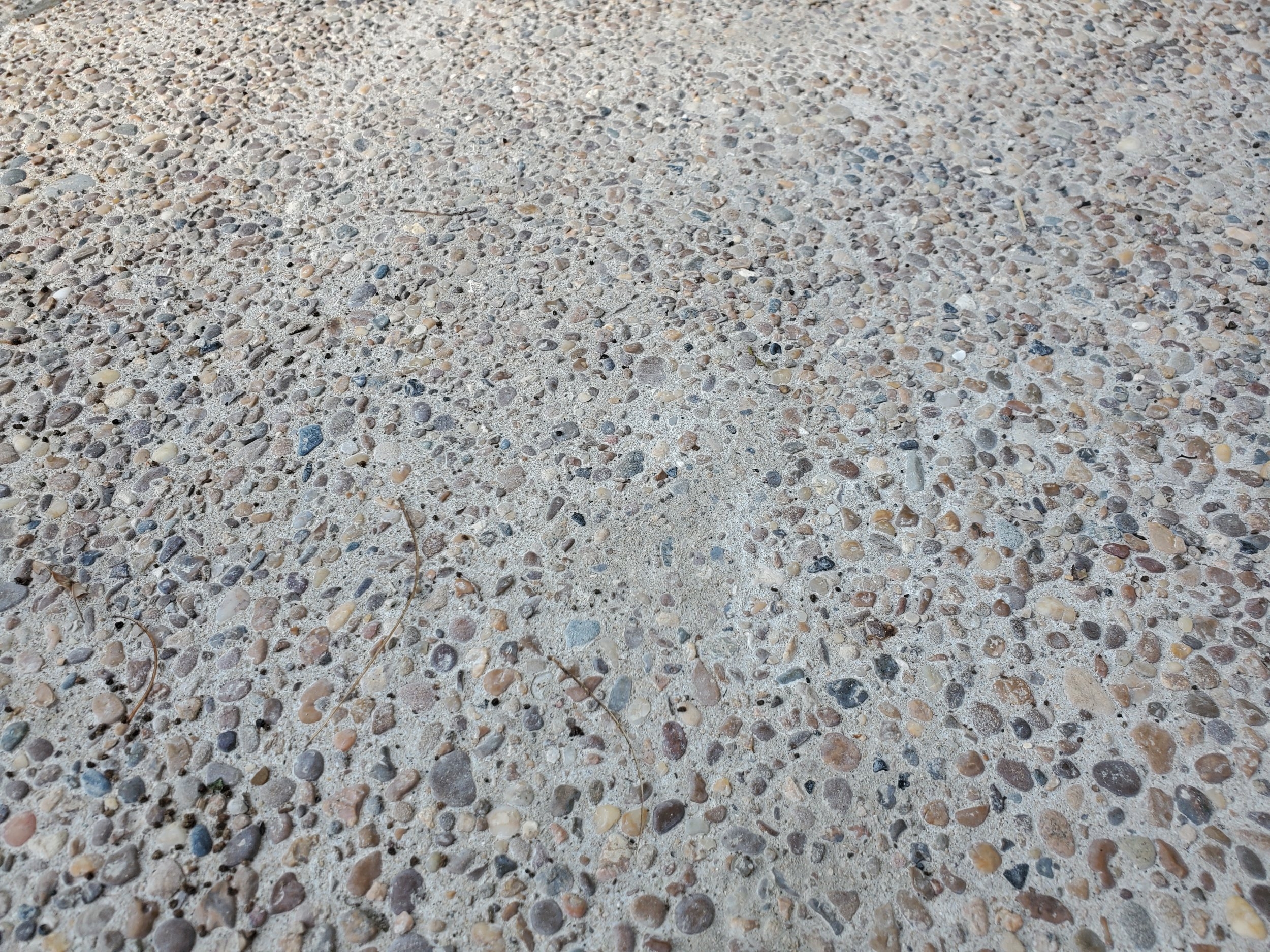

I'm not sure that is the same process. We did the exposed aggregate for the driveway in front of Mom & Dad's house years ago. Basic pour and wash off, I think. It was a long time ago. I think it ended up somewhat like the better patches of the second photo. Not patchy, although there may have been places that weren't perfectly flat. It was something that our family did together, so no contractor to complain about. It has weathered well over the years.
For the first photo, either they had a very high aggregate to sand mix (potentially making weak concrete), or as the concrete was setting, they added dry aggregate and rolled it into the surface. Anyway, whatever was done, it wasn't as simple pour and wash off.
Talking to your contractor before the job though, hopefully he actually understood different processes, but apparently not.
By now the concrete will likely be set pretty hard. So, perhaps sand blasting, soda blasting, or dry ice blasting. Perhaps there would be a way to make a test piece for your contractor to do a demo before you pay a bunch of money for something you won't be happy with.
