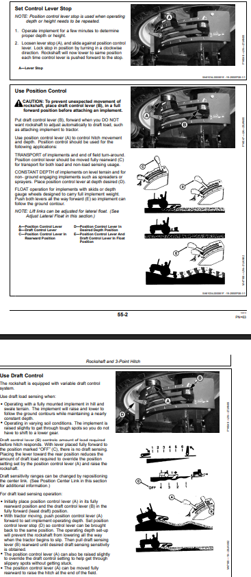

I suggest for you to read your tractors operators manual & follow the 3pt operating instructions that it states. My guess without reading your tractors OM is unless a ground engaging implement is attached to your tractors 3 pt hitch then lever in photo should remain in "off position".

/ explain rockshaft levers #9
Thank you Jim, confirming what I thought but didn't know for certain. Draft control for ground engaging attachment such as mold board plow. Will lift the attachment if ground conditions get tough by going too deep.

/ explain rockshaft levers #14
If you have draft control set in "off position" then set 3pt control lever so front of mower is at desired cutting height & have rear tailwheel set correctly one should be able to mow uneven terrain without having to touch 3 pt height control lever. The reason I posted excerpts from tractor operators concerning draft control is to show that ""no draft control is needed when using non ground engaging implement"" such as a mower.
