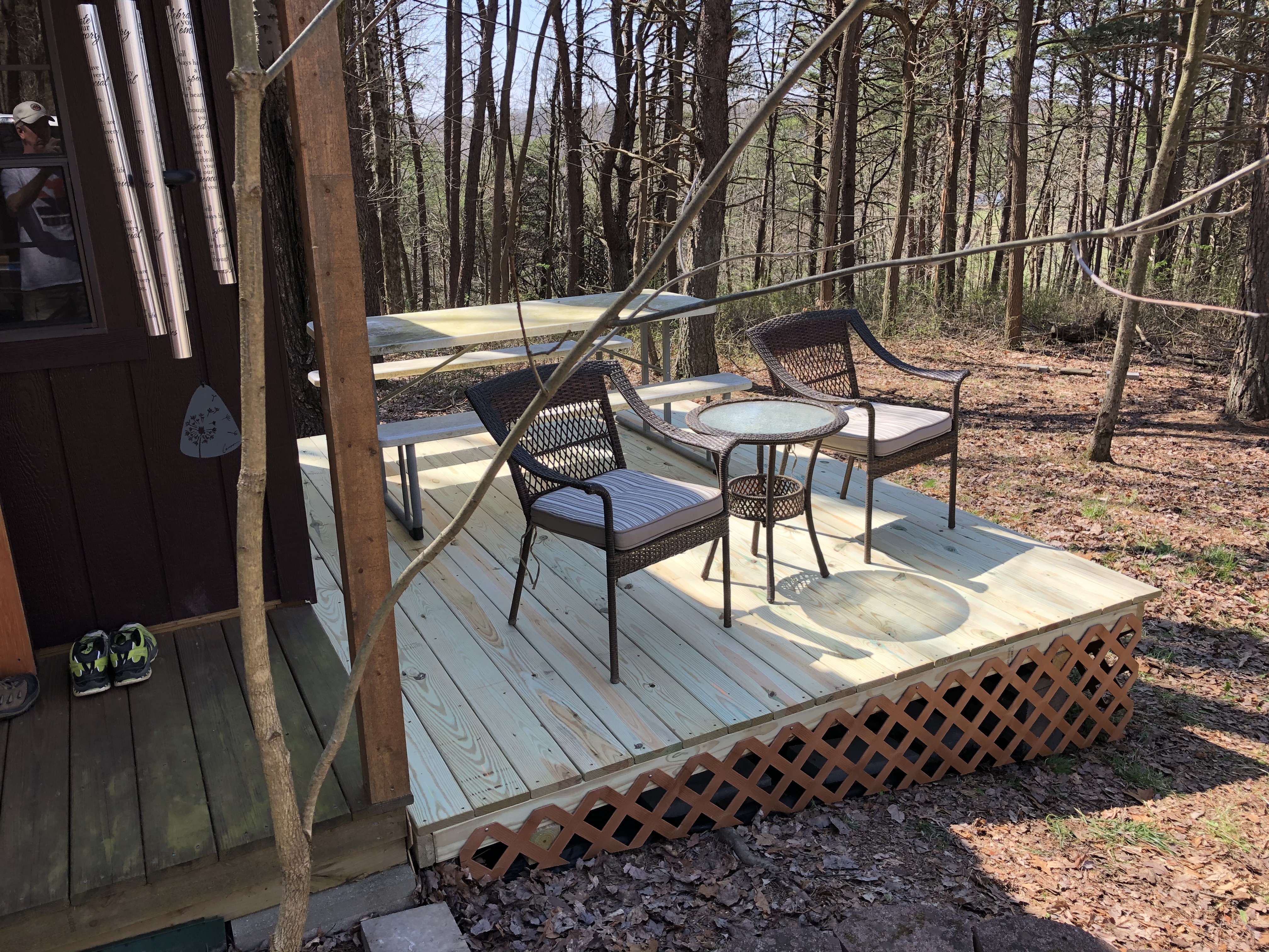

Ha, just realized I never updated this old thread, once I finally did get around to building the deck!
Very happy with the result, got it knocked out in a day....and it's even level! Nice small deck to watch the sun set over the next ridge. Will stain & seal once the wood dries out, latter this summer.
