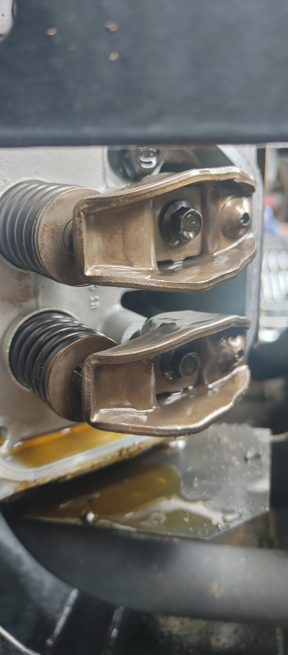

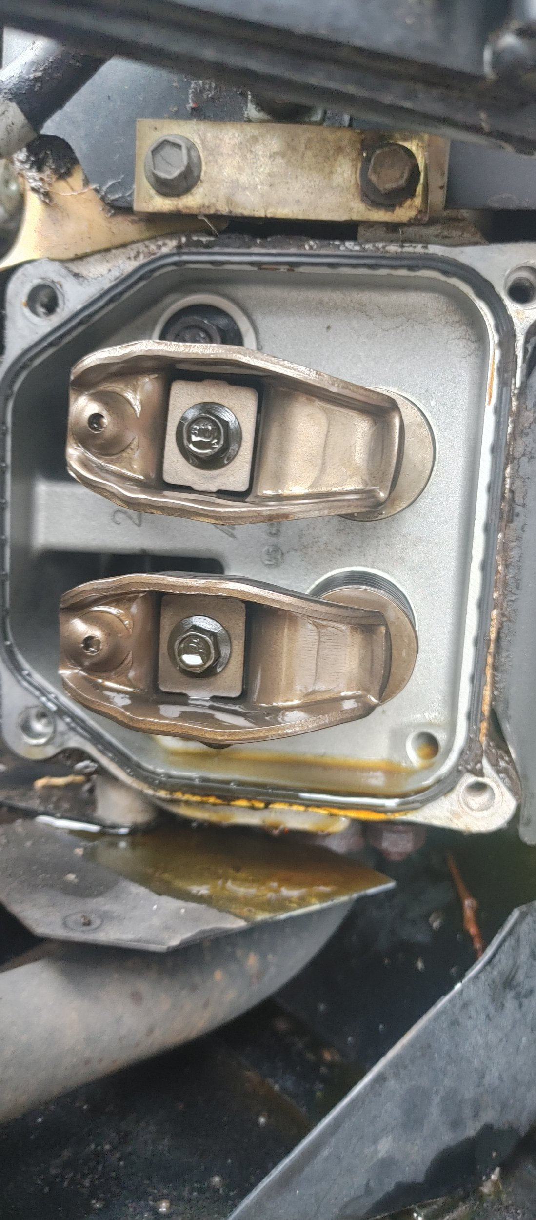

Yes, oil is full, and looks clean on the dipstick. Oil is only one full cutting on this oil change.
Actually got the engine to spin but it feels tight, and didn't fire.
Valvetrain looks great.

Just to update this, I got the mower fixed. What had it locked up was the clutch pulley on the crankshaft had locked up which kept the engine from spinning. A new pulley, and it's back to running like a top.
