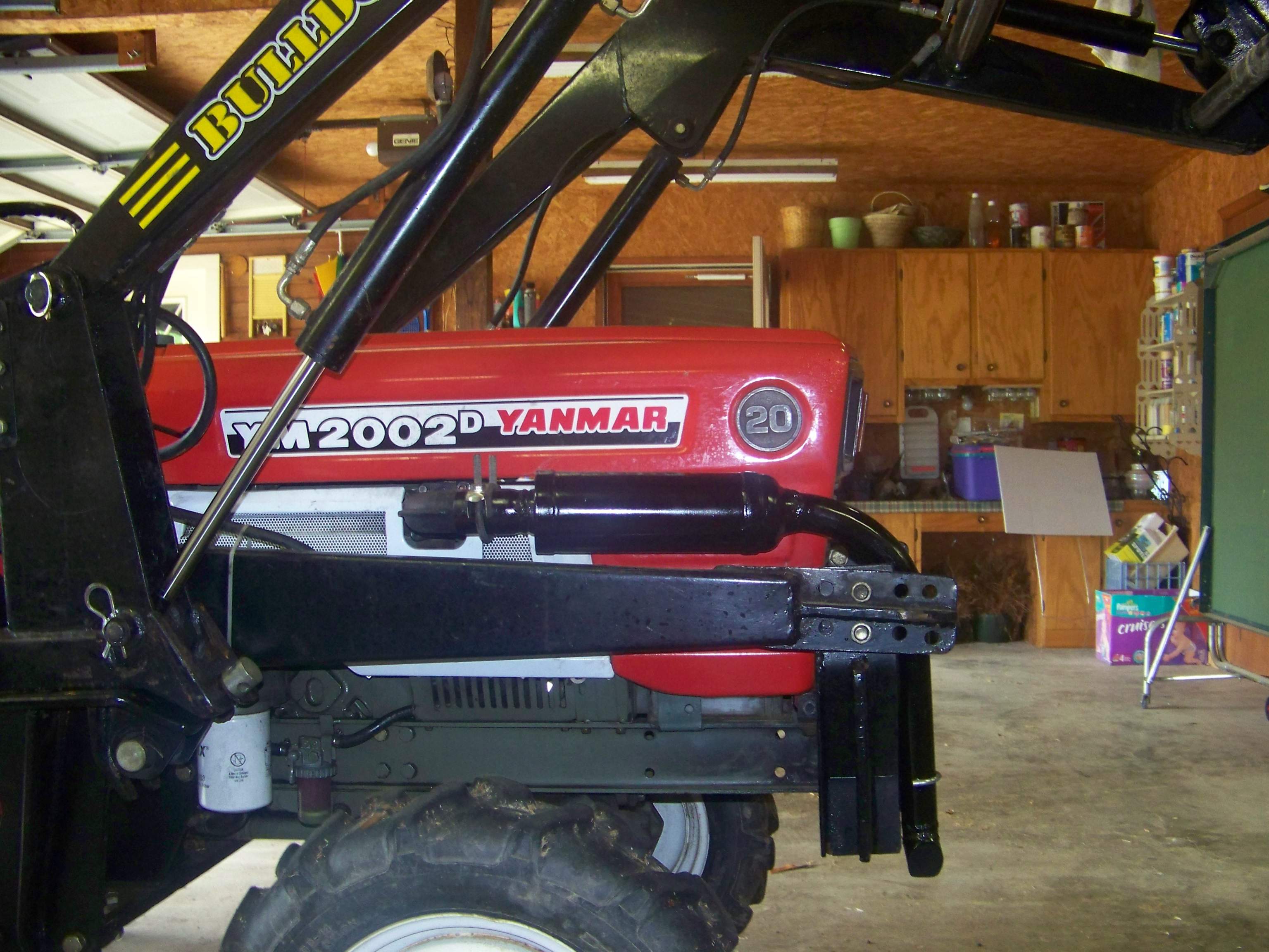

I had to turn mine down for orchard use and I don't notice exhaust much. Note the tip should be slightly down so water can't enter. But not very much down - I found that blew up dust that was worse than the exhaust. I took this picture before I rotated the elbow on the tip to make it nearly horizontal sideways.
In summary, I don't find horizontal to be a problem.

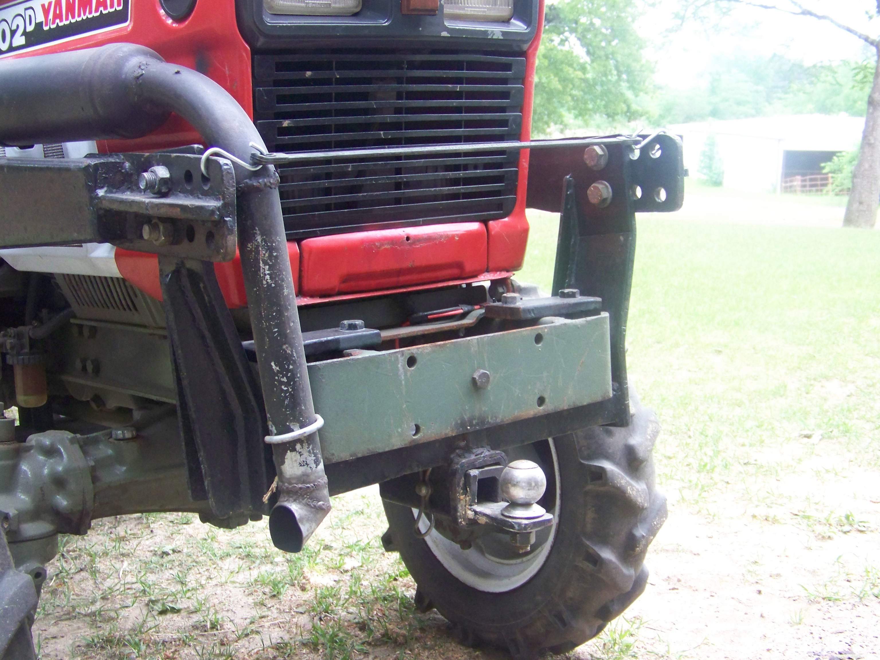

/ Exhaust Pipe #3
Mine is down and a short elbow to make it blow out and not down. Does not blow dirt or come back on you.

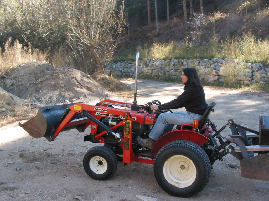

I'm another guy who can't stand diesels whose exhaust blows back in my face. Here's a picture of my wife on our YM165D.
I removed the factory pipe and slipped this short scrap of electrical conduit over the muffler outlet. With a hacksaw I slotted the bottom of the pipe so that a simple U-bolt would clamp it onto the muffler spigot. A close look at the picture shows the details. A trip to the auto parts store yielded the upper chrome piece. It ia a muffler tip, which in this case is used to help turn the splatter you get sometimes off to the side without restricting the exhaust gases from being mostly shot straight up vertical. The whole point of a vertical stack is turned to blow the fumes high into the air.
