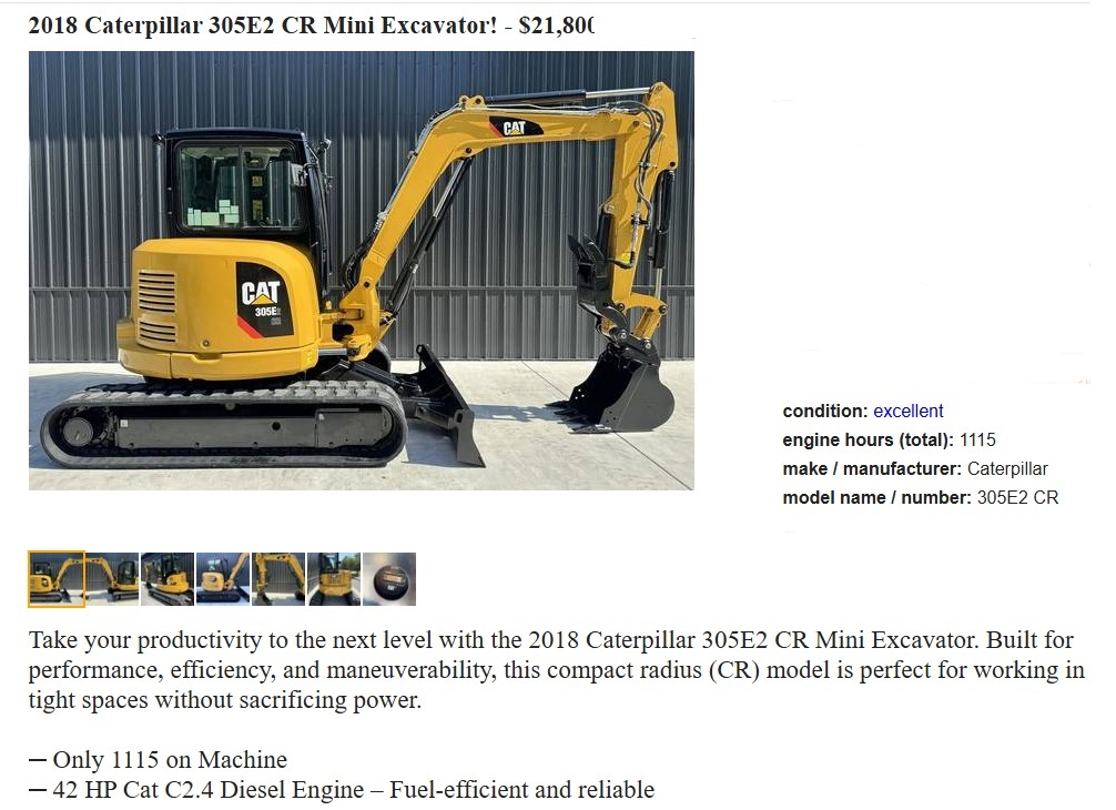

Retirement is scheduled for 2025. soooo I have had the bug to get an excavator for some time. Rented one to do some work around my 2 acre pond years ago. I have a specific project to start with it. Its a wooded strip about 170 ft long and about 40 ft wide. Most trees in it are under say 20 inches wide, mostly pine. A few are well over 30 inches but I could leave them there as they are right on the property line anyway. My goal is to turn that wooded strip into a parking area for our U-pick customers.
Second project would be to remove some smaller pines/hardwoods that have started growing beside the ponds edge.
I found one (see pic below) and it looks like it might do most of what I needed to do. If I had to cut some trees down, saw them in half and then take an EX to move them to the disposal area I would.
Price is in the ballpark of what I could afford. Especially if I decided to sell it when I have run out of ideas what to do with it.
According to the specs (see richiecpes below), it says it has a lifting capability of a little over 5K#.
It looks like from what I can understand about green timber/trees a 20" pine would weigh about 3k# . Well under the capabilities of the one below. The particular one listed shows as having a 6 month warranty. Asking price just under $22k + delivery.
i had checked into renting a bigger EZ at about $6k a week +$700 delivery.
What'cha think underpowered? I'm not too concerned about it taking longer with a smaller piece of equipment.

I think you’ve picked a good size for your described uses , 5-6ton should take those stumps out well. I’ve got a EC60e Volvo that I mainly use for taking out cherry tree stumps, mostly in the 10-15” range but a fair number up in the 20-24” range. I’ve taken out in excess of 2000 stumps in the 7 years I’ve owned it. Perfect size for my uses and one of the most used pieces of equipment I own, would buy again in a heartbeat.
That being said something doesn’t add up with the cat 305 you found for sale. I don’t think there’s any way that machine pictured with it only having 1100hrs can be for sale at 22k. It’s more of a ball park 50k machine. Let us know what you find out.

I think you willl find the little cat on the light side. Most farmers I know that have diggers have a few kilometers of drains to do, and they are in the 10 - 14 ton range , partly to get the reach, and partly because there are more of them on the 2nd hand market..
That said, if you have a single leg pick made up to remove stumps, you will greatly improve what you can do. I used to do stumping on peat, with a 20 ton digger and I prefer a single shank/leg pick over a 2 shank/leg pick.
The stumps ranged up to 20 ton digger foot print size, and the pick made easy work of breaking roots off the stump, then removing it.

A 305 will dig stumps but it’s going to be slow going for stumps that size. A 305 is a touch bigger than my 40 but I’d definitely use my 120 for that job.

The 305. is a good size for your scope and use - yes the 20" plus stumps will take a bit longer, but a ripper tooth is good for ripping the roots and not making a huge mess or larger hole than necessary,
I concur with 7Gables - the 305 listed w/1100 hrs minimum is $35K on the low end and $50K high side.
There are other similar good 12K machines out there - Takeuchi 260 is a very good machine or Bobcat E55 - most of which are $35-50K range depending on hours and condition, cab or none etc,

Have you contacted that seller? I have doubts about the legitimacy of buying that machine for $21k. That’s probably a 50k machine unless the hours are 5 digits.

You better not send them a deposit to hold that machine, You just may lose that deposit. The machine you posted will cost more than 22K... My 2018 Takeuchi TB 235 was 25K

Indeed its not legit. It was advertised in my area. I sent them an email to go look at it and they said its in MT. Another big flag. I poked around craigslist and found probably a 8-9 listings for similar equipment, same MO. I had read about a company posing as a larger legit company getting deposits and they don't exist. I won't be any part of that.
I am more interested in what size machine would work. With more time on my hands I can devote more time to digging a tree out by the roots and dropping it. Yeah it would be faster to pluck it but more costly, I;m thinking anyway.
The little new chinese $6k machines I am not interested in. Read many reviews and not looking for something I have to work on a lot.
Thanks for the input. I am watching for a good machine I can go look at test it before any money changes hands.

Yea, certainly a scam. If your in the market, you will get good at spotting them. The pictures, the way the ad is written, price, etc. Over use of characters in the title (like the exclamation point) and the copy and paste from a brochure....you will get it.
