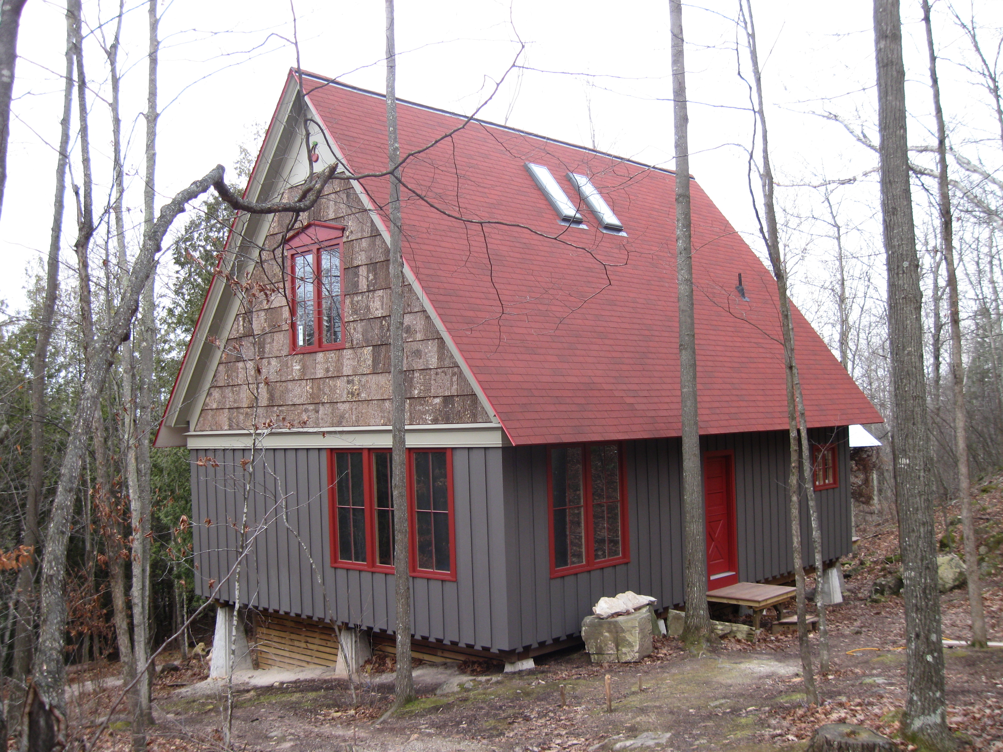

Absolutely correct. One of the reason why we want to put it close to the house is that we are planning on putting a covered wood porch over it. This will help keep the rain water out of the hole, but eventually it will fill with ground water. A daylight drain would be ideal, but we'd have to trench under the house. Instead, I'm planning on creating a open sump of some size and then putting a submersible pump in it.

This is the side of the house where the tank is currently (it was set after the photo was taken). The master plan is that the red door with the stoop (but no steps) will be into a screened porch area. The tank would be placed in the hole below the porch.
