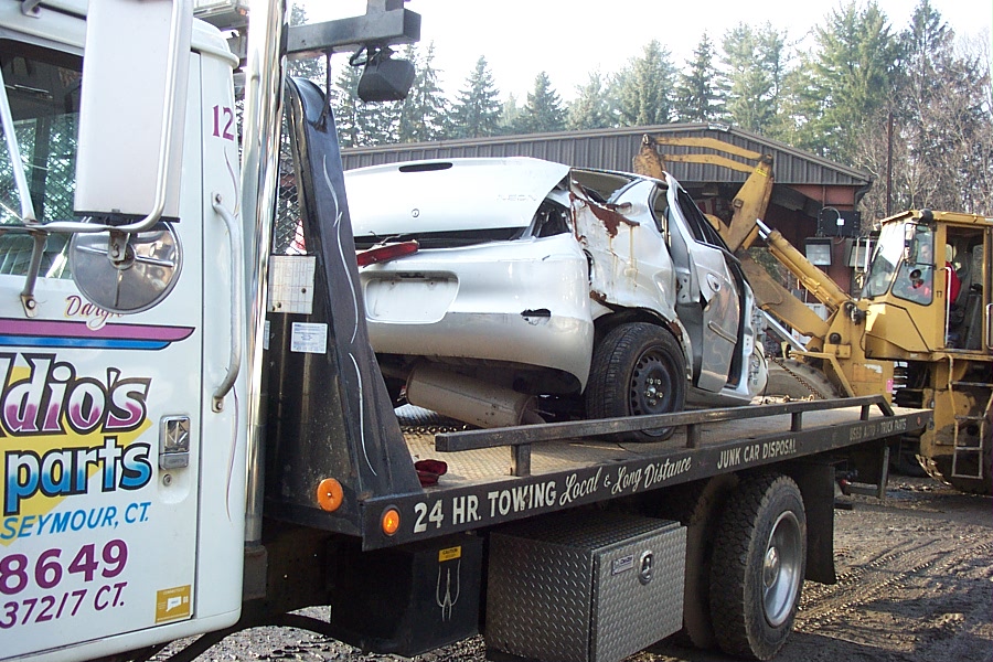

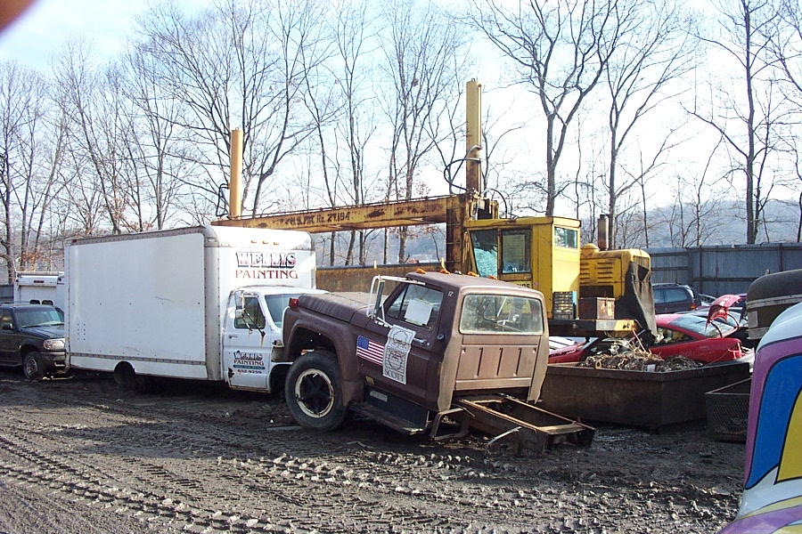

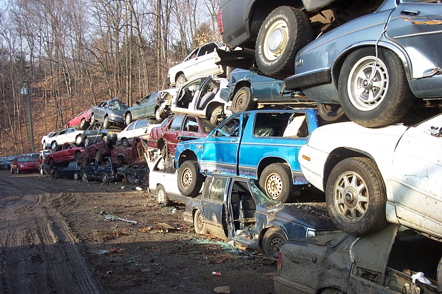

Afternoon Bill,
Well partner Im in semi retirement these days but Ill give you an inside view of my office 3 days a week ! ;) :)
BTW, theres nothin like the smell of diesel in the mornin ! ;)
Oh yea, almost forgot to mention, Ive got dual chrome stacks on my rig ! :)
Sure beats lookin at 4 walls ! ;)
Looks like a lot of fun Scotty, but I think you got some more 'splainin' to do. A new venture for you? Kind of the other end of "restored", eh?

Evenin Rob,
Yea, definitely the other end of restored ! ;) One big problem with this job is that everywhere you look you can find something interesting that would be a great restore, old trucks etc ... the list is just endless ! You just need to excersize the right amount of restraint ! :)
