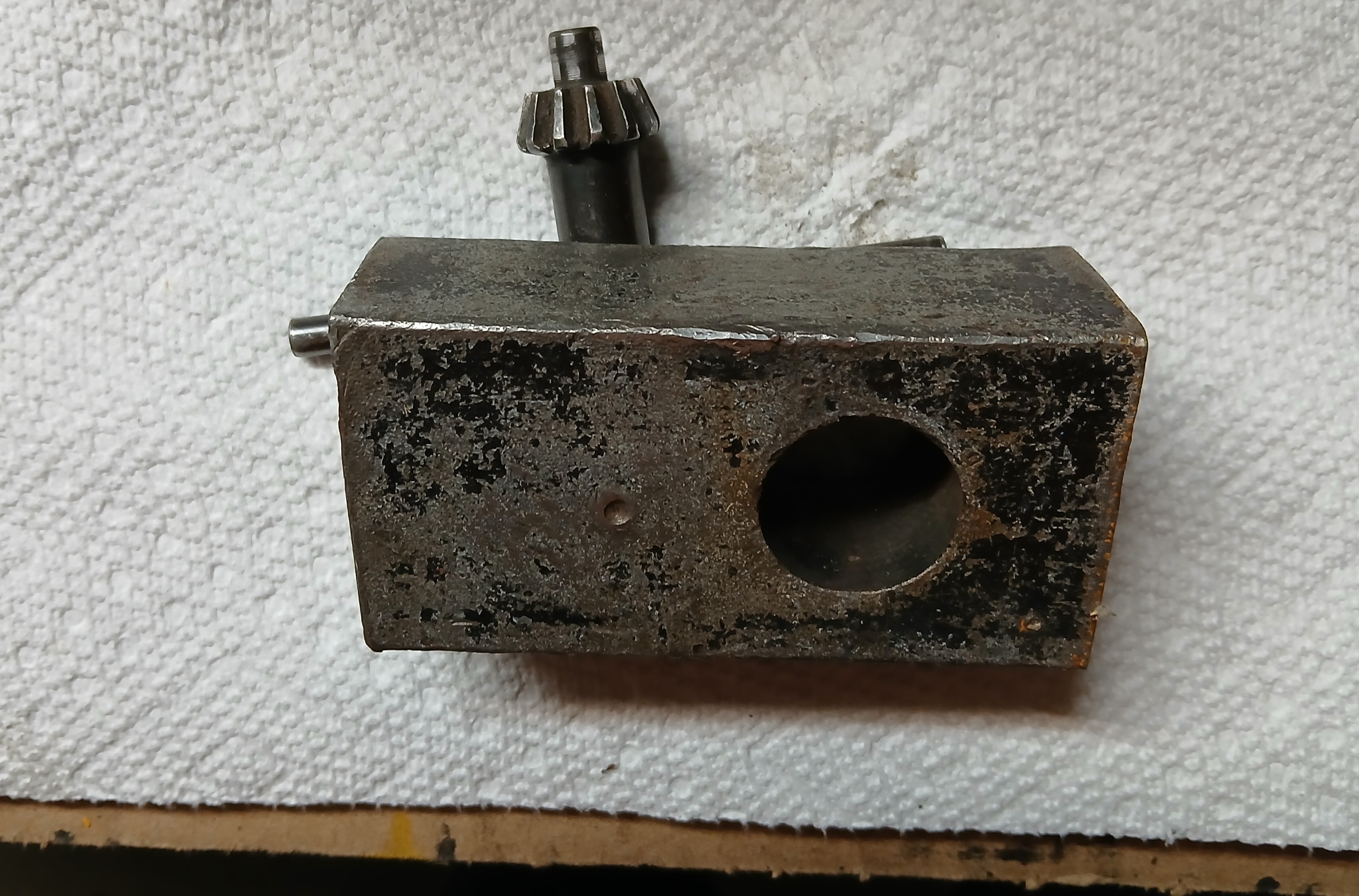

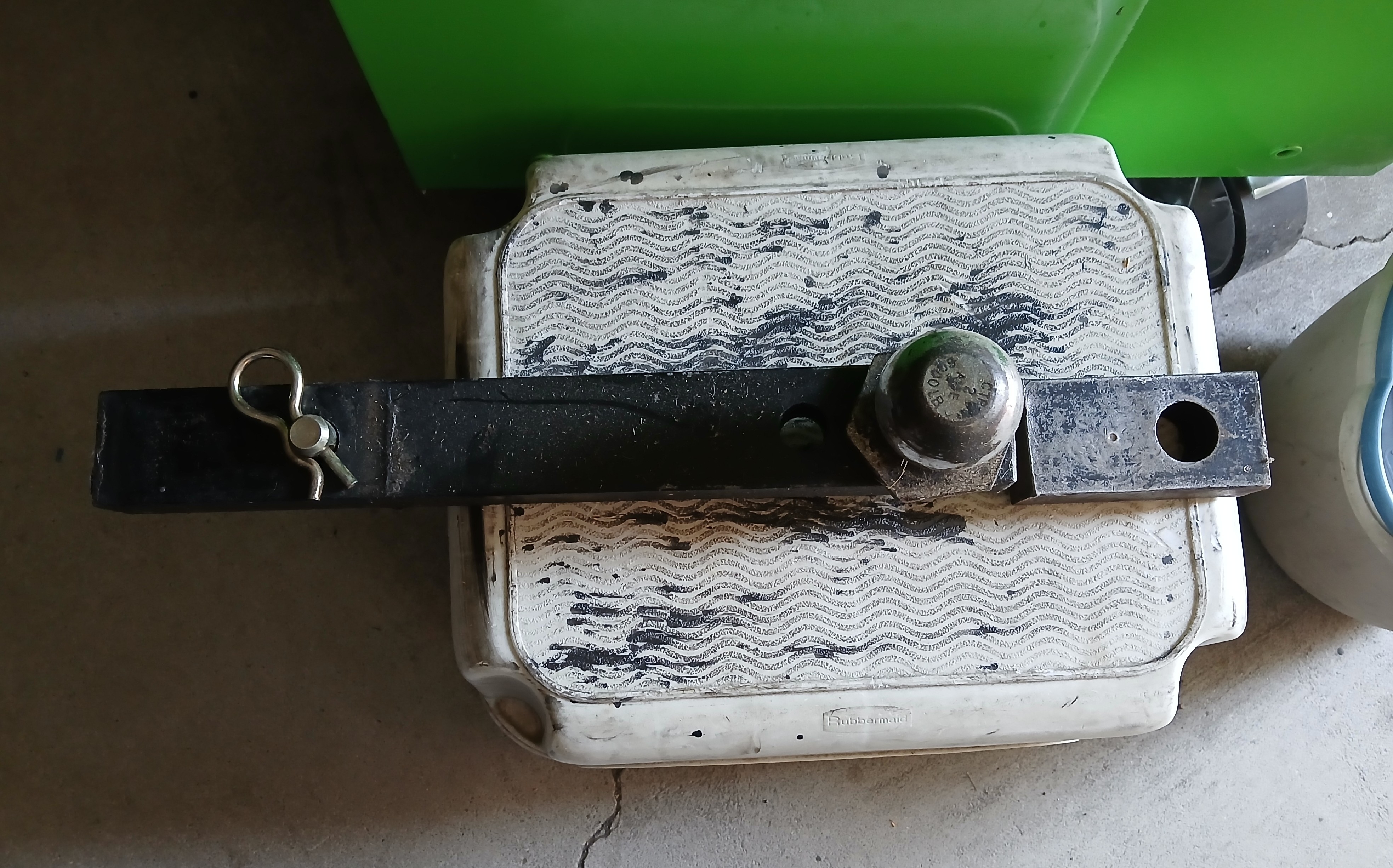

I can measure my EX2900. It is 1.25" x 2" x 19"'
I cut off 4" of mine but total length uncut is 19".
Ball hole is 1" and lock pin hole is 3/4".
Thank you Dennis!
