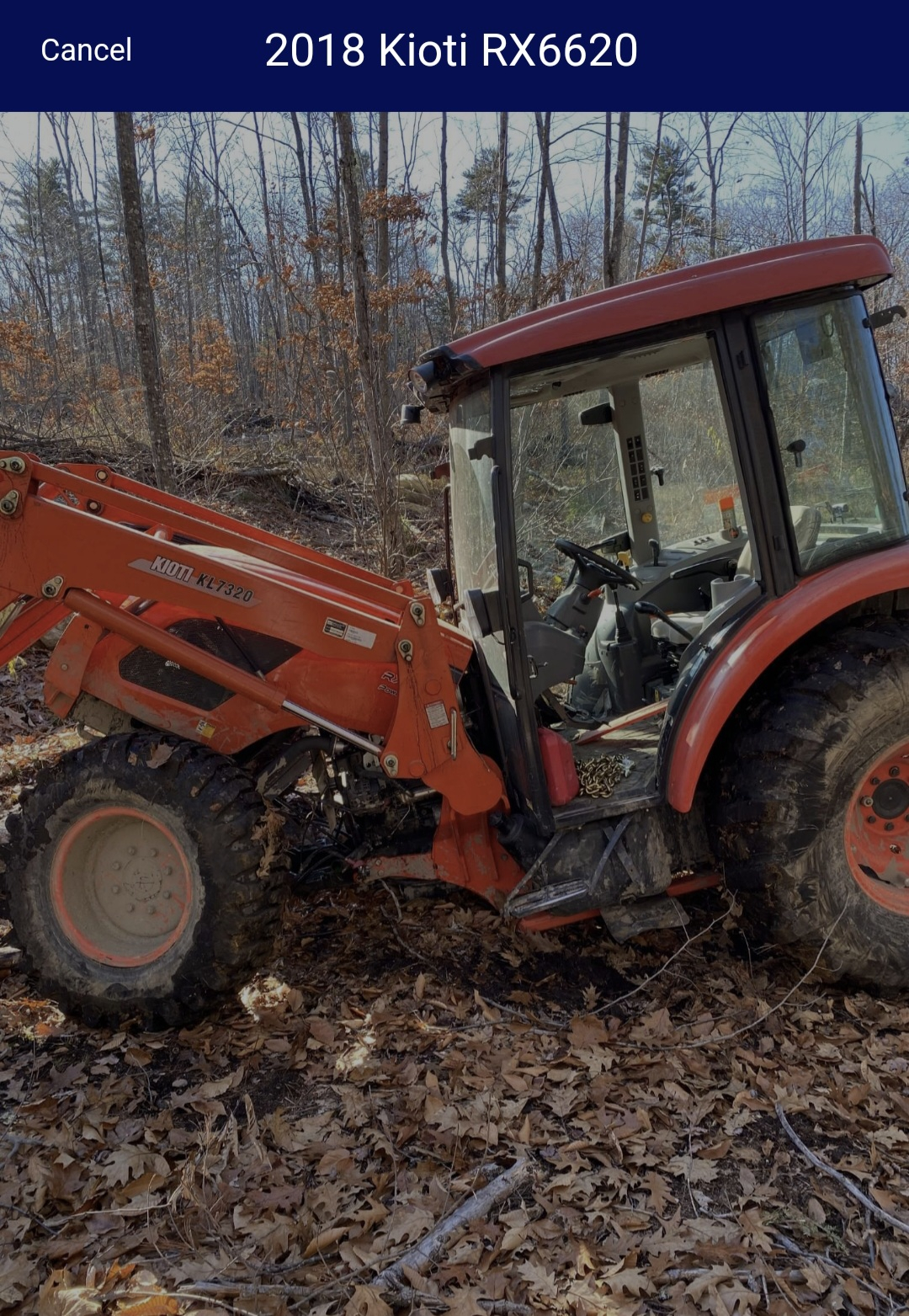

   / Ever see a tractor crack in half? #17
Simply put, using a backhoe as counterweight for a loader puts too much stress on the equipment. Something needs to let go.
Take smaller bites or buy a bigger machine.

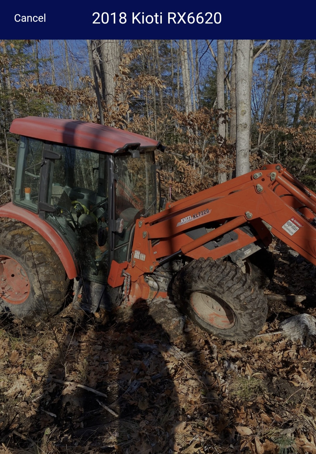

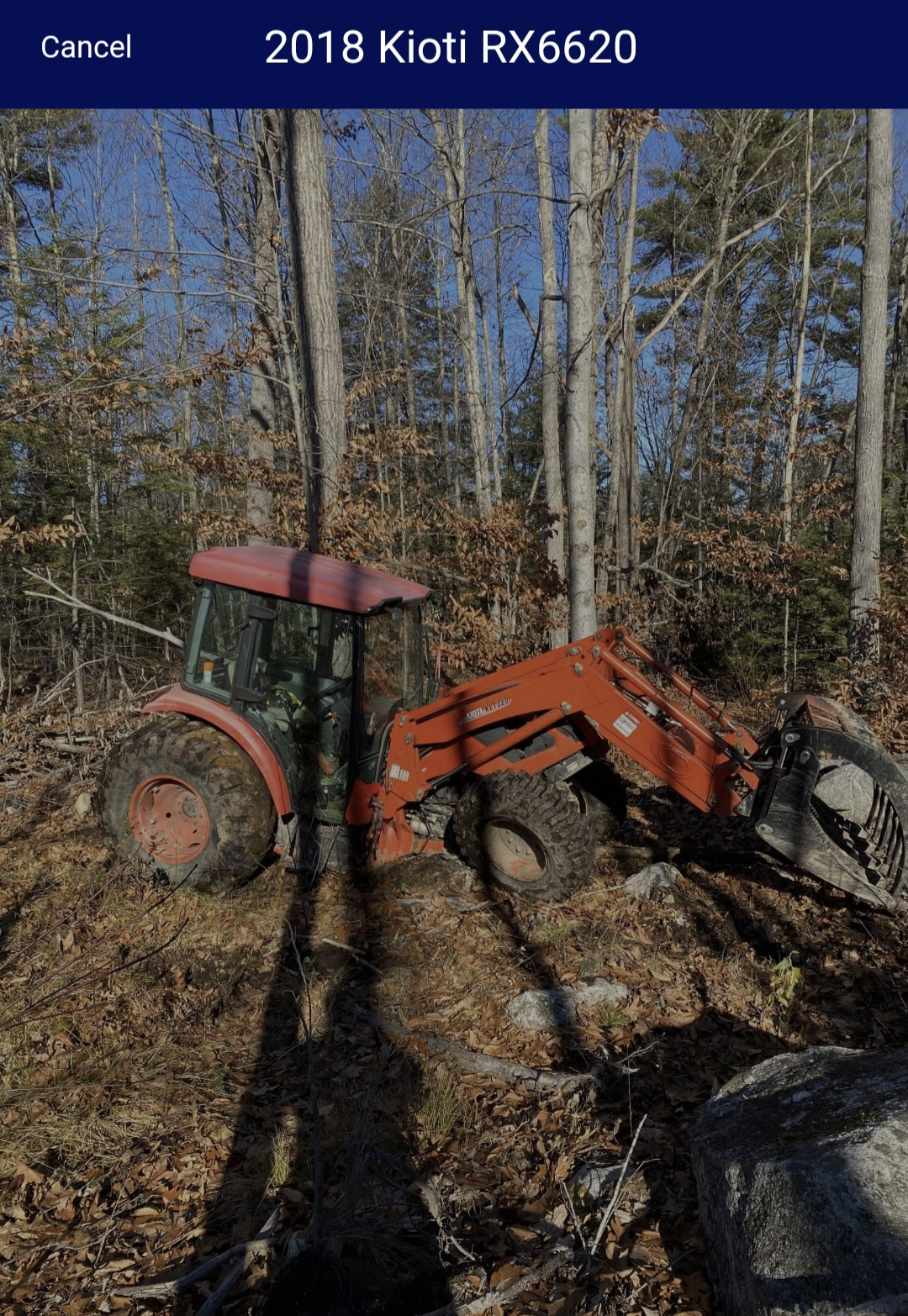

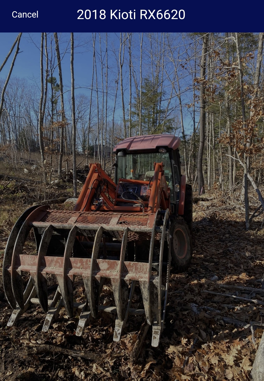

I saved these pictures from a local For Sale ad a few years ago. "For parts or repair." Not sure if it ever sold, his asking price was high if I remember correctly, around $30k. Ridiculous. In my opinion, looks like the owner was pounding his tractor over some rough terrain with a grapple that was probably too large for the FEL.
