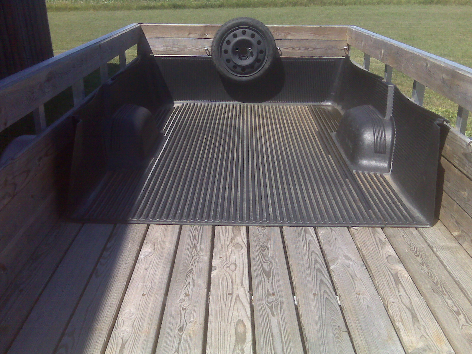

Reading this thread made me remember the liner I purchased at a Goodwill store last year for my 6X12 aluminum utility trailer, the brand is a PendaLiner and it was made for a full size 8 foot box Ford truck. I would LOVE to find a second one that matches this so I could have a full length liner (by installing the second one backwards) for my trailer. ESPECIALLY if I could find one for the TEN BUCKS this one was priced at. The store wanted to get rid of it and I was so happy to help....:laughing:
