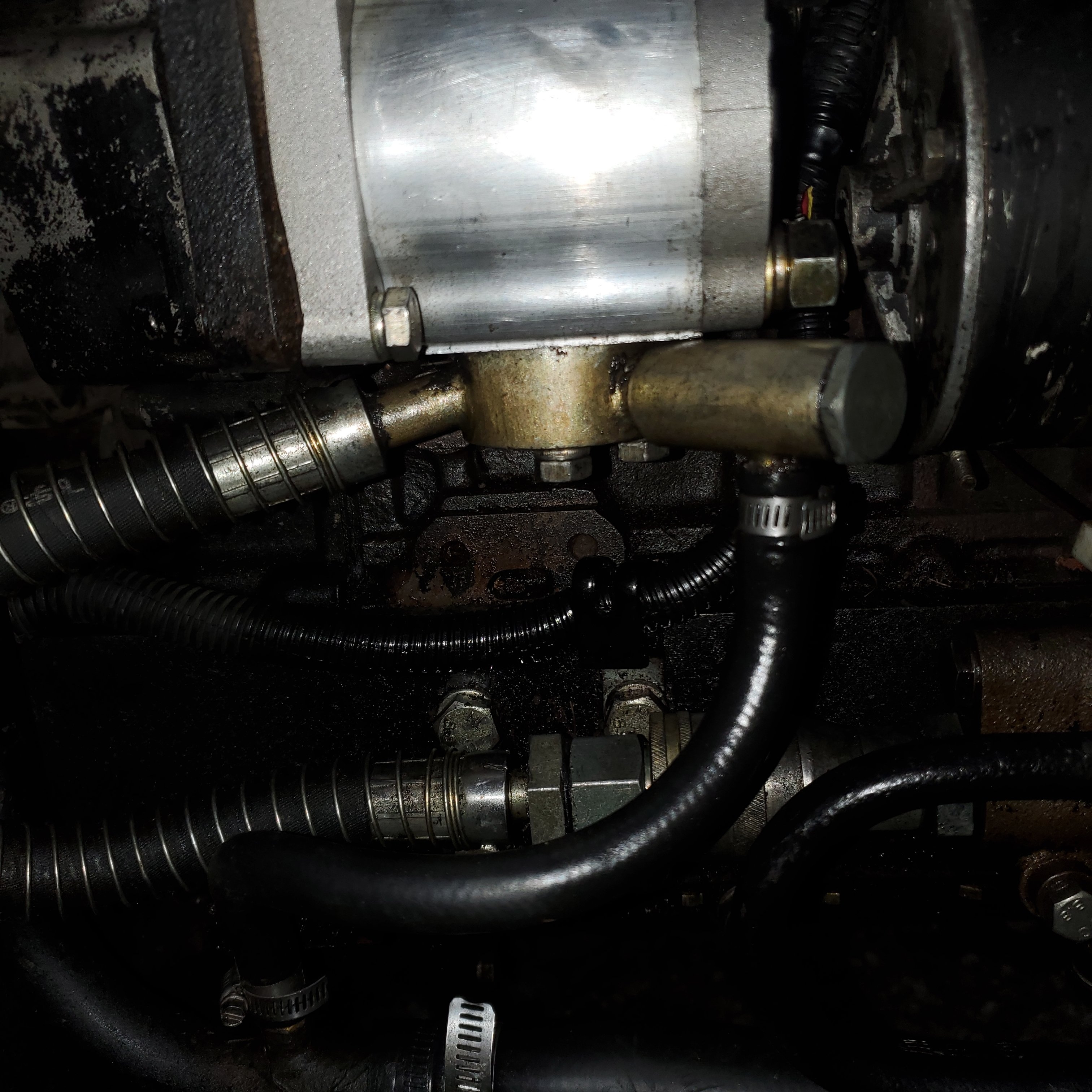

Hello and thank you for your reply. When you say inlet do you mean the suction side of the pump going from the filter/reservoir to the pump with a rubber hose and 2 hose clamps? Or the pressure side going to the distribution manifold which I believe holds the pressure relief valve?
/ Erratic and jerky hydraulics
This pic is from the pressure side and has a smaller hose?
/ Erratic and jerky hydraulics #11
Suction side with hose clamps is where air can be drawn in. Check to see if the hose has hardened or cracked with age. Also check to see if soft and spongy from age. make sure clamps are tight.
