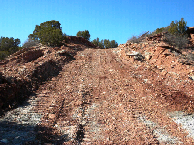

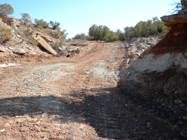

We have a path that goes through a wash. The path is located where it is because the water flow had created a natural path to start with and over the years it has been smoothed and widened by various people and machines. No matter what has been done so far, when we get big rains, it erodes again and becomes nearly unpassable. Obviously this is happening because the path was built where the water naturally flows.
At the present time, we just had it cleared and leveled again and would like to know if anyone has any ideas on what we can do to try to keep it in better shape when it rains again.
This is in Texas, near the panhandle.

It looks to be right in the creek/run off channel coming off big hill. So without building road up and installing culvert so water can go under road,I dont see it stopping. Can slow water down by installing diversion ditch higher up and putting rocks in but its really hard to tell were water is exactly coming from and how much is coming down to try and get slowed down or turned....

To me looks like in second picture the water is coming down beside big rock on left,cutting across the road but im sure without ditches and the build up on sides water running down road also. Just a guess,on my part...
/ Erosion Help Needed #6
Its hard to tell by the photos, but it looks like you need some kind of ditch that runs along side the road, but then you need a place to outlet the water from the ditch.

I think a ditch or 2 would help as well. We are in the process of buying a tractor so we will have something available to move some dirt ourselves. In the past to smooth it back out meant hiring a dozer so we didn't fix it as often as we probably should have
When we get the tractor I can work on adding some type of ditches to keep the water to the side. I'm not too worried about the bottom since it has water there most times and doesn't create much of a problem for crossing.

I would have to say a culvert in the bottom right where the bottom is, then bury it, building up the road so you have drainage off the two edges that drain towards the culvert, and under the road.
/ Erosion Help Needed #9
A series of dikes/dams about 4" tall at a slight angle across the width will direct the water to the sides. Every other dike angled in the opposite direction diverts half the water to each side.

Wow, holy crap... :p So again how much is concrete? :D Is this the only bad section or is it just one of them? Water needs to be removed from the roadway fast. If the ditches erode, it's not that bad of a problem. Where you drive needs to be good and dry.
I've done both, high center to drain to both sides and a gradual slope to drain from one side to the other. I've used diverters (humps and valleys) to direct water to the sides and ditches.

This normally happens most of the way up one side and mainly in the lower half of the other.
In the past when we have had it cleared the result was whatever the dozer guy wanted to do (no direction from us on slope, etc) but now that we will have a tractor we will try sloping to one side and adding some dips and diversions. At least it should make it last a little longer. With the advice here, I do understand that slowing the water is really the key so that's what we will shoot for.
