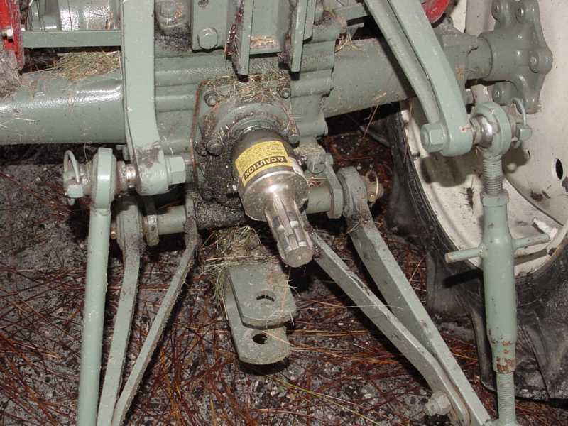

/ Equipment King Inc. #28
Here's a picture of an overrun clutch installed on the PTO of 1500D

/ Equipment King Inc. #29
This guy told me it was a mistake the first time. And now he relists the same tractor and calls it LIVE PTO again. Of course every grey market he auctions he lists it as Live PTO. Now it looks intentional.
/ Equipment King Inc. #31
I sent him an email explaining that no grey market Yanmar has a live PTO. He said it was from a previous post and he "forgot" to remove the live PTO part.
