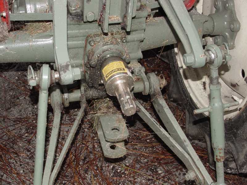

/ Equipment King Inc. #28
Here's a picture of an overrun clutch installed on the PTO of 1500D
