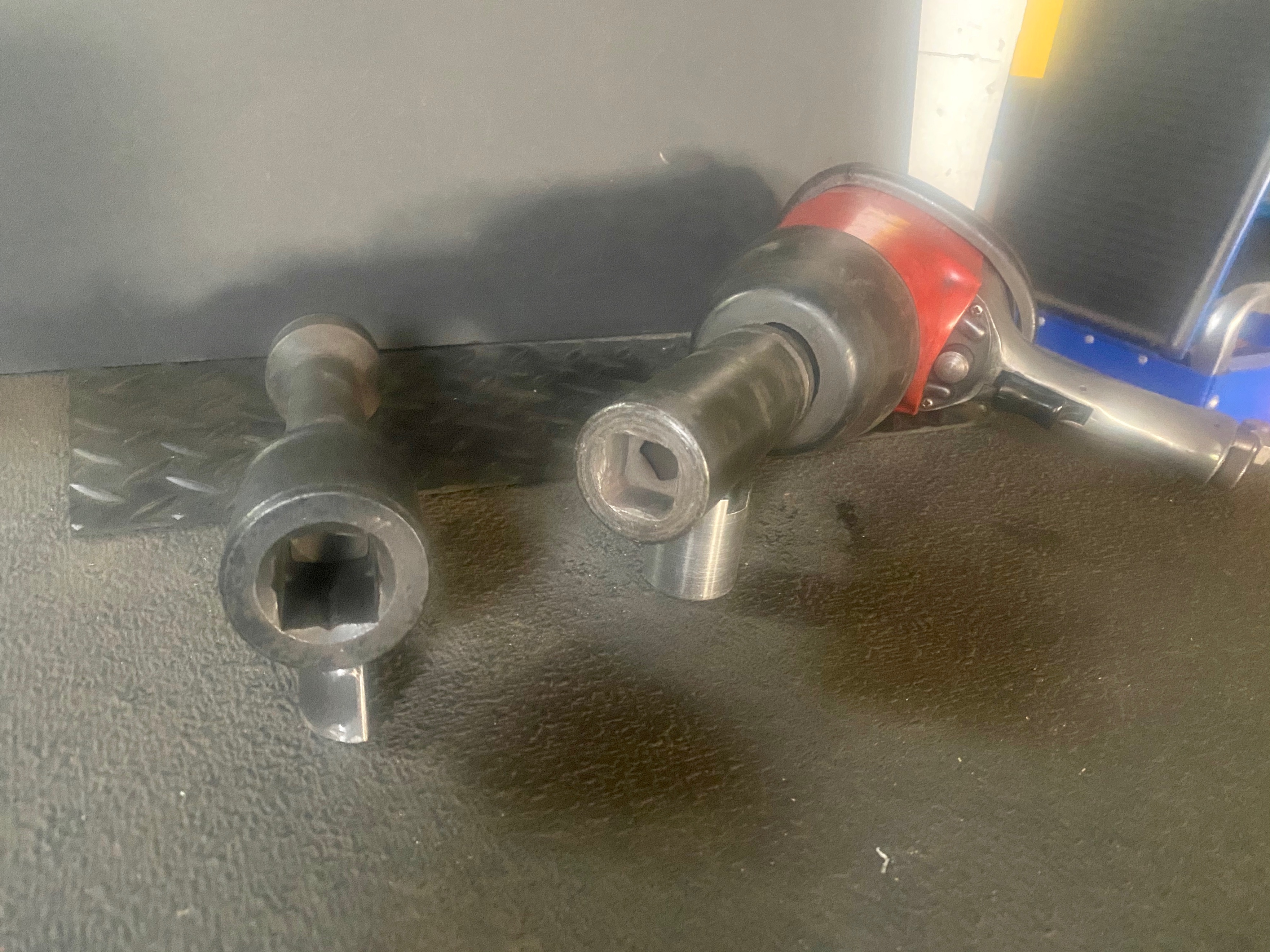

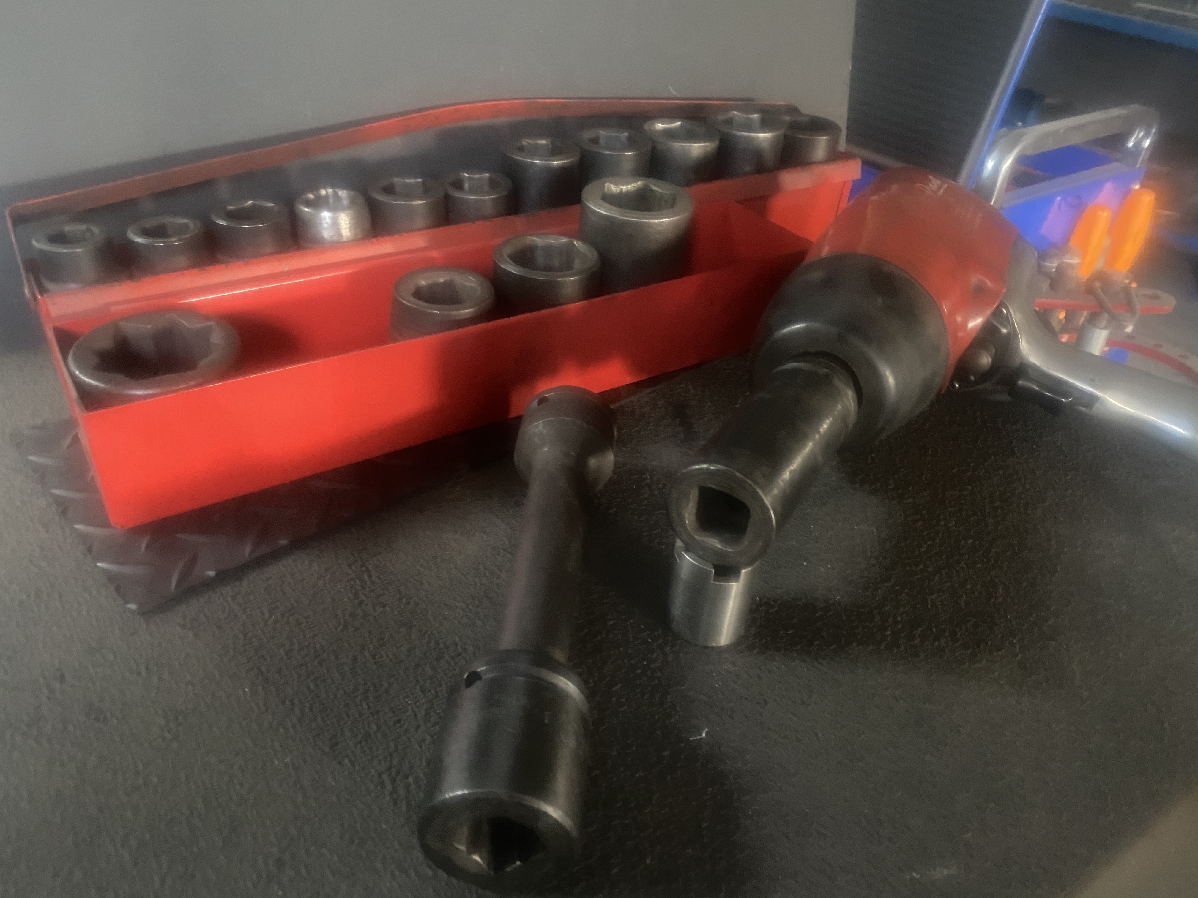

My son ran over a 10" log today and brought his old Army 6x6 to a stand still, a rear end control link come off the rubber bushing mount causing the rear rear end to go sideways and pulled driveshaft apart, then my son come up and got my 40 year old homemade square socket. Well he broke that but that can be expected with a 6' pipe on breaker bar, somethings going to break when just putting a pipe on.
So had to make new square part on square socket, used old piece of truck spring. Then we went down to the log pile. I took the hammer and banged the square lug nut hard, put pipe on bar and banged that hard and finally got the lug nuts to let go and off, pipe works best if hitting socket same time.

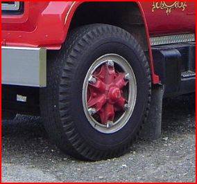

You lost me all ready, gee that was quick............

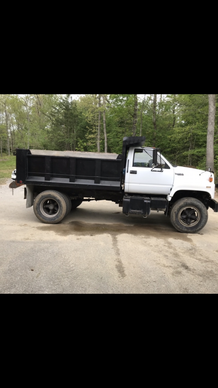

My truck is a Dayton wheel. The wheel is hollow and the hub is as big as the inside and it’s secured with wedges. They were common 30 years ago and older but not so much anymore. I thought a budd wheel covered the rest of them. Most heavy trucks use a piloted hub which is by far the best option. Some use taper lug nuts like most light vehicles use.IMG_9093.JPG

Just taking the wheels off the dayton and putting them back on round is a job. Having to pull the 2-300 pound hubs while spilling oil everywhere and probably ruining the seals in the process is a real treat. There’s definitely a good reason why they’re pretty much obsolete now.

Back in the day when I was around semis and cranes we kept the attached tool in every truck for changing Budd wheels. Many times that tool saved the day but they are somewhat expensive. Ken-Tool Power Wrench Sets for Truck, Farm, Buses, Aircraft, RV's – All Tire Supply
