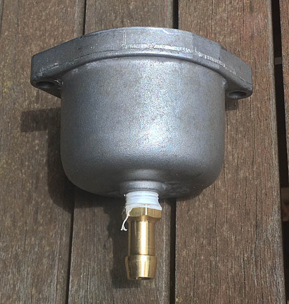

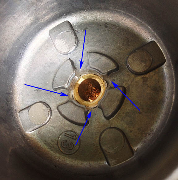

Who has experience with epoxy and (modern) gasoline? What kind of epoxy last years in a USA-gasoline environment?
I have 9HP Briggs & Stratton motor that has no float bowl drain. It has a very small boss cast into it, and perhaps feasible that it could be tapped for a small plug about 3/8". I don't have confidence that the sealing surface is good enough or would be square with regards to my tapped threads & I don't want it to seep. Also I want to use a larger cup-style plug. I'm thinking of cutting out the cup-style plug and boss from another carburetor and epoxy-ing it onto the bottom of this bowl. Alternatively, does anyone know if floatbowls are available for a B&S that already have a drain cup?
I like the "cup style" because it holds a sample of the stuff at the bottom. You can inspect for junk or water at the time of draining.
Here are pics of the floatbowl.
