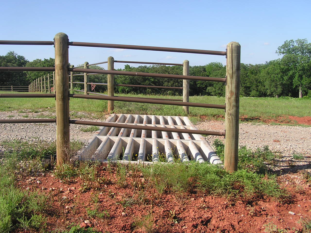

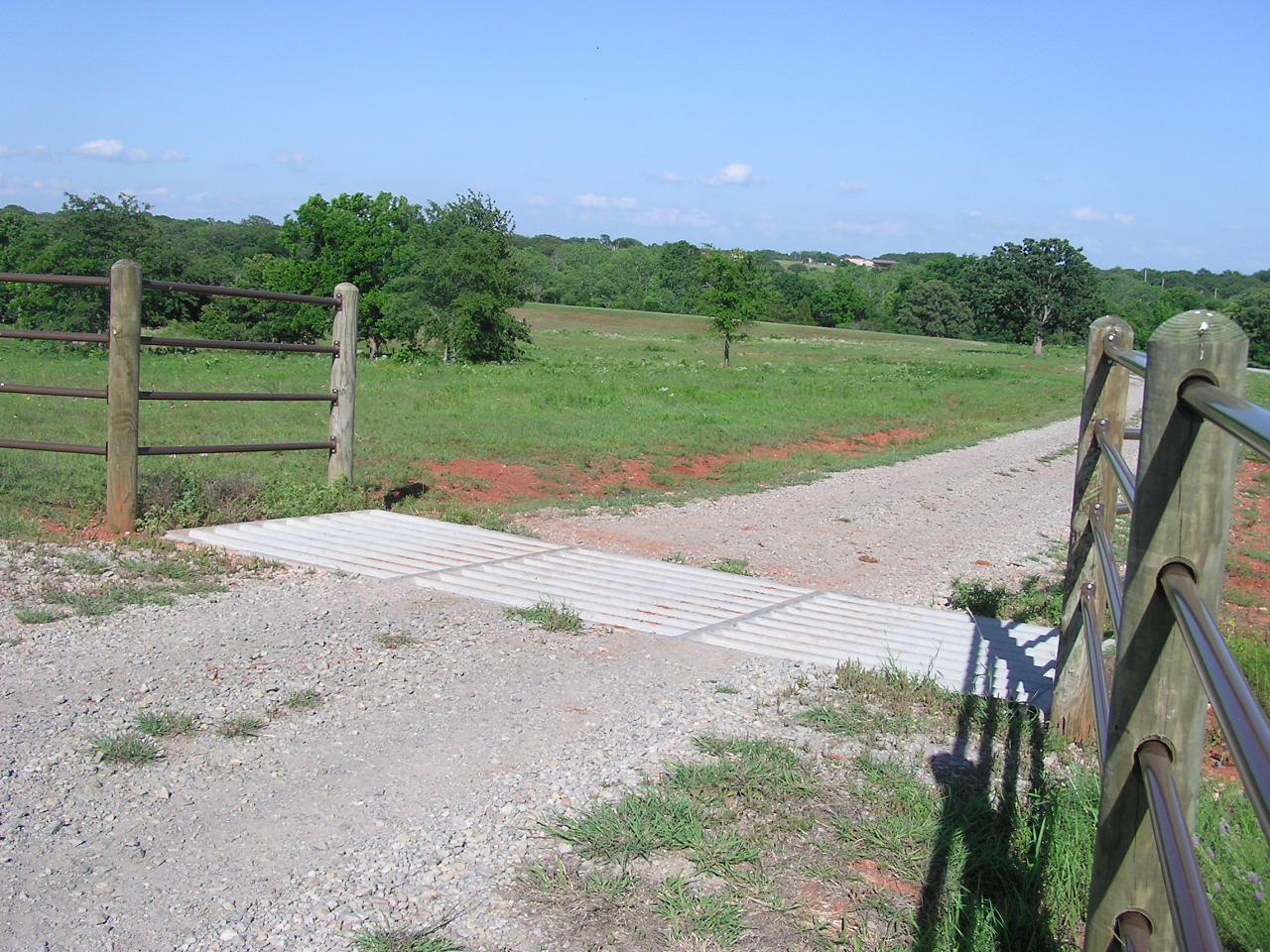

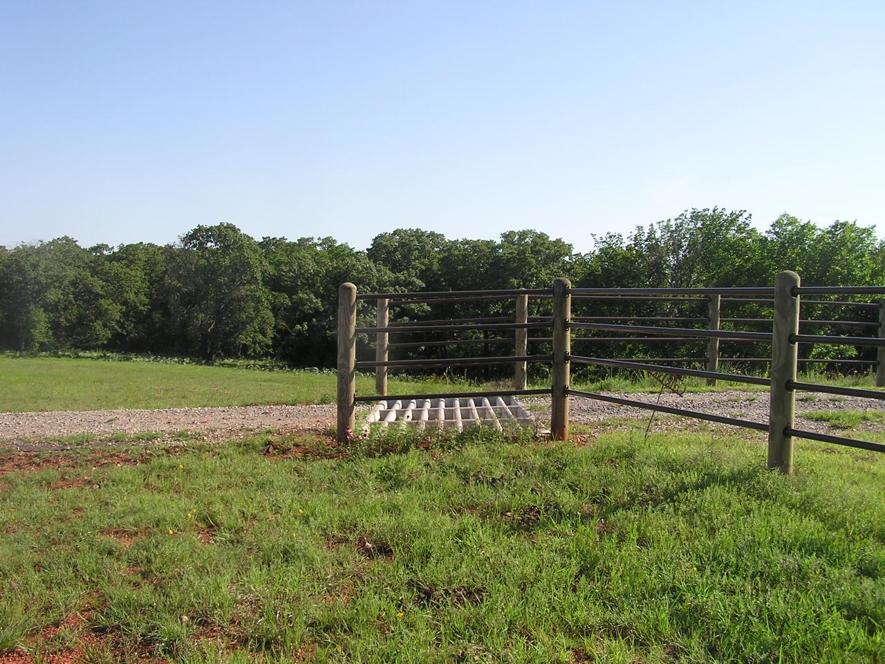

To keep animals in (depending what type) you could install a cattle grid Cattle grid - Wikipedia. My neighbor has one that has rollers on it and it seems to work well. With that they can leave the gate open much of the time without animals coming in or out. It's hard to walk on so you would need a person gate off to the side.
   / Entry Gate advice appreciated. #80
We used a concrete cattle guard: Farm Products - SI Precast Concrete
