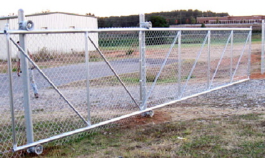

One of the problems with a slide gate is that it needs to be on a ground track if an automatic opener is used. Every roll gate on tires I've ever seen has been manual open / close because they tend to drift. The most durable track systems are the steel V groove roller that runs on an angle iron on flatbar track. That does a pretty good job at shoving ice, gravel, etc. aside and keep running, but driving over that 1.5" angle iron gets old after awhile.
No, it is possible to have them free floating without an angle iron track. We have a chainlink gate at work that is setup that way as does the local scrapyard.
Here is a picture of one (they say that it is "easily automated for remote operation"):

Aaron, that's what I refer to as a cantilever gate. I've built dozens of them. They are the way to go if you have enough room for the tail. Most roll gates are just a tad longer than the opening and only have support rollers on the side near the opening.
The gate pictured really should have a strongback on it, looks like about a 24' opening. One bit of advice for anyone setting posts for a cantilever; when closed they exert quite a moment arm on the furthest support post, and can claw hammer them out of their set, especially the powder coated ones. When I'd cut posts for a cantilever set, I'd grab a couple handfuls of slugs from the ironworker drop bucket and weld them around the buried ends of the posts to make them stickier for the concrete.

Ah, I thought you were calling both the same.
Good idea on the slugs for the far post.
