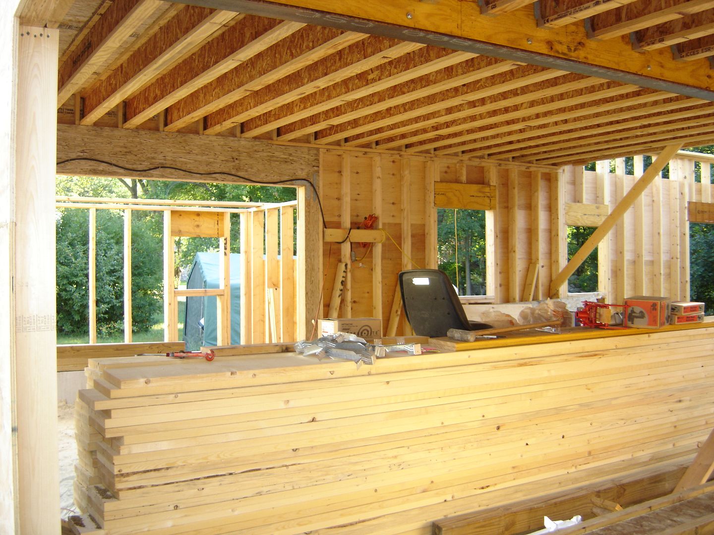

Sounds like you want to do is exactly what I did in my barn when I built it.
I have a room over the front half of my structure - and I wanted to have a clear span underneath with minimal supporting columns.
What I got was a large steel I beam - that then had 4 pieces of LVL sandwiched in. I hung Weyerhauser TJI-560 wooden I-joists off of that. The total span is 28 feet in width - so the I-joists are nominally 14 feet long on each side. The steel I-beam is 24ft long - and is supported by one column on each end. I'm recalling this from memory - but I believe the columns are 4" in diameter - with 1/4" wall thickness.
This was all approved by my local building department - and has been in place for a few years now. I spec'ed that I wanted a high load capacity bearing capability for the floor that the steel I-beam supports - and I can tell you that it's solid as a rock. I've got a bunch of 5 gallon pails of ballast that I removed from the tires in my tractor stacked up there - and it doesn't seem to matter one bit.
If you want more detailed specs on what I used for a beam - let me know and I'll take some measurements or see if I can dig out the original engineering specs that the steel supplier gave me.
/ Engineering questions - steel laminate beams #47
This is the only pic I've got online right now that shows the structure of the floor - if you're interested I can see what else I have or take some more.

joe - if you don't mind, can you get me the size of the beam? I have to span 21' or so just as you did, except the span on each side will be right around 17' instead of 14'. I plan on doing it in the same manner as yours was done. Each end will bolted with steel plates to a 10"x10" oak post.
