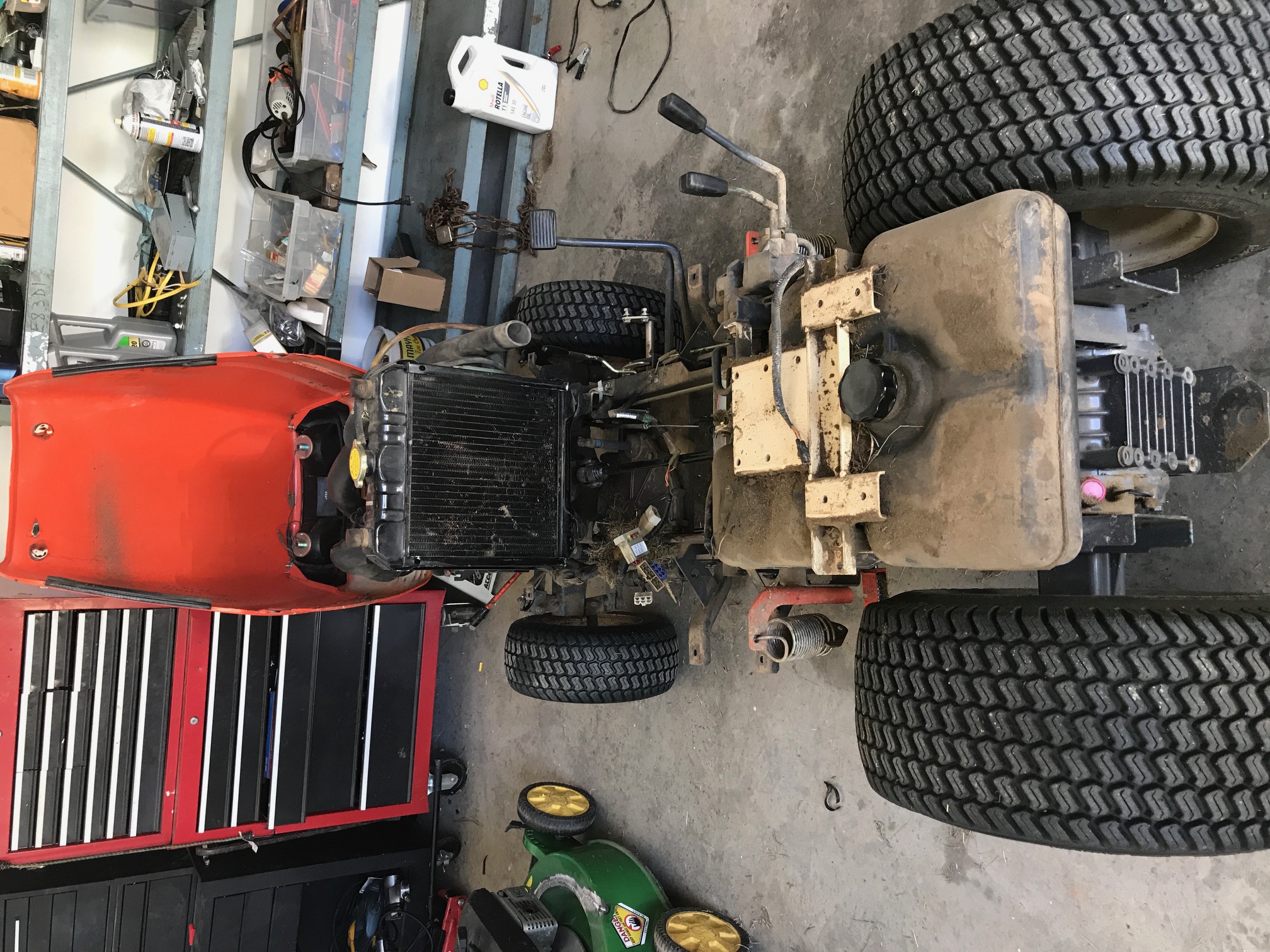

Update, found the problem, the engine to transmision drive shaft front U joint seized causing the splined adapter to wear to the point where it was jammed on the drive shaft at an angle. I had greased the splines regularly, so if you have a vibration problem check this drive shaft. Thanks for all the advice, Ray

I second RayK checking the u-joints on the PTO shaft.
I have been chasing a vibration problem on my G1800 with 900 hours for a while. I was chasing it on the engine, and couldn't make it get better. It was slowly degrading. I finally found the issue on the front u-joint on the HST PTO shaft. You can reach up under the tractor from the right side and shake the PTO shaft with the mower deck on. Comes out back of engine and goes back to HST which is at rear axle.
Had to pull the fender and steering column off to get easy access, but really only takes about 45 minutes. And allows a lot of clean up around the fuel tank and wire harness. That an a new belt on the mower deck, and my G1800 is smooth as new again.
I have included a picture of the convertible. PTO is readily available in this condition. And I also changed the fan belt when I was in there, as the PTO has to be unhooked to do that. And it was in bad shape after 900 hours. Kubota_Convertible.JPG
I have read others do it without removing the fender and steering shaft. I could barely clear it to get it off from above and wouldn't want to tackle it from below. Anyway, well worth the time to get rid of that vibration.
