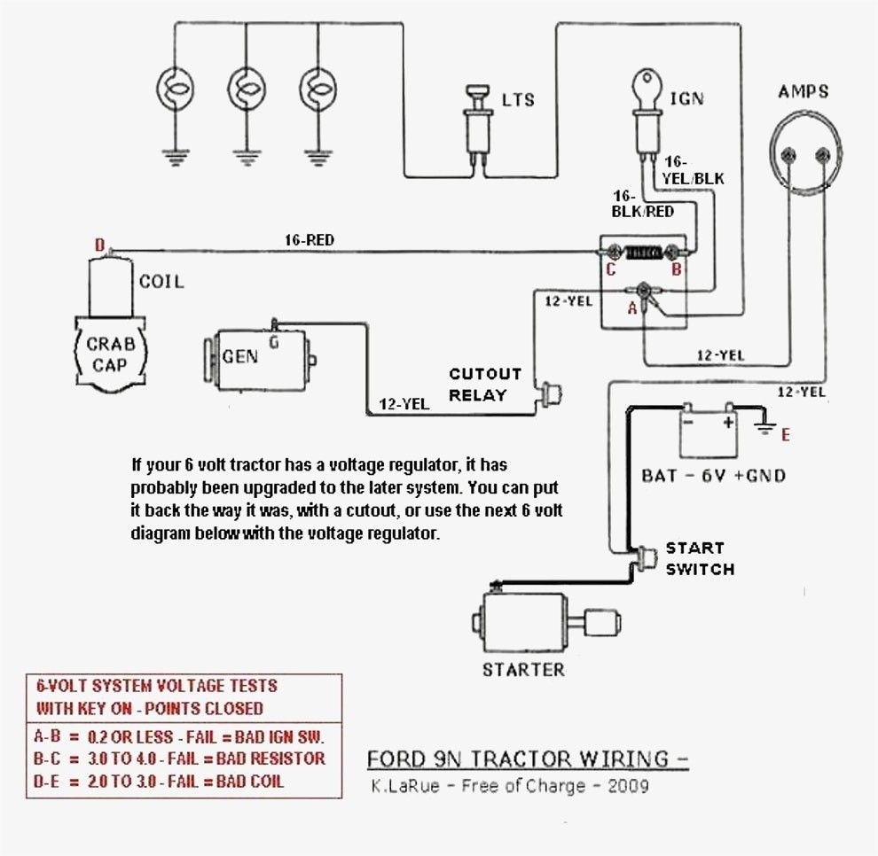

Put the new carb on it but while it made some difference it still starts to run rough under load. I put a spark checker on it and discovered that while it sits at idle I get an orange steady spark but pick up the rpm's and the spark gets erratic to non-existent. I only checked one cylinder since it was hot but I'll check all 4 tomorrow. The tractor had a bad generator when i started this renovation and the current 6-volt system has been rebuilt to the system on a 9-N with a brand new cut-out switch and generator. The guy that I purchased the generator from was meticulous in the directions on how to wire it that way and I confirmed with him thru pictures that it is wired correctly but now I am having doubts. The ammeter shows +9-10 amps when running at full power but since I am only getting an orange spark I am assuming I am not getting full power to the plugs? I also assume that I should work that first before I pull the distributor and make sure the timing hasn't jumped as some have suggested. What would cause low power to the plugs? The battery stays charged and I haven't had problems starting it.

Coil polarity?

This is exactly! how the wiring is currently. Since I don't have headlights there are only 8 wires total. I have taken pictures and verified it independently so I'm pretty sure the wiring is correct. However, I just did the 3 tests shown on the diagram and did only get 3V across B and C. I'll try a new resistor block and see but I aint getting my hopes up.

If I jumper'ed across the resistor would I be able to tell if the voltage to the coil increases? I realize that would be hard on the points but it would only be a minute or 2.
