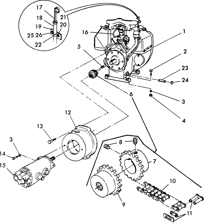

I'm losing my patience with the wisconsin vh4d in my skid steer.
Do you guys know off hand if the bolt pattern on the vh4d is a standard?
The top holes are 4" apart
The bottom holes are 6" apart
The "bolt circle" is about 8 1/2"
I'm thinking of repowering with a 40hp kohler or vanguard.

Sort of.
The bobcat 610 uses a pulley, which makes life much easier.
On my Ford skid steer, the pump mounts to a bracket which bolts to the engine. Additionally, it has a coupler between the pumps splined shaft and the engines keyed shaft.
I cannot seem to find documents on the Kohler engines to determine if they are drilled and tapped for this bolt pattern.

Engine mounts are standardised according to SAE. in bigger engines, JD, Cummins, Sisu, SAE 1 and SAE 3 bellhousings are most popular.

Attached is an illustration of my setup. Is that Bell housing mount pattern an SAE type? Notice the two top bolts, the two bottom bolts wider apart. The circle is around 8".

If you have a good machinist /fabrication shop in your area, take them the info and the engine you desire to repower with, and if needed they may be able to make an adapter plate or modify the current mounting set up as well,
   / Engine flange standard? #9
Its just a hydraulic pump, if you can get the sproket to go on the new engine with an adapter shaft or sleeve, you can build a new bell housing out of plate steel pretty easy.
