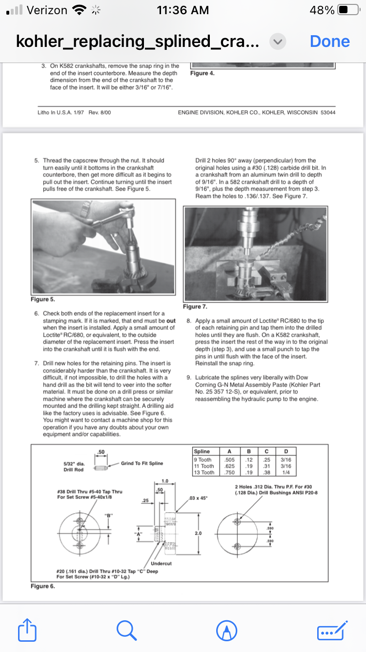

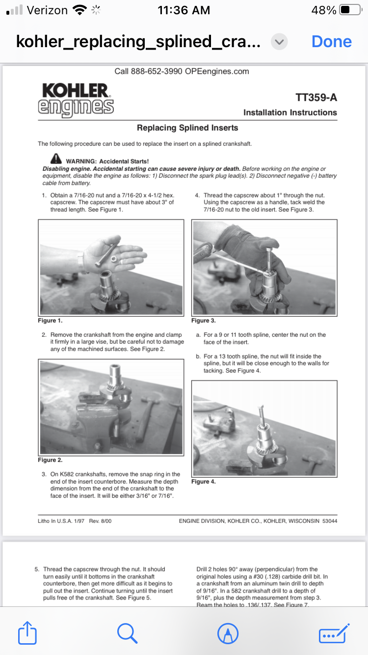

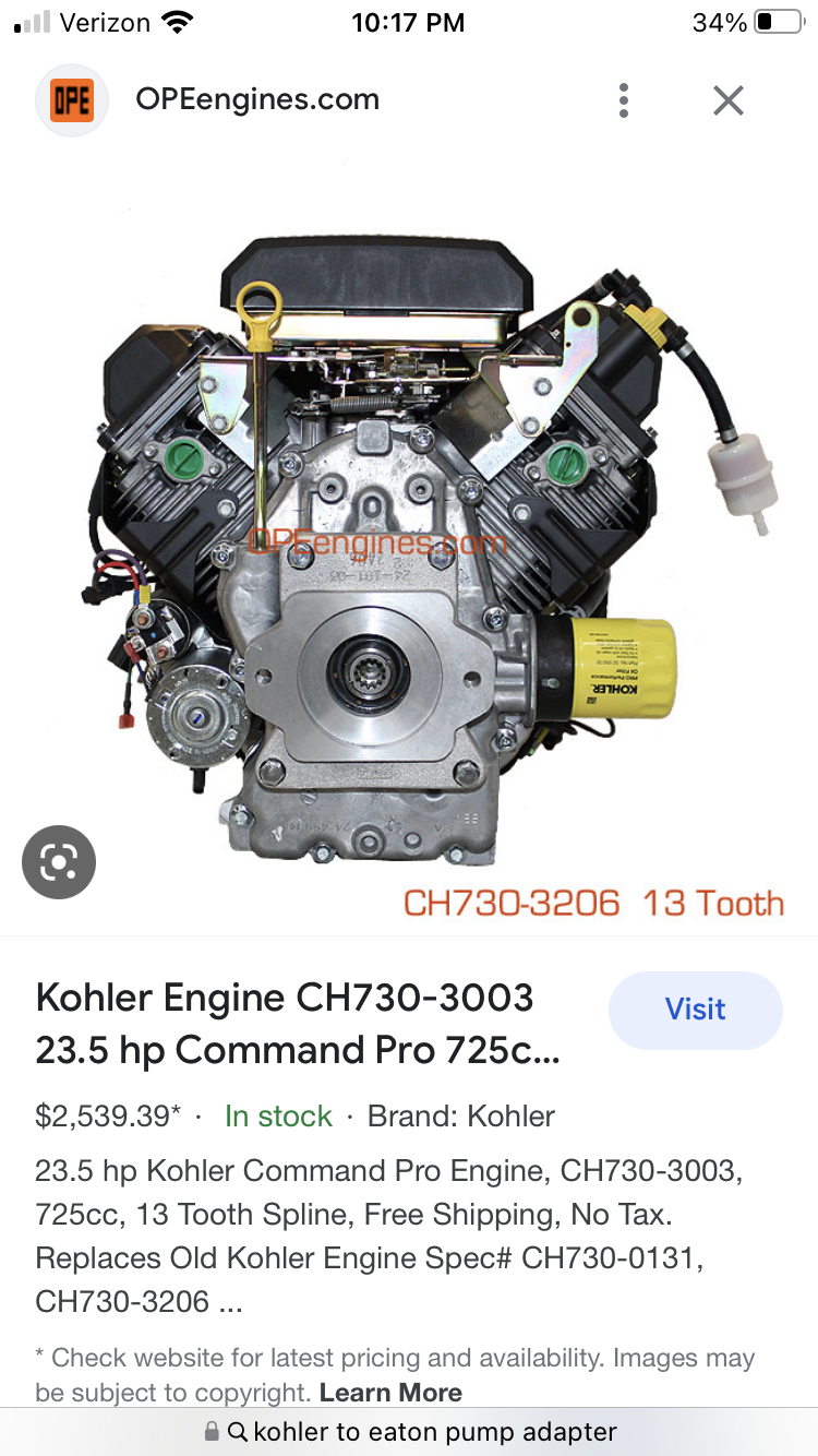

The past few days I’ve had to put my time into unrelated projects but about to hop back into the tractor disaster. So get this… last night just out of curiosity I started googling a couple new engine options. Looked up kohler because that’s what was originally in the machine. BAM! Google images… and would you look at that a female 13 spline 7/8” shaft. (Picture below) Started thinking how much it would suck if that stripped out and needed repair. Began to research repairs on the topic and find that kohler has instructions on how to switch out the failed/stripped spline adaptor. Not quite sure how this hadn’t come across my radar yet in all of the countless hours searching for couplers, adaptors, kohler, Eaton and everything related… the two pics of instructions below are just screen grabs but I’m sure the pdf can’t be hard to find. Long story short I am going to try and pop the stripped part out by welding on a nut and threading in a bottomed out bolt. I haven’t got the exact part number for replacement (because of lack of comparing exact specs at the moment) but saw others like it available on multiple sites including kohler’s site.

That probably explains the adapter and long mounting sleeves/extension ....
Try search for: "kohler_replacing_splined_crankshafts.pdf"... OR "Kohler engines tt359a"

Thanks! And yes explains some of the mystery to why it was setup the way it is. Not ideal but not terrible either lol. I’m going to try to get the stripped part out before ordering just so I’m sure. I saw around $160-180 for the replacement so just want to make sure things come apart before ordering it.

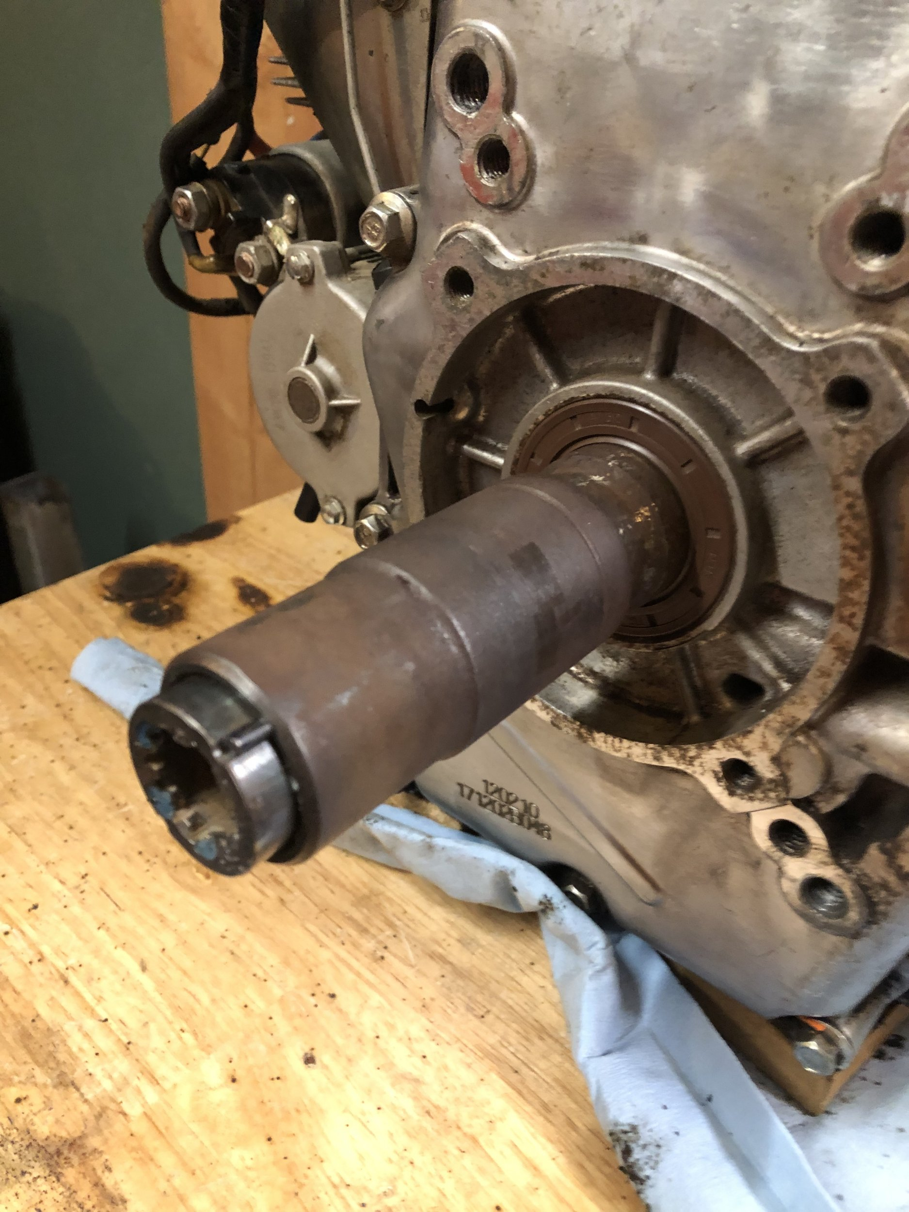

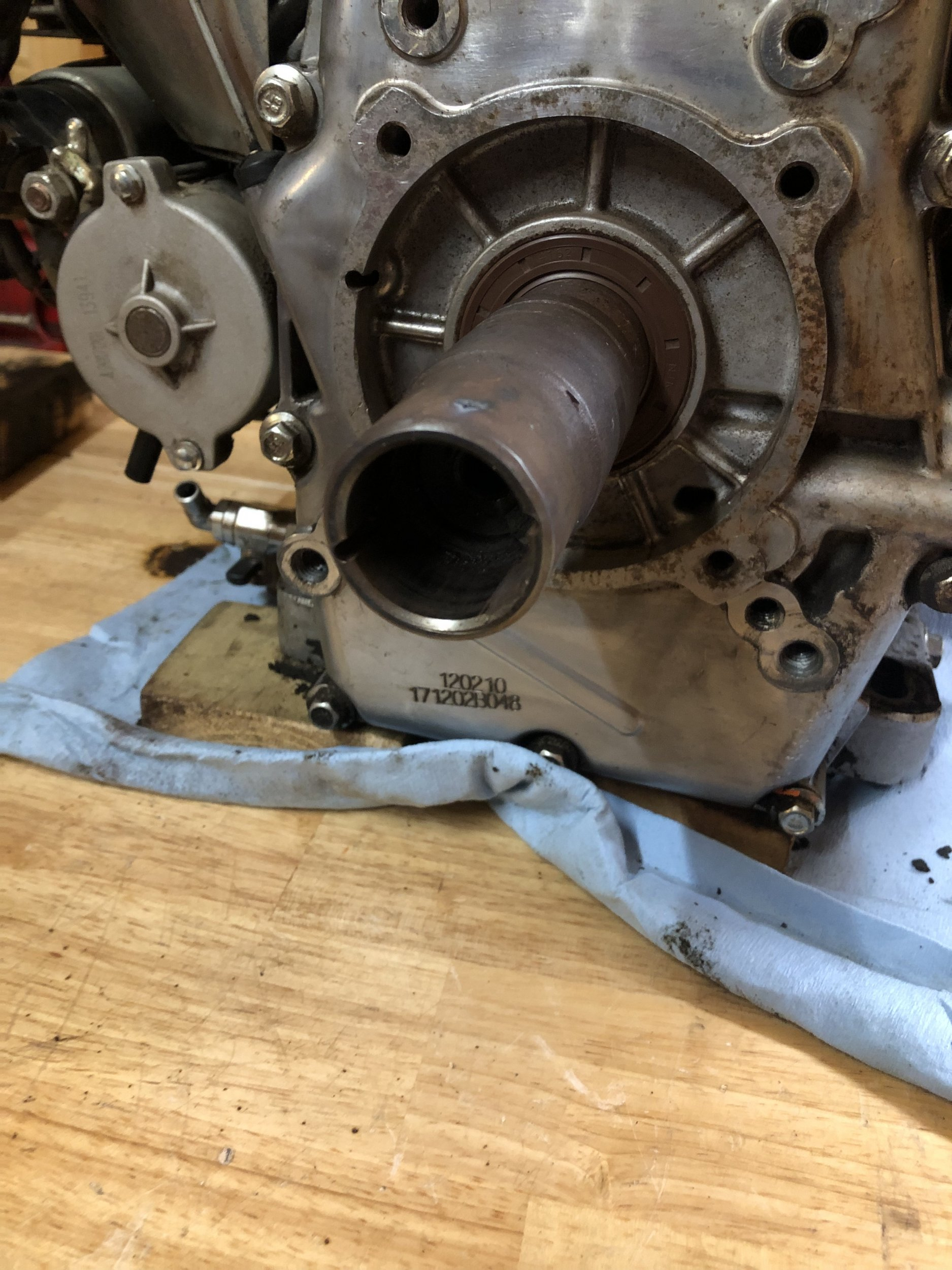

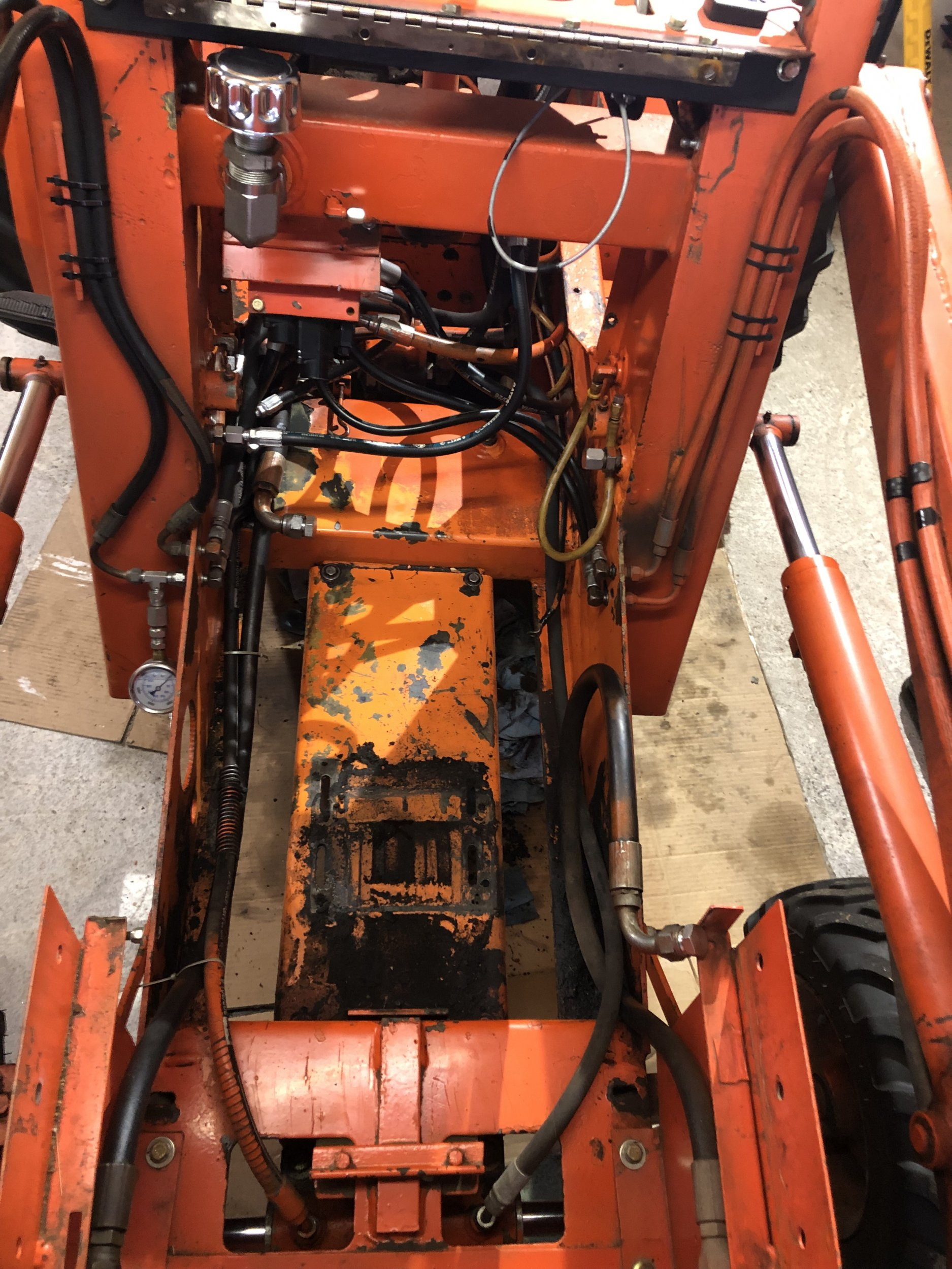

Update: I got the splined/toothed adapter piece out. Waiting on replacement parts to get here. They are scheduled to be here Monday. It took two attempts of using the procedure from the kohler instructions as well as adding heat with a propane torch. Ended up pulling the engine to do this. Pump and engine are out of the machine now and can clean up the grime that has been caked on for years.

Got it all back together now, seal looked pretty good when I had the pump up on the bench. Funny enough though when I put the pump back in it started to leak a little out the front seal. Fml….I even had brought the pump into NH hydraulics with me to switch out a few boss fittings and at that time there was no sign of leakage. Kicking myself for not resealing the whole pump while I had it out. The full seal kit was about $110 on the internet, in stock, 2 day shipping. I wish I had done it. Thanks for that part number, if it gets bad enough I may just try switching out the front seal.
