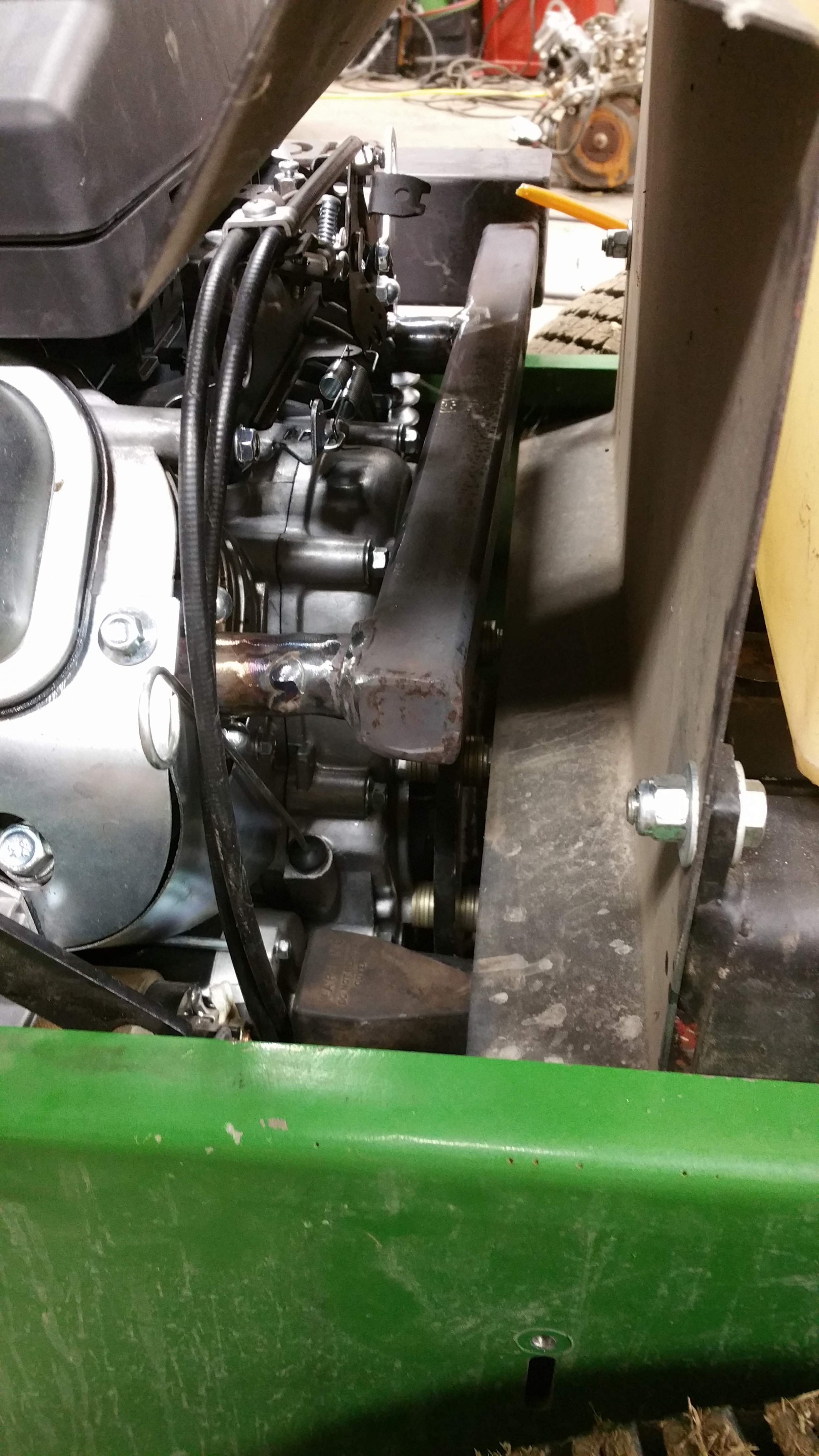

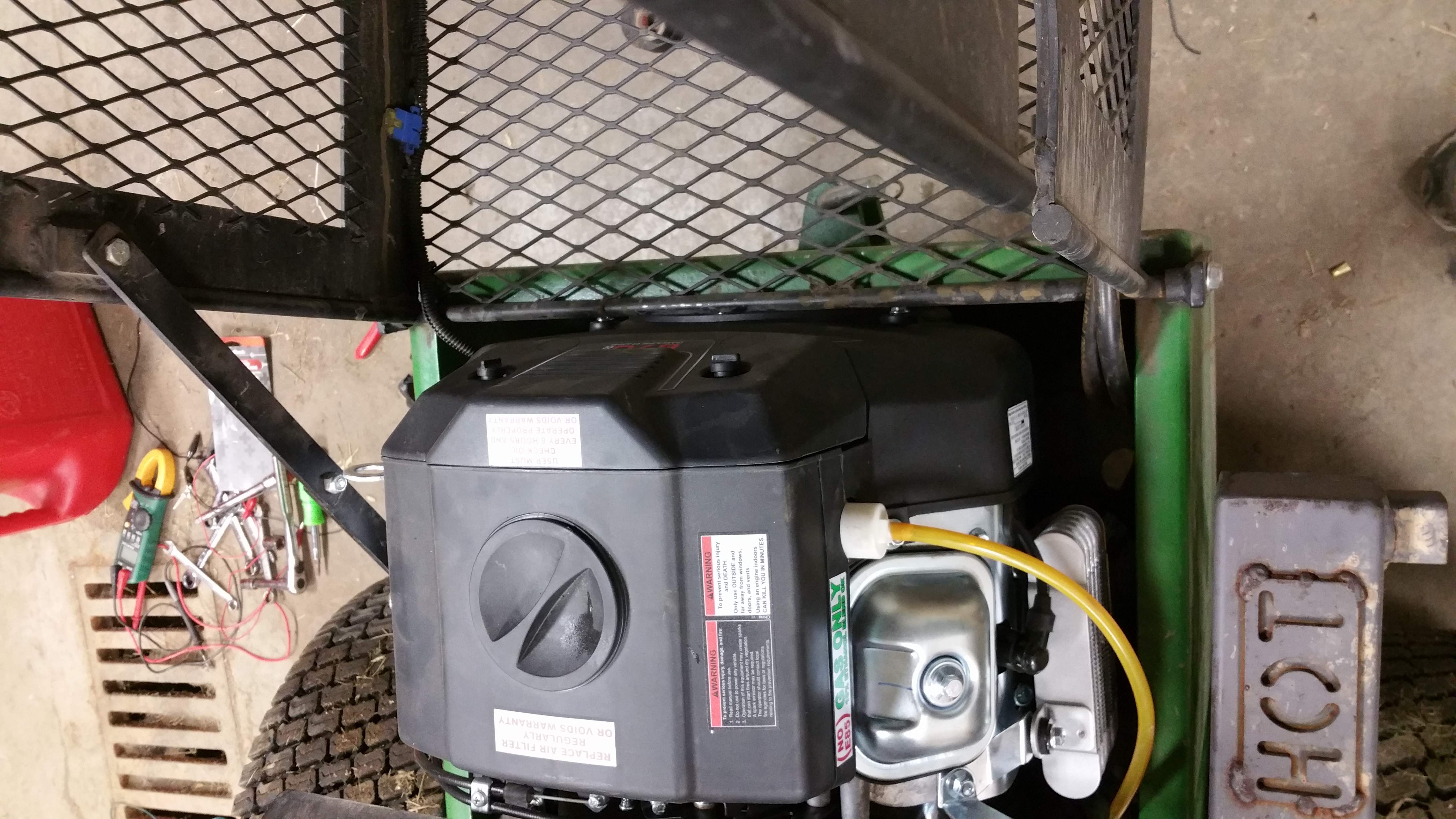

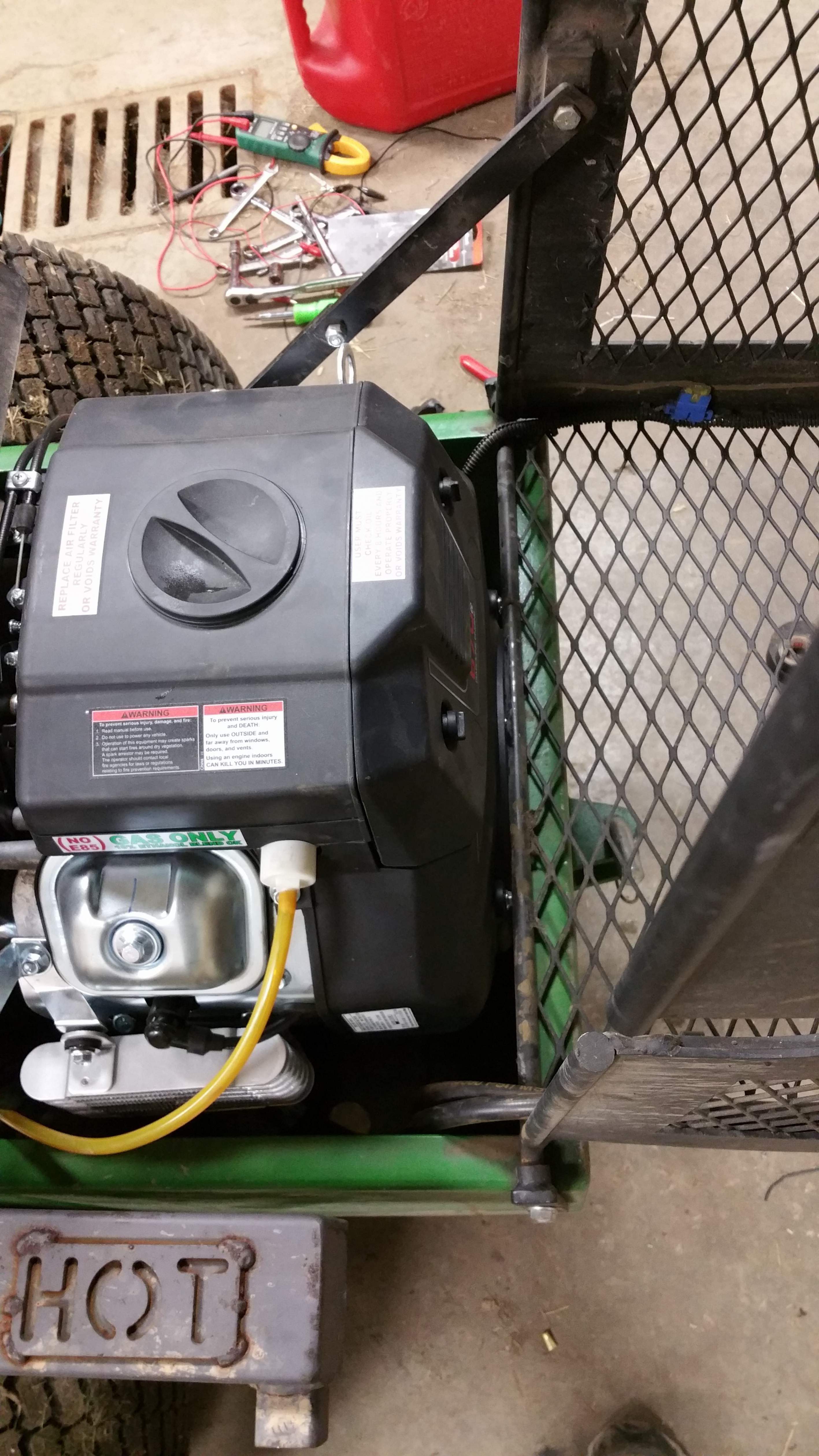

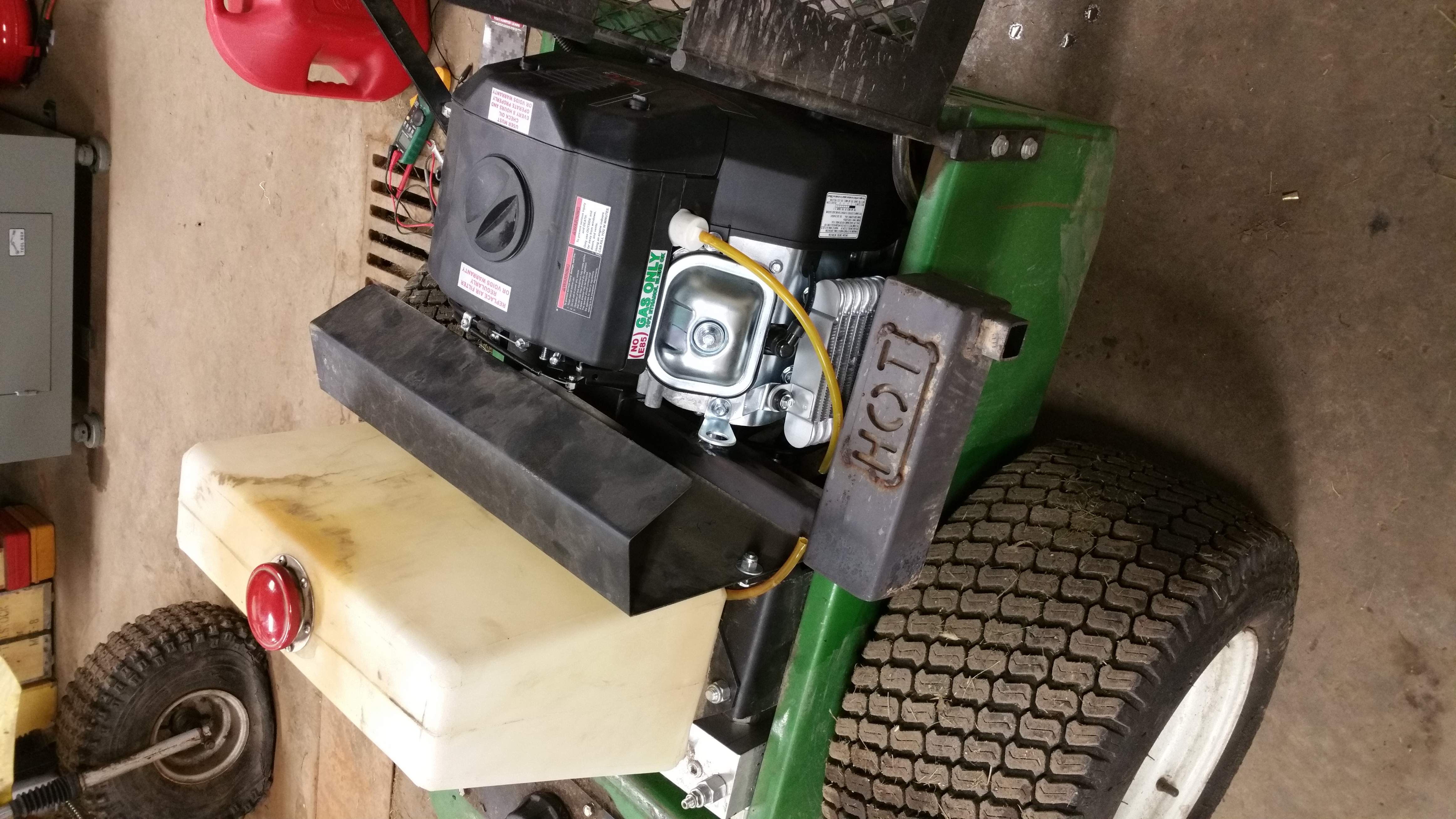

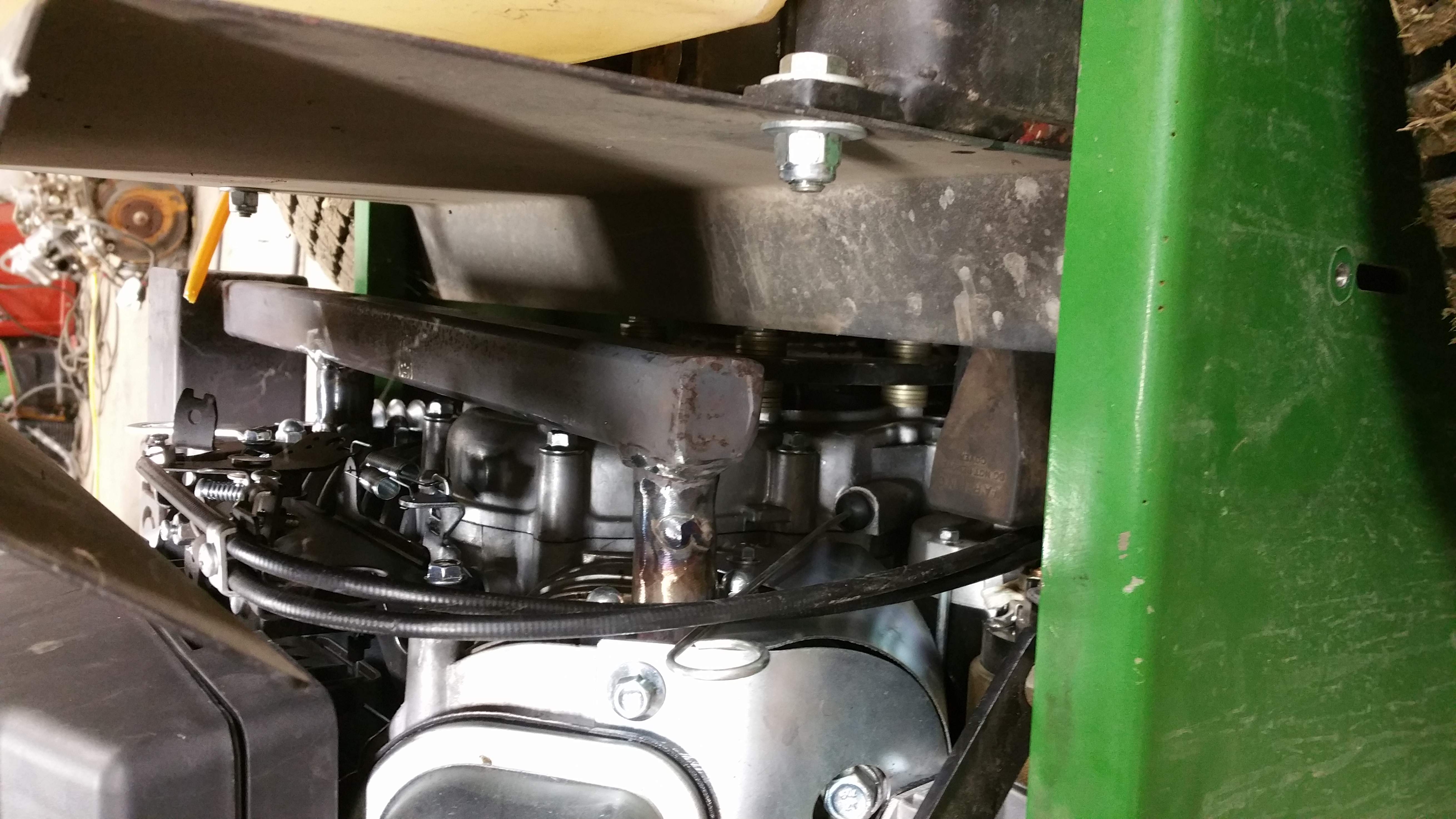

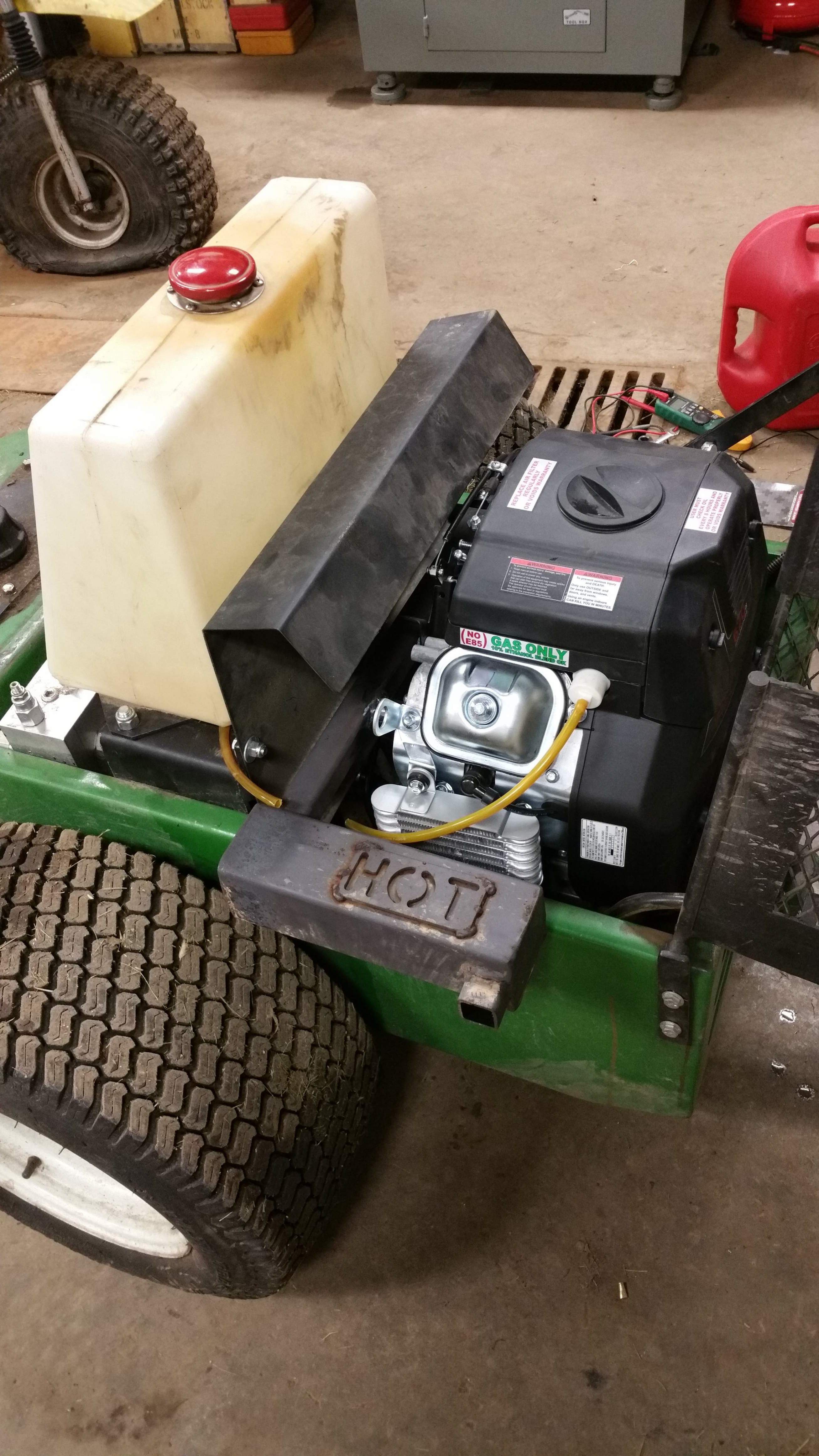

Hi Everyone,

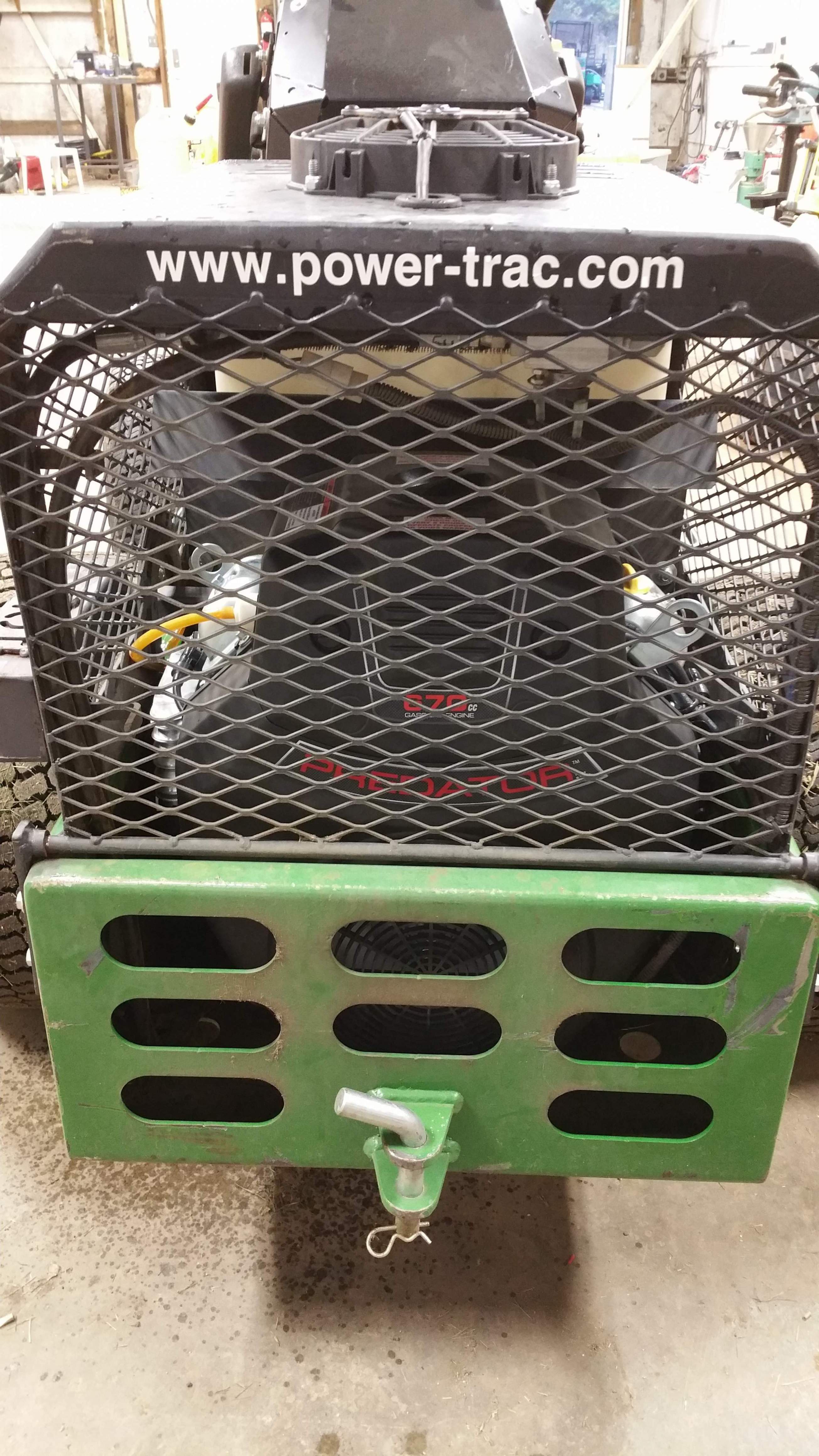

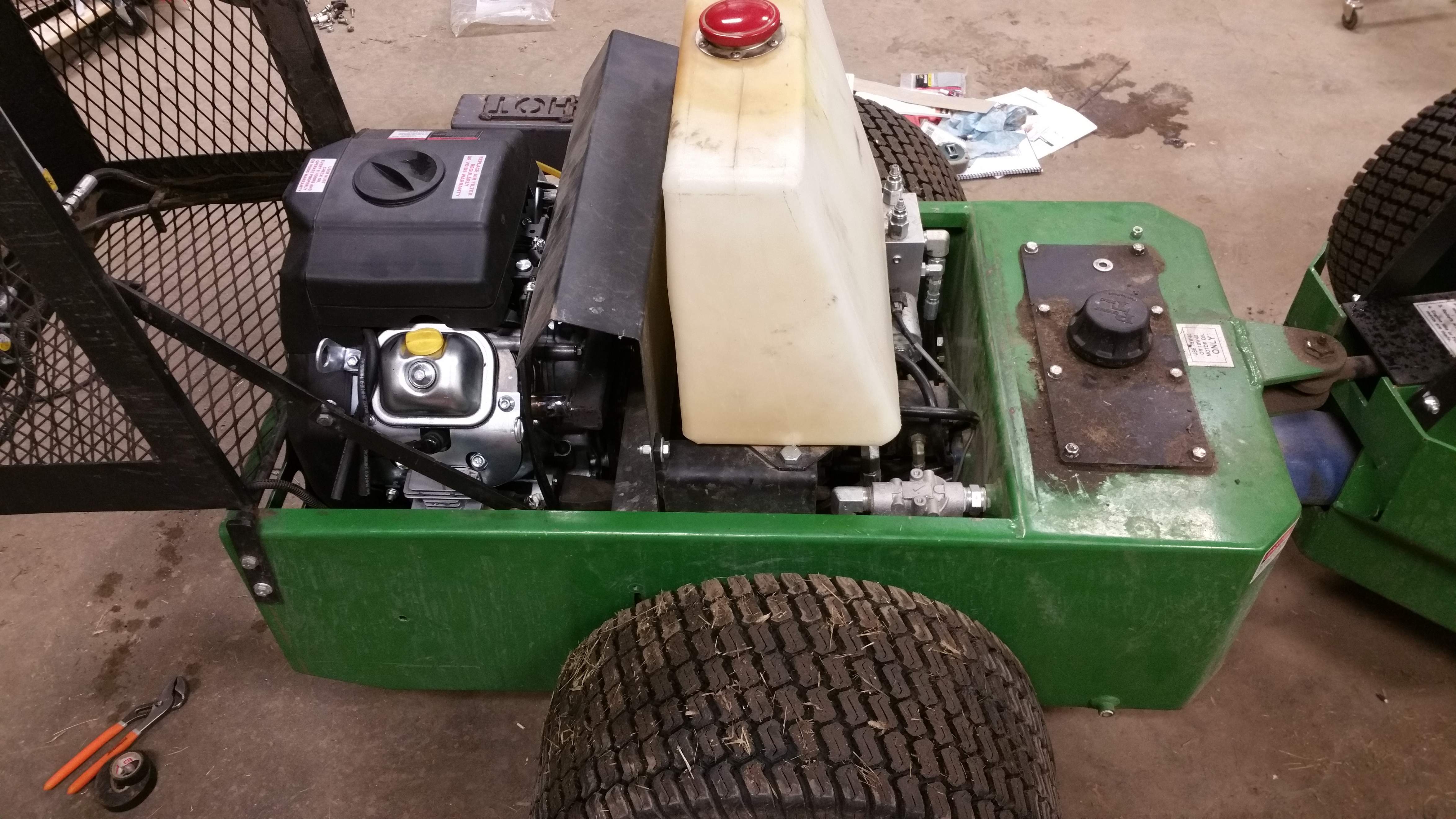

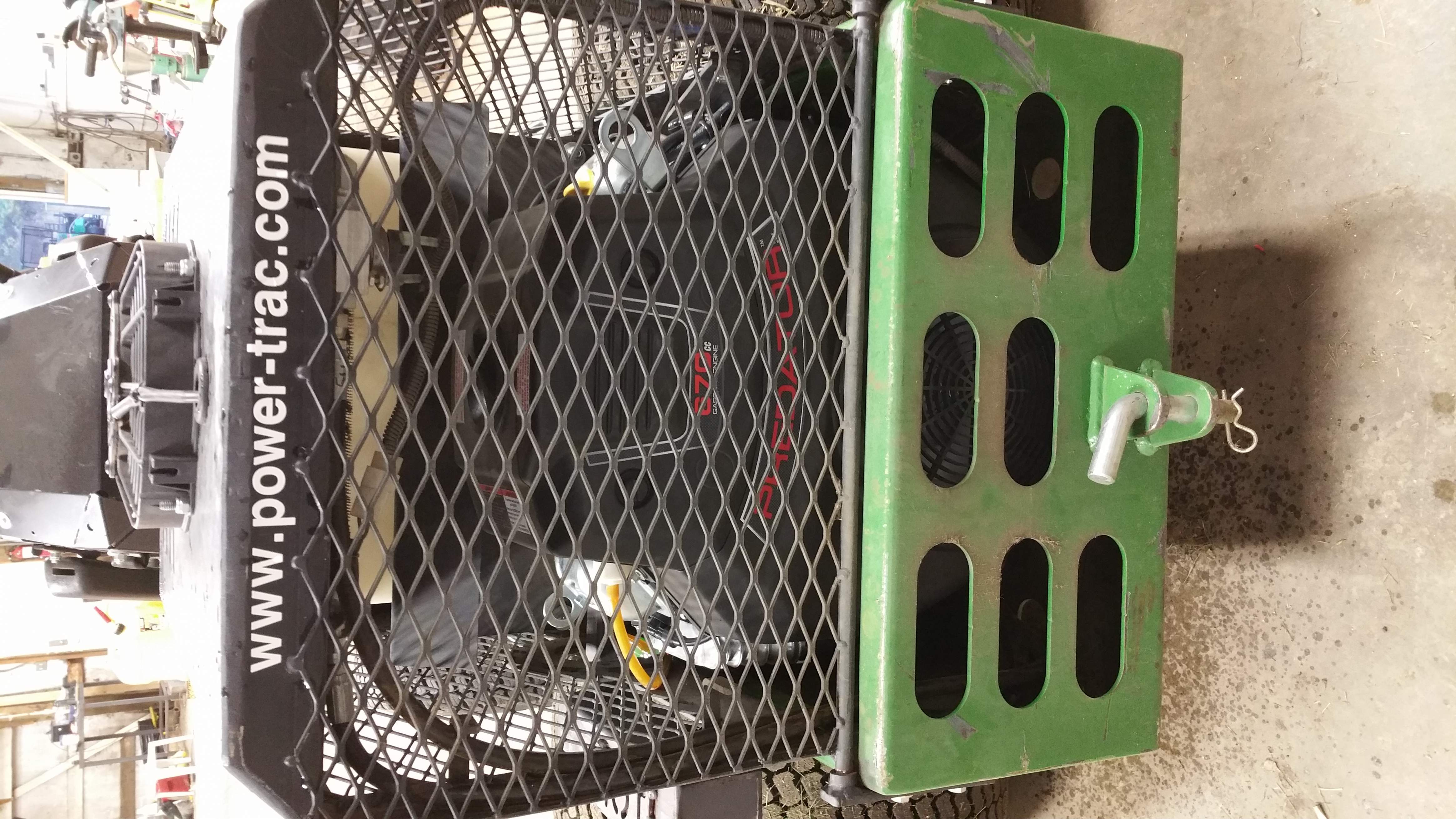

This is my first post here and I though you guys might be interested. At 104 hours on my just over one year old 422, my Robin decided to stop cooling on one cylinder and subsequently tossed a rod, welded the piston to the cylinder.....you know how that goes. Power Trac couldn't help and Robin refused a warranty claim after keeping my machine at a service facility for two months. After that crap, I decided to switch engine brands and re-power it myself.
Being fully aware of potential quality concerns, I bought a 22HP Honda knock off from Harbor Freight for $600. The bottom mounting holes and pattern are identical to the Robin. The PTO side mounting holes were slightly different for the pump mount, so that had to be slightly modified. The Predator shaft is 1in opposed to the 1 1/8 on the Robin...a new lovejoy fixed that. I had to cut off a chunk of the driveshaft and space out the pump mount, but everything fits, however pretty tight. I did not have to modify the frame or cover to accommodate anything. I had to cut and weld the exhaust flanges at 90 degrees on the original muffler, but that fits nice now too. The existing controls for throttle, choke, and start all work as they used to and the wiring was simple to deal with.
The new engine, out of the box had a bad ignition coil. I replaced both coils, since I was in there, with aftermarket coils intended for a Honda GX660 and everything works. Attached are a couple photos of the result.
There is nothing too exciting here, but I though I should share this with the community.

Nice job on the engine swap. I rotated some of the pictures for a better viewing angle.

Where is the battery mounted?
/ Engine Conversion PT-422 to Predator 670
It is right where it used to be under the gas tank on the side opposite the muffler.

Nice job on the installation.
Just one recommendation: where you have the oil cooler mounted, the exhaust manifold and muffler are going to heat it up. I mounted an oil cooler there on my PT422, and found out it made things worse. Just the radiated heat from the exhaust manifold will heat up the edge of the cooler to 300F+. You can run longer hoses, and put it the oil cooler on the other side.
Recommend you buy a $25 infrared thermometer, and take some shots of the oil cooler after you have been running for awhile and check to see if it is a problem.

Tmarks11,
Thank you for the advise. I will look at the temperature tomorrow. Good eye to pick out the 1100!
