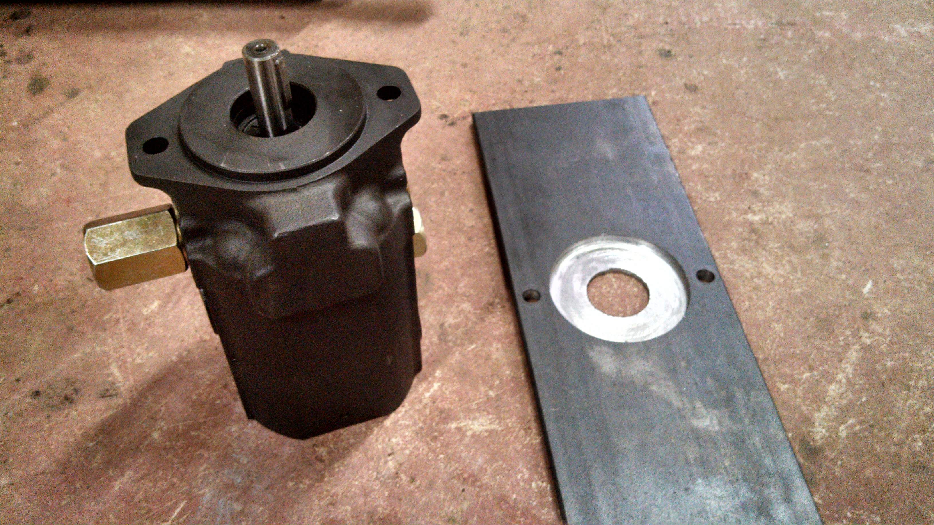

/ Engine and pump sizing for wood splitter #22
Oh, and here is some pics of my pump mounting:
