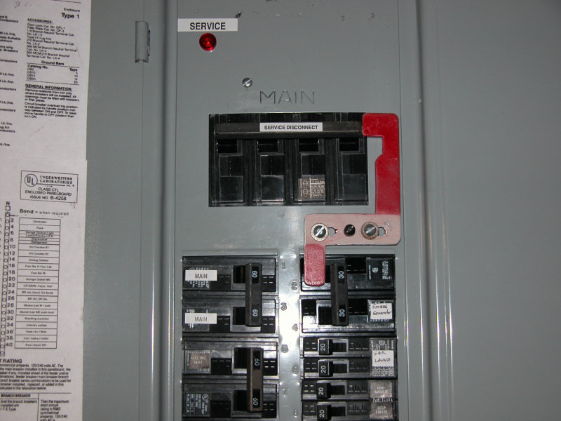

A far cheaper "transfer switch" is from these guys:
Generator InterLock Kit
This is a UL approved add-on that lets you use your existing panel and breakers. By adding a breaker for the genset feed, this kit will interlock it with the main breaker and meet safety requirements.
It is low cost and enables a full house feed. I used their idea and made my own. Works great.
Paul
This is the same way I did it. Square D makes the kit for a QO series box. I think it cost me less than $150 including the big generator cord. No reason to mess with a 2nd box and picking/choosing which breakers to move, which is fine until you re-arrange something in the house, and the freezer swaps sides of the basement...

I went with a generator backfeed to panel using the sliding gizmo to prevent two inputs at once. I also put two watt meters in the top of the panel cover so I can monitor load on each leg.

My question would be if you use one of these couldn't you potentially overload your generator if no one controls what gets turned on for load output?.....My Trans switch has load meters to show gen output and allows me to choose what does not get turned on in the house.....

In an outage I flip all the circuits in the breaker box to OFF, connect the generator to the switch and crank it up. The main difference is I now have full access to all the circuits in breaker box as long as they do not overload the generator. The electrician determined which circuits I can work, what combo might overload the generator based on my house configuration and size generator. Some circuits I can never use because they are just too big a power draw. With my 7000 watt continuous run generator and with a propane furnace and hot water heater I can run the furnace and have hot water - I have use all the circuits in my breaker box except the dryer, central air and the stove. I have well for water and it'll handle the pump for that that too.

I drew up a layout of the circuit panel with the electrician and I shaded in red what I can never use (for me its dryer, A/C and stove). My house is large but with the 7000 watt generator its pretty simple - if I turn off my well pump when there's water in the tank, I can run most everything else in the house at once (but the 3 above). Everything else will never be running at once anyhow - they don't now when the power is working. I agree with you, it was expensive but if there's another storm like last year, the cost is totally worth it to me. Last year with no switch, we ran out of water after 2 days - we were able to get out at that point and head to my brother's home but my biggest fear was the pipes freezing while we were gone.
