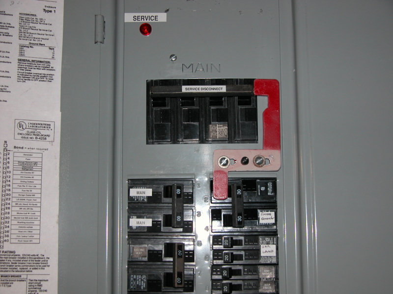

I didn't do anything with a 2nd panel. If you have 2 open adjacent slots in a Square D box, you can get an interlock kit that will tie a 2 pole breaker to your main, requiring 1 to be off for the other to be on. Then you run a heavy wire from this 2 pole breaker to an inlet box, much like the one posted earlier. In the case of a power outage, you plug the extension cord from the genny into the inlet box, start the generator, then flip off the breakers you don't need, and the main breaker, slide up the interlock, and flip on the inlet breaker. I now have the ability to power any outlet or light in my house. Some utilities don't approve of using a breaker like this to be the disconnect, but I also have a hard disconnect on the outside that I can pull to cut my house off of the grid if needed, but the inspector says i'm fine as is. I can't find the kit now, but you used to be able to get them from Lowes for about $30. I think the entire project cost me about $100 including the inlet box off E-bay, the wire and the heavy 2 pole breaker.
