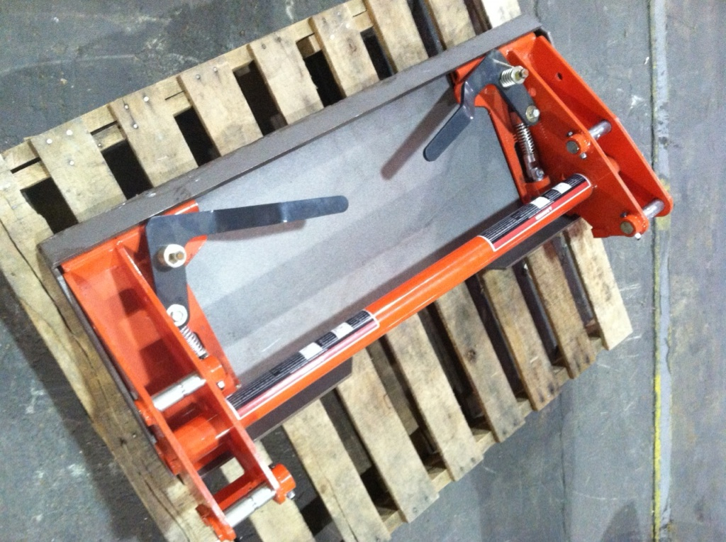

Has anyone changed the eMax factory 26L 'pin on bucket' to a Skid Steer Quick Hitch?
What brand did you go with?
Happy, sad, should have done different??

I did do this two years ago with my eMax 25. Can't remember which brand my dealer set me up with. Will look tomorrow and reply. It works well and glad I did it. Did loose a little curl. When the bucket is level on flat ground there is very little curl available on my setup. Quickly got used to it and has not been a problem.

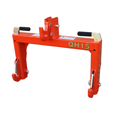

Quick Hitch is for the 3 point:
Quick Attach is for the loader:

Hi rdinatal, the adaptor my dealer provided is a Worksaver Item# 835140, McCormic 125c Adaptor to ss with pins. My eMax has the two hydraulic cylinders, thus the McCormic style. If you have the single cylinder, it is listed under subcompact Mahindra.
Thanks, mine also has the two hydraulic cylinders. This is a start!
