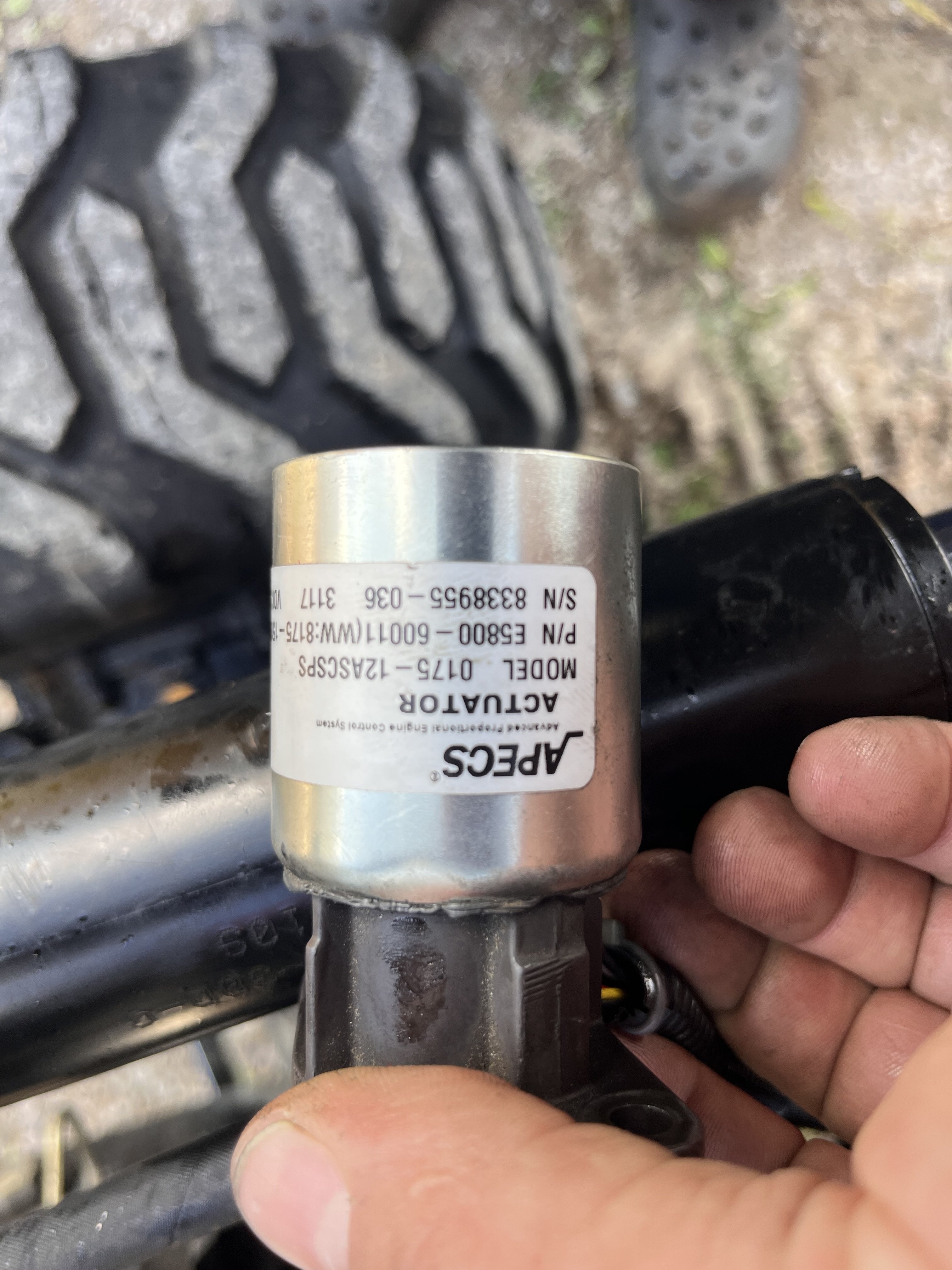

My apologies for not writing back on what the issue was back in 2022 but I took it to the dealer and they diagnosed the issue
It was a bad fuel actuator
