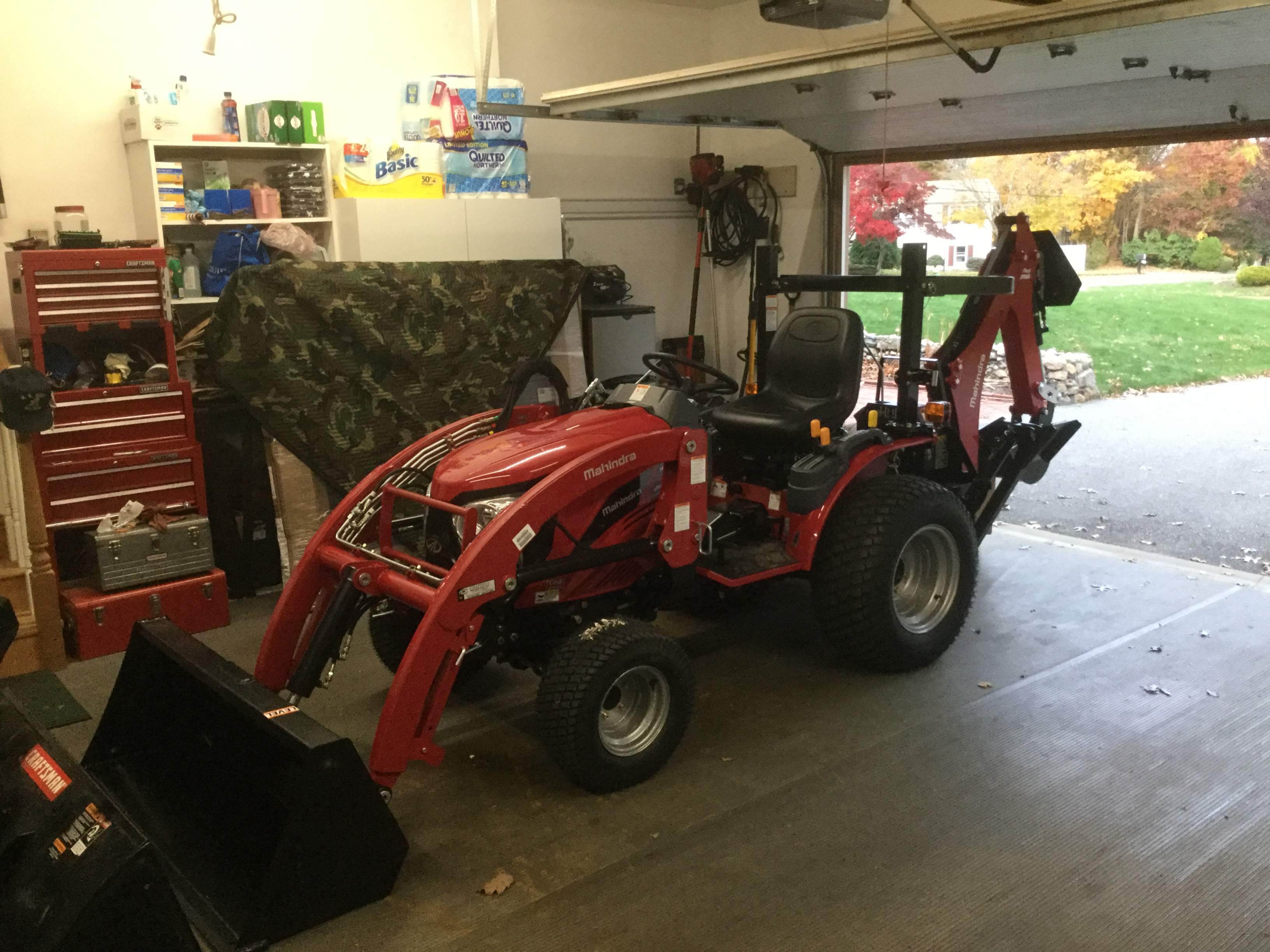

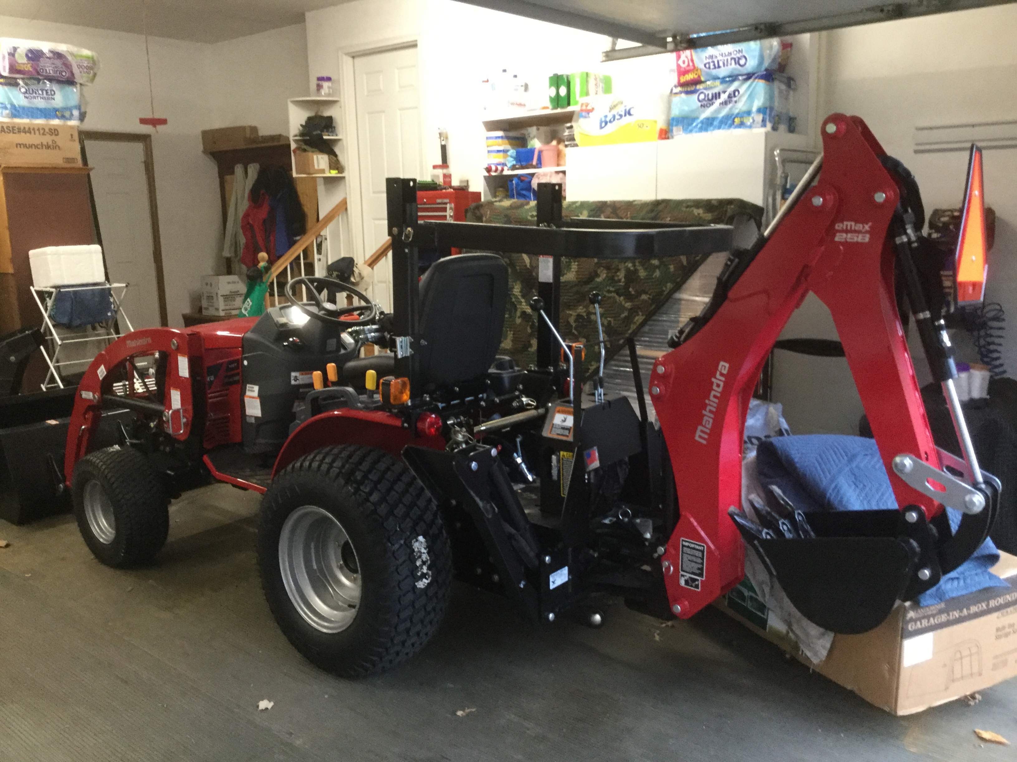

I have the Mahindra emax22 with backhoe and loader. So far it's a good machine.
