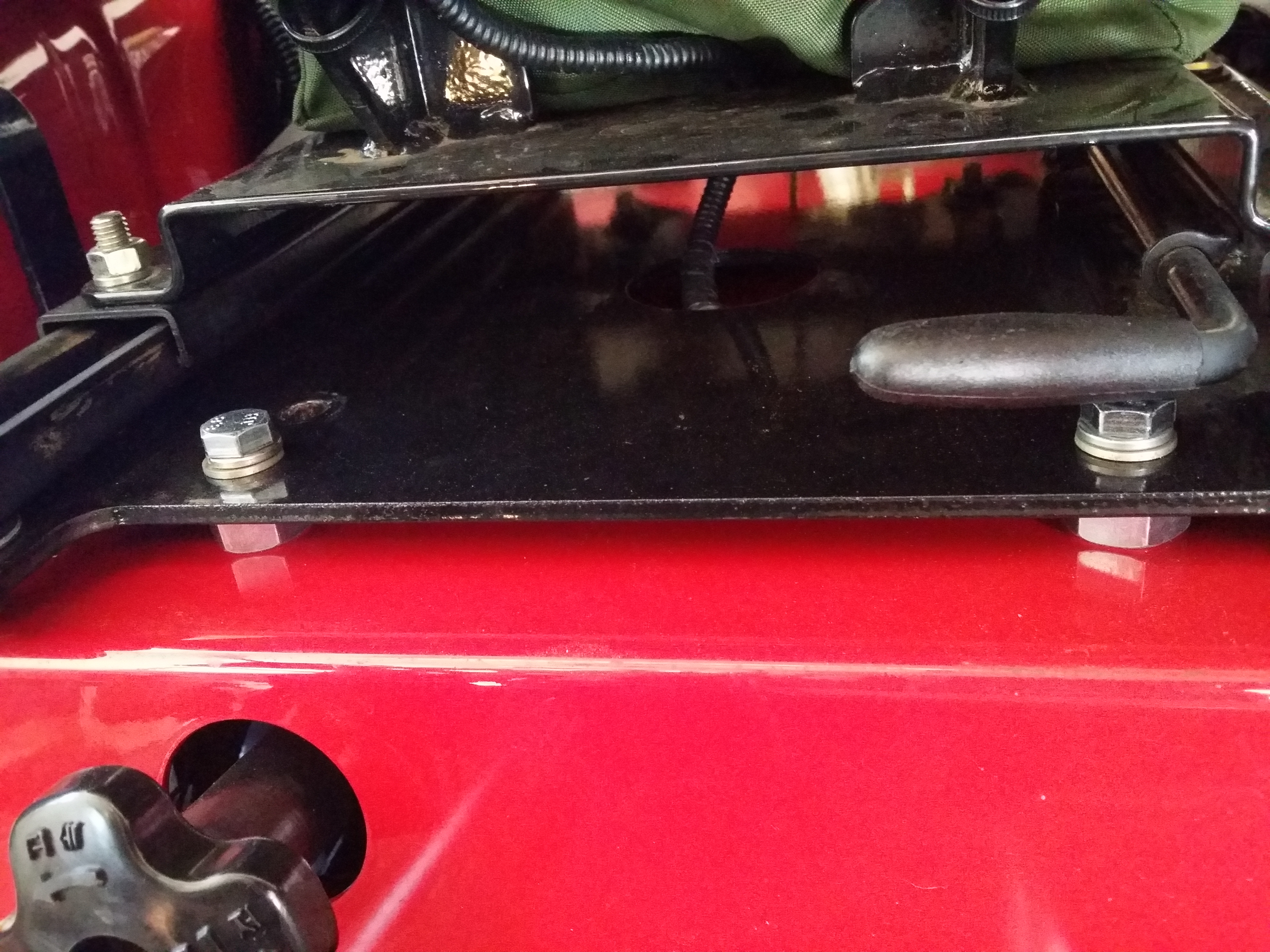

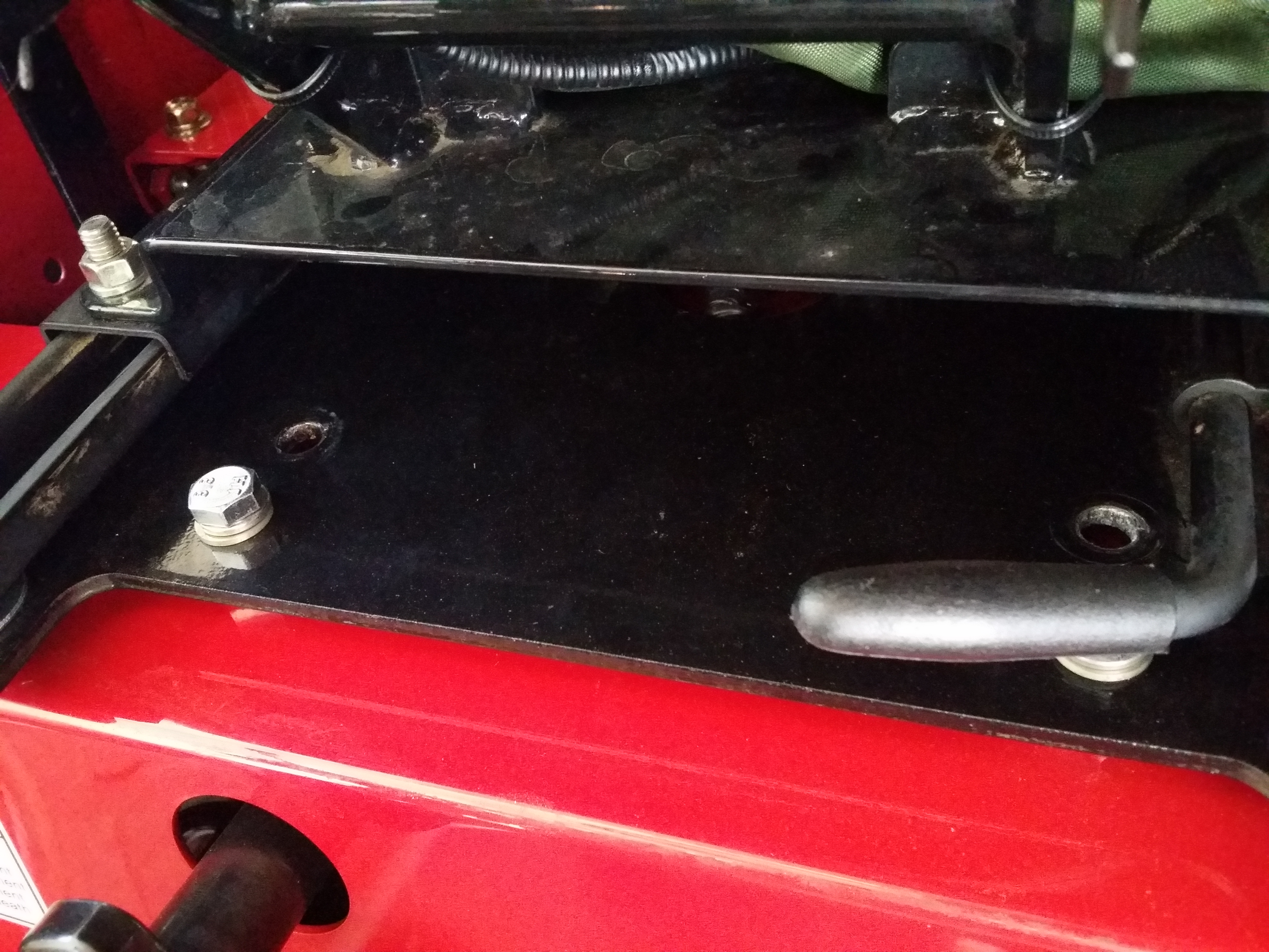

I found that the seat couldn't move back far enough. It always seemed cramped. I ended up adding 1/2" of hight by using nuts for spacers (longer bolts needed) and drilling holes 1" forward.
Not so close now!

I had the dealer do something similar when I purchased the 2538. He added a 2" piece of "U" channel to each side, thus raising the seat by 2". Big help.
