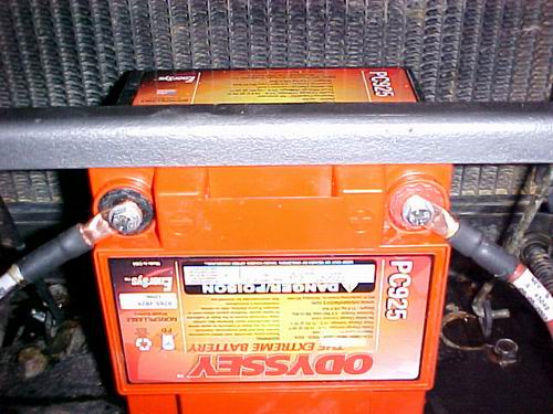

   / Eliminated The Battery Problem? #30
Well I joined the "No more OEM battery" club this week.
I went to start the tractor the week before last and could only manage a half hearted turn of the engine before the clicks started. No problem, I'll just give her a jump. When I connected the car, it really pulled the engine down, to a point I felt something was wrong.
I've needed a battery charger for a while so off to the store I go and get a smart charger. When I hooked it up it started to charge then gave me an error code indicating shorted cell. Well great, I was really needing to get rid of some more storm debris.
After checking the local parts houses for an SLA, AGM (aka Optima) there was nothing that would fit the battery box. I called my mechanic and asked him to order an Optima 51R. A few minutes later he called back to say they no longer manufacture that model. Not to worry, TBN has made me a veritable expert on repairs so I asked for an Odyssey battery...not havin' any of that either. So I ordered one from the factory on Tues. and it was here on Fri.
Tractorin' again...:D
P.S. This is the 925L despite the label.
