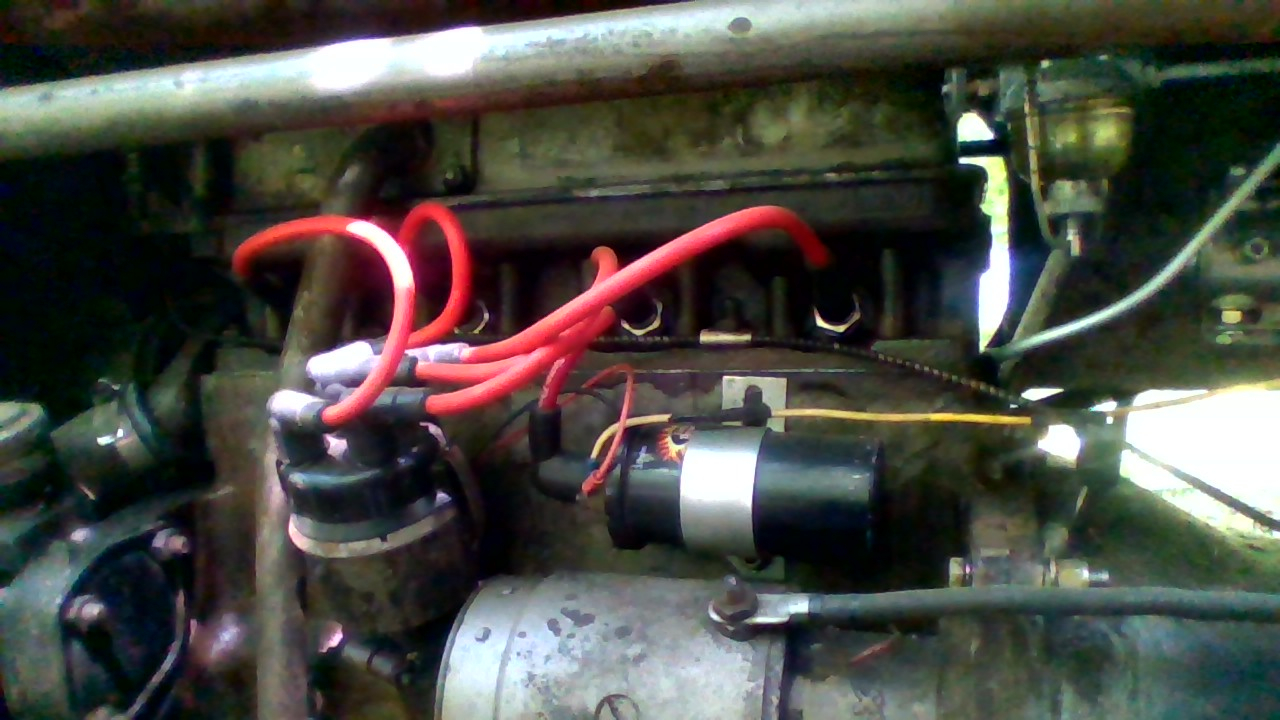

Hey fellow TBN members ! This is for M-F owners who are tired of points & want to do a simple conversion to a electronic ignition & use the stock distributor, cap,& rotor. Benefits set your timing once & forget it plugs are less prone to fowling, & all you need to check is the distributor cap & rotor button for wear,& spark plugs last 2 to 3 times longer.o_O I've been using them on my M-F 50 for 22 years! & have replaced cap & rotor twice & plugs once & she gets used year round (y). It'a ( Pertronix ) brand you will need to get the no. of your distributor located at the base it's a tag recommendations, New 8mm plug wires ,Pertronix Flamethrower coil. Best place to get the the Pertronix & coil as far service & price is CBS Performance & there website is www.cbsperformance.com If your still using your tractor as a working tractor & plan to keep it & want reliable performance it's a good investment IMHO:cool:. I will follow up with a picture of the install in place;).

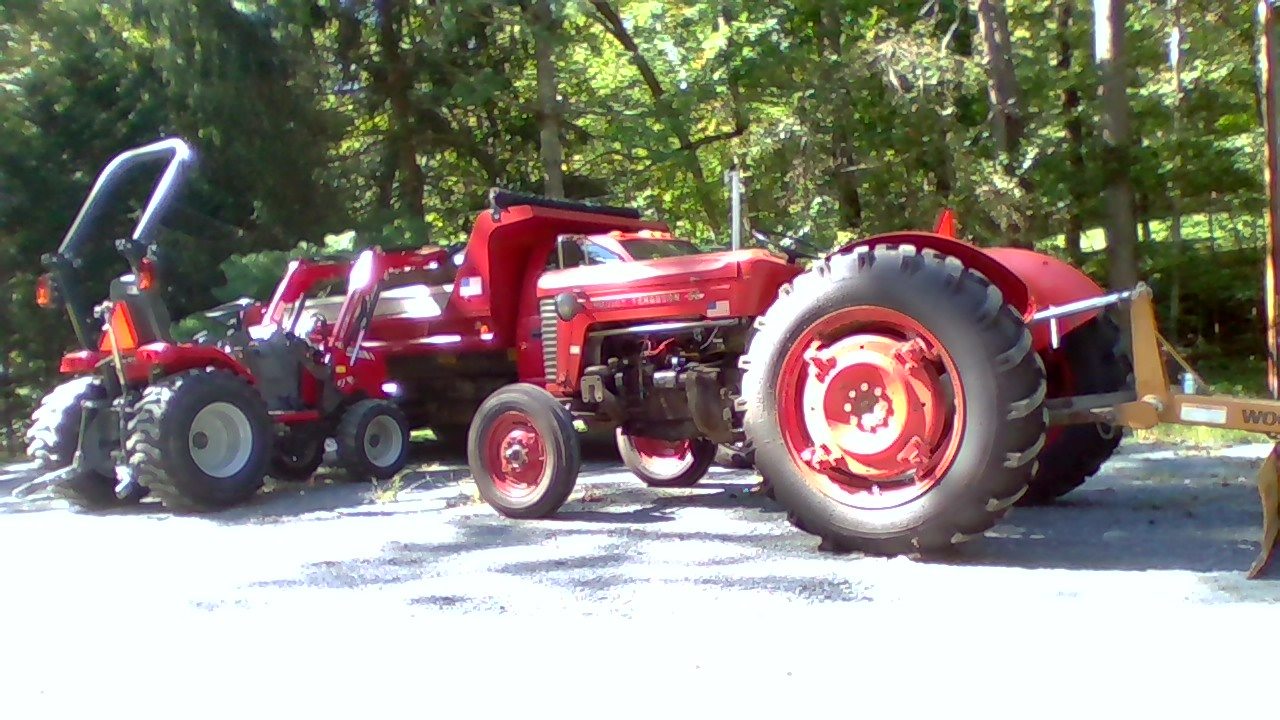

Hey SCOOBIEGUY ! Sounds good I did replace my carb. about 5 years ago whoever the original owner was striped the drain plug at the bottom & I didn't want to keep removing the carb. to clean it out & the new 1 works fine & I'm glad I replaced it works great the whole engine runs like it's fuel injected & starts right up all the time:cool:. Before You do a valve clearance check check to see how she runs with the new plugs in. & I had the fuel tank off a few times myself I think it's a pretty easy job, I've owned My M-F for 25 years now & I wouldn't trade for the anything it's just so dependable (y), Even tough I bought a brand new one in 2018 a M-F 1526 I like the 50 as much as my new one. IMG_20201003_134009.jpg

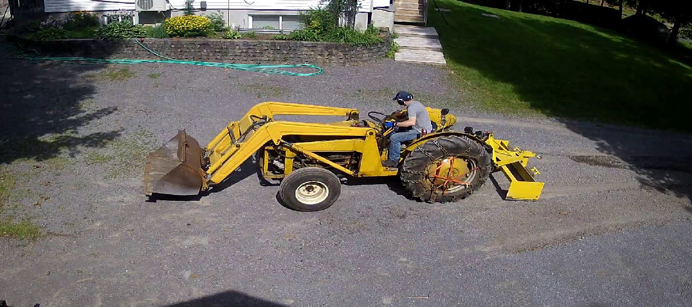

Looks like changing the plugs did the trick sputtering practically gone, used tractor for 3 hours to move 20tons of gravel with back blade.
Previous ones had fouled up, I cleaned them with a wire brush and carb cleaner but I guess that wasn't enough.
I used Champion D16 plugs because that is what was installed originally.
I see some using Autolite 3116 what are you guys running on your continental Z134 gasser?

Good one fried1765
I don't have a flat spot on my property, without 4WD I leave the chains on all year, better traction in the forest when skidding wood and dragging rocks :)
This 65 year old tractor cost me 1/6 of a new one and its really strong and serves me well.
If only it had power steering, it just means I have stronger arms I guess.
