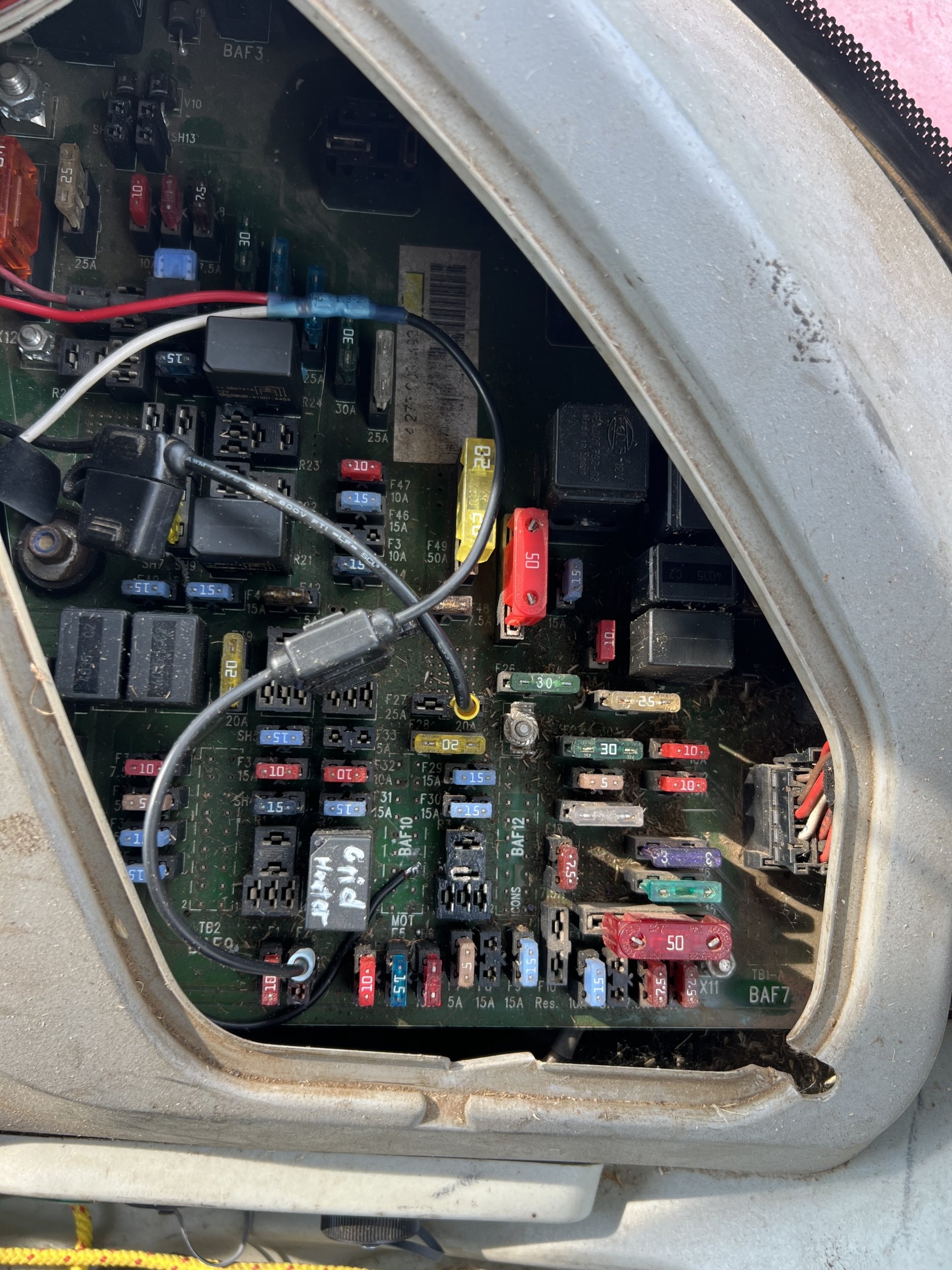

a few days ago, I plugged my rear mower into the 7 pin plug and immediately noticed the right side of the mower and tractor signals don’t blink.
If I turn on the 4-ways, only the left side blinks.
If I turn on the left turn signal, it blinks properly.
Whether rear mower is plugged in or not, I only have a left turn signal.
Nothing works on the right side. No turn signal, or nothing when 4-ways are turned on.
Checked all fuses and found nothing
I replaced the flasher relay.
There’s also a left side and right side relay for turn signals. I swapped them and still only have left side signal.

You mean pins on relays plugged into fuse circuit board?

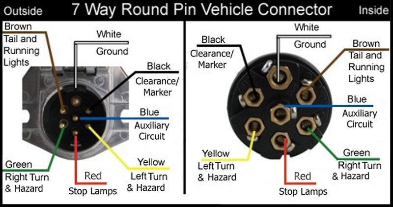

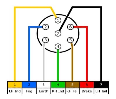

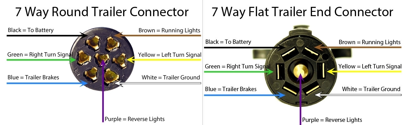

Is your Massey a 7 pin round connector?
european 7 round;
our HD 7 pin round;
and the other 7 pins;
All wired differently.
