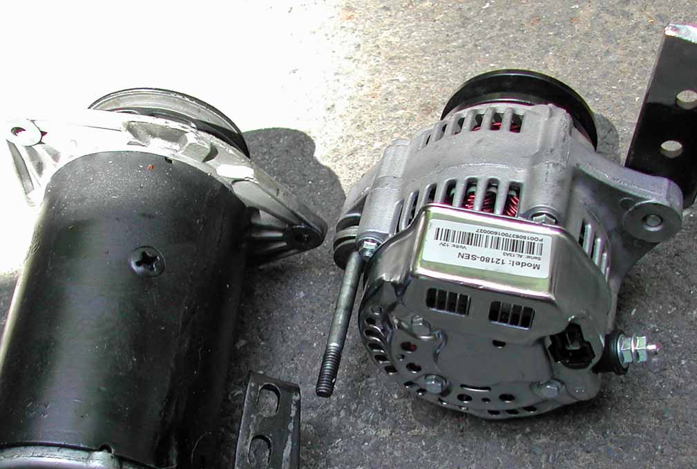

What is the minimum wiring need to start tractor, charge battery and
maybe a set of headlamps?
I just upgraded a 50s car with DC generator to a modern alternator. I elected to use a so-called
racing alternator, a self-exciting 35A unit with internal regulator/rectifier. All you need to use this
unit is a connection to the battery. You can wire your headlights directly to the battery. This
alternator (a Denso clone) cost me only $78. Works great.
