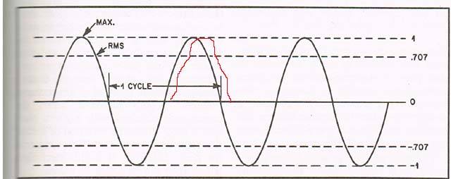

Many Many Thanks, Scott
Simply speaking, the root-mean-squae (RMS) value of an alternating voltage is the quivalent d.c. voltage that can deliver the same amount of eregy to a resistive load.
All the generators are "phase locked" togeteher. It is the same principle as synchronious AC motor running at virtually constant speed regardless of the load. There is one "leader" generator in the system that maintains the frequency and the rest of generators are running in so called "droop" mode. If the grid slows down even a fraction of Hz the droop generators will increase their contribution to the grid to add more power and vice versa. In other words the droop generators are controling power not frequency.
/ Electrical Engineering Question #75
Agreed, RMS (root mean square) is a way of expressing the sine wave form of AC to a comparable DC value for power purposes. It is 70.7 percent of the peak voltage. It is what multimeters actually measure unless specifically set-up to measure peak. Wind mills are unable to generate at 60 hz, so the unstable AC is converted to DC,like any power supply. Then digitally reproduced into a AC waveform at 60 hz. Any store bought DC/AC inverter does the same thing, and a digital O-scope can actually see the stepping of the waveform and the output of the digital -analog converter reads like this.. 111111111100000000001111111111000000000011111111110000000000
The number of ones and zeros depends on the clock speed of the chip, but the cycles are 16 milliseconds. (60 hz.)
Sorry for the long winded trip down electrical/electronic theory lane, but I love this stuff.

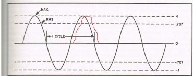

I am not trying to change subject, would just like to learn.
"It is 70.7 percent of the peak voltage."
Does this percent increase with increase of frequency?
Scott
/ Electrical Engineering Question #77
Scott
No. For a sinewave (and most are or close to it) it is 70.7%. It does change with the waveform shape. If it were a square wave it would be 100% of peak voltage.
