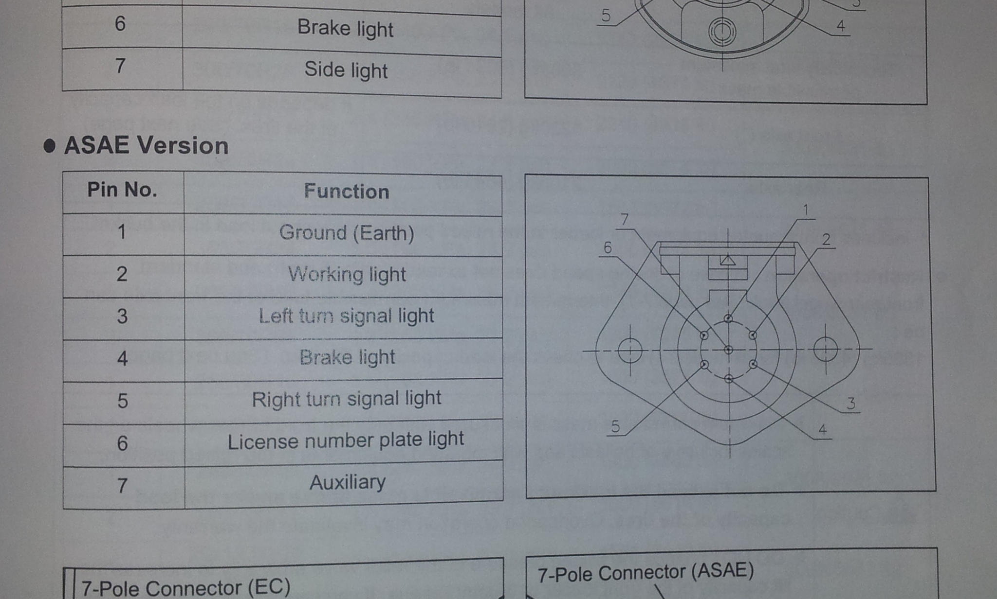

Guys,
my LS4041 has an electrical connector behind the seat. I assume this is for trailer lights and possible breaks. Can someone point me to the name of that connector and does anyone has a pin-out?
I like to see if it is possible to power a small electrical pump for a sprayer from this outlet.

   / Electrical Connector in the back #4
is that the 7 pole connector on the back? this is the diagram for my xr4046hc which i would think will be the same. Hope it works for you. just use a 12 volt test light to confirm. 20140317_085141.jpg
   / Electrical Connector in the back #5
This is probably a stupid question but what type of male plug insert does that take? Is this a typical 7 pin type trailer plug or is it some kind of European type of plug? I have wondered this for sometime but it has never came up, and I didn't need it yet but is seems pertinent.
   / Electrical Connector in the back #6
they show in the book two versions, , the European one and the ASAE one. The Asae one I believe is American SAE.
The Plug is the same one that is used on semi tractors for their trailer plug in. I tried it, but all my stuff that I would pull is the flat pin rv style so I replaced it with an rv receptacle. the issue that I had was after removing and replacing the round pin to the flat pin receptacle, I found the little plug in behind it to tie it into the loom and the wires are extremely light gauge. I am going to run an additional wire from the battery back to the plug with some #12 gauge wire and a new fuse so that I won't get a meltdown if I want to run a pump or anything that has a heavy power draw yet I still want to be able to just plug it in. this way I will be able to power different items without worrying.

Duh... I forgot the manual had that image!
