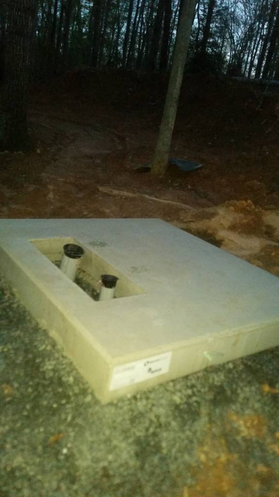

As somebody noted, all utilities seem to be different. Mine would go something like 150' from the road for no special charge if you went overhead. They'd add one pole if necessary. Beyond that there was a charge. If you went underground, you had to do it or have it done at your expense, but they would set the equipment at no charge.
   / Electric transformer in front of house (on ground) #33
I paid them about $1500 in 1993 to move mine to behind the house.

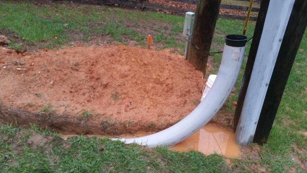

Same here with my coop, had the option of overhead or buried, I went buried with the transformer about 25ft from the shop (having to run 6in conduit almost made go overhead) .
6 inch conduit? a misprint I hope
   / Electric transformer in front of house (on ground) #35
Nope, for 3phase 6in is the spec. Single phase is only 3in.
Real fun to work with, especially when the trench floods and floats it after only part of it had been backfilled.

I work for a utility and we require at least 8’ open area in front of pad mount transformers. We use 8’ hot sticks to de-energize transformer to do maintenance.
