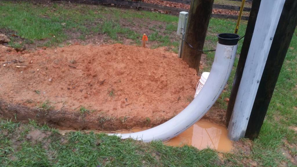

Mine in northern Michigan is buried with a signed easement. About 1000 ft from the overhead wires at the road. The Electrical coop gave me a choice for overhead versus plowed in. Overhead was like 30 ft easement, plowed 10ft wide. Transformer is about 200ft from the house and was about at the limit from the street without having to set an intermediate box. But the transformer is about 25ft from the outbuilding. Both the house and outbuilding have their own 200 amp panel at the meter stand which is 7ft from the transformer. And no landscape covering the box. Jon

Same here with my coop, had the option of overhead or buried, I went buried with the transformer about 25ft from the shop (having to run 6in conduit almost made go overhead) .

I had to grant power company an easement from the junction box all the way to the meter-power company is responsible for everything upstream of the meter in my area. I always thought it a bit strange that I paid for the cable, the transformer, conduit and associated trenching/filling and they end up ‘owning’ it.

Same with the easement from meter to pole here but I only had to provide the conduit and the precast concrete pad installed to their specs.
Meter base, wire and transformer were all provided by the PoCo, no charge.

I would like to add to your post Moss.The biggest problem I have found with under ground wire is if you have a fault its harder to locate verses overhead wire on poles.You need special equipment to locate UG faults it can be a PIA to find the fault at times.
