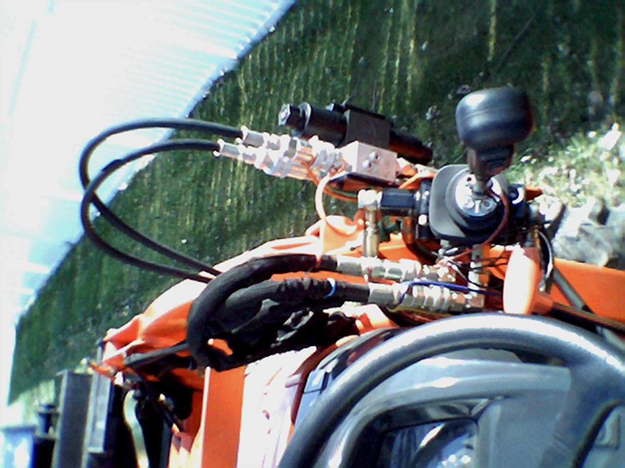

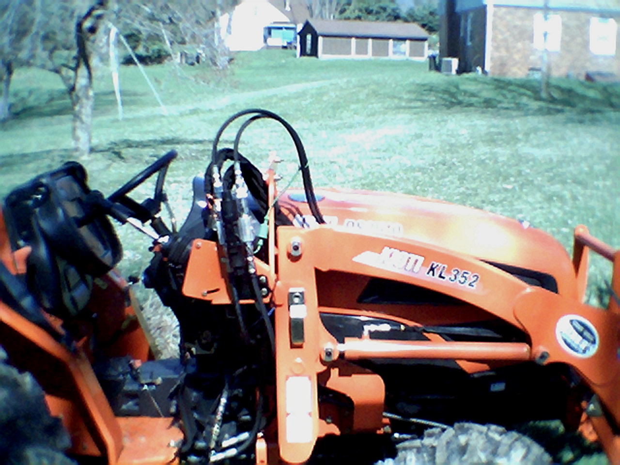

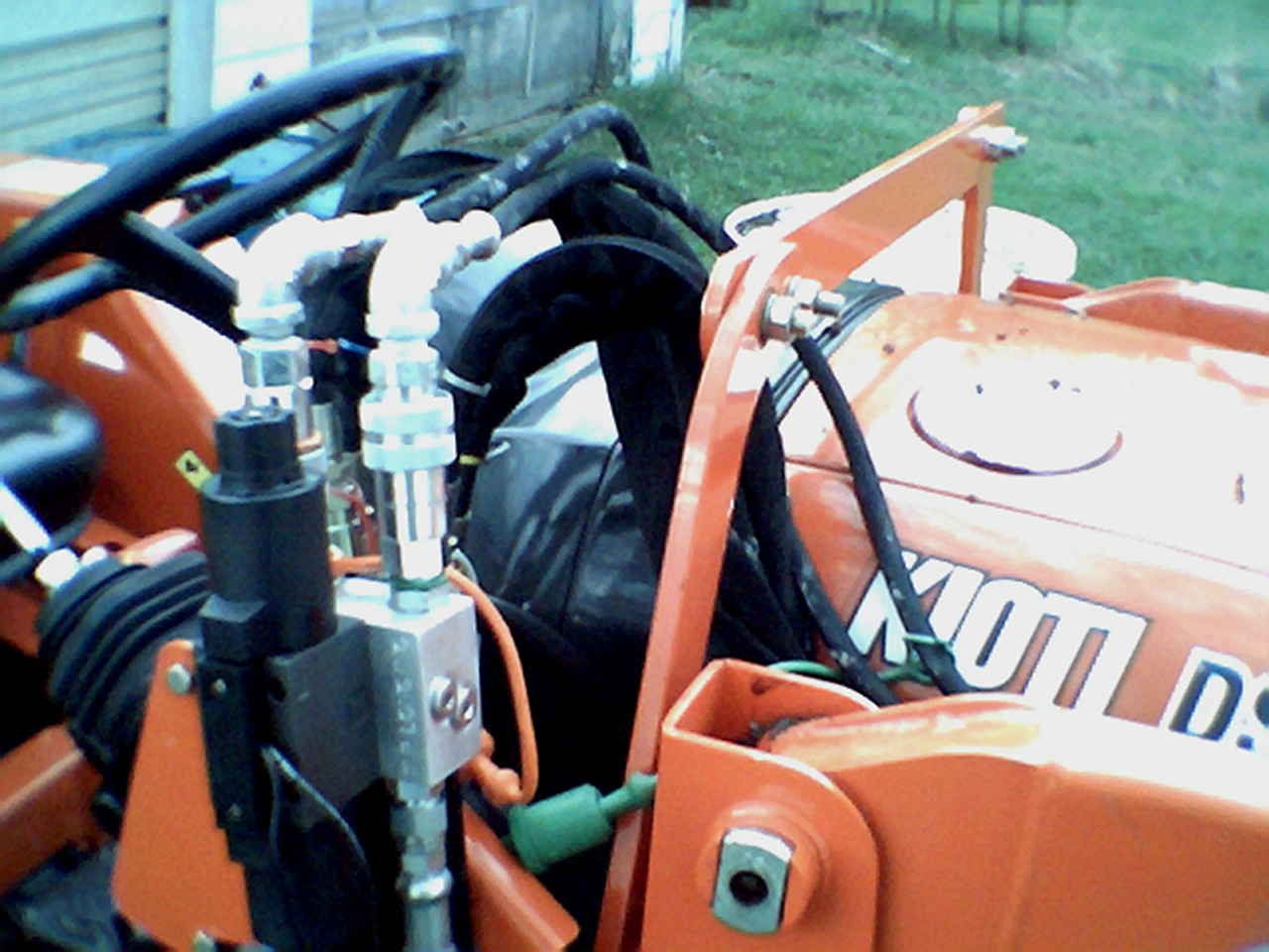

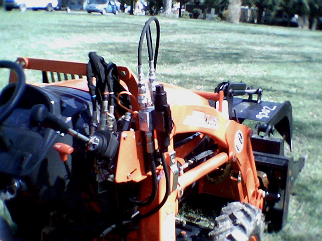

Here are some photos. This is on a Kioti DS3510. It is mounted outside the loader mount due to space consideration. Long got drawings from Kioti before making mounting attachments. That is why it took a few extra days to get it out to me..
The galvanized fittings have been replaced with steel hyd. fittings for those who wonder..They were temporary..Plus they were tested on a hyd test bench to 3800 psi. That is more than it would get to in use...I was curious after it was mentioned on my installation thread.

Can you post a link to the two you are talking about? I was looking at them on their site, and (what I was looking at) the WR Long kit was true third function, and the EA kit was a diverter using your curl function to run a grapple , etc. Just want to make sure we are on the same page here.
