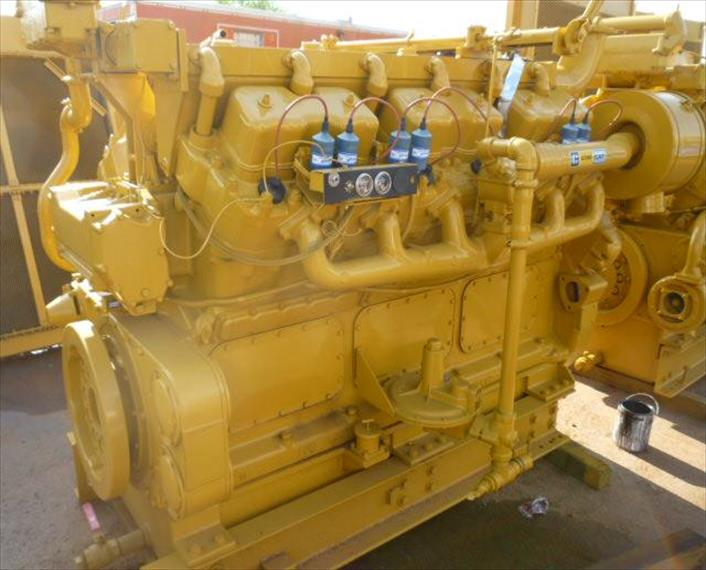

Also I think most duel fuel propane motors need to be gasoline, not diesel.
Nope. Just add spark plugs, magneto, and a carburetor (simplifying). Caterpillar used to do it.
   / Electric conversion of a Kubota B26 / Similar #80
Compression ratio might be a tad high. "just slide another headgasket in there, and call it good" ;-)
