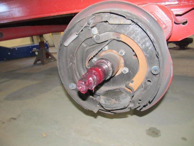

12x2 are standard size on 5.2K, 6K, and 7K axles. You have the right sized brakes.
I'm wondering if the axles are not installed backwards having the right brake on the left and vise versa.
Chris
Definitely something that could cause the problem. I looked at CornPro's website and they list Dexter axles as standard. Dexter has a great resource for anything concerning axles and brakes. If you go to this page and look at the pull down menu, you can find a troubleshooting chart listed under trailer brake resources. It may help you.
Dexter Axle - Trailer Axles and Running Gear Components - Resource Library
I would also call Dexter and talk to someone directly. There are lots of parts changers out there who just guess and hope they have found the right problem. I'm not saying that's what your RV guys were, but I'd take the problem to Dexter. They are considered the best product for a reason.
Something else I'd do is check the amperage draw at each magnet to eliminate a wiring problem. Just because the voltage is there does not mean the proper amperage is getting to the magnets. Where do the grounds from the brakes go? If they are just grounded to the frame, that can be a problem - lots of shortcuts are done on wiring. The grounds should go to a common ground wire that passes all the way through the plug and directly to the tow vehicle negative side of the battery.

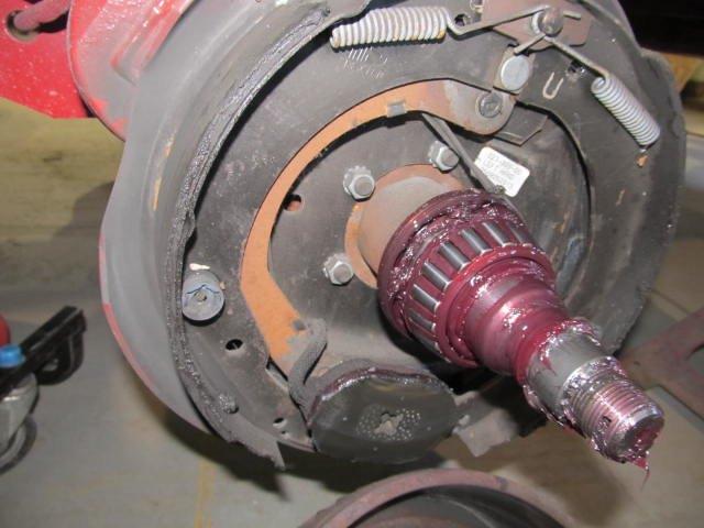

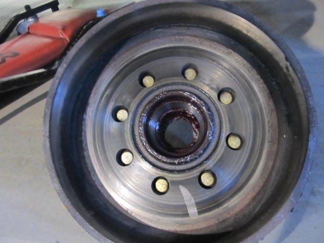

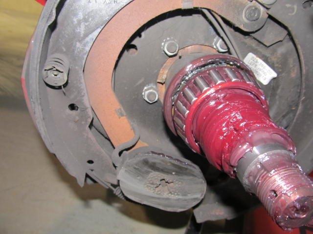

Did you pull the brake drums to see if grease is still leaking out onto the shoes and drums? Maybe it's a problem with the axle shafts not being machined properly allowing grease to leak out. If the grease is still leaking out maybe you could tray putting bearing buddies on the axles. They are designed to prevent pressure from building up and forcing grease past the seals. If it's not grease then it could be the wiring. Make sure the ground wires are making good contact with the frame and check to make sure the wire they used going to the brakes is large enough gauge or isn't damaged.
I would suggest checking with Dexter (think I read that they made the axles) and find out how much current should flow through each coil. You would need to put an amp meter in-line with each brake and you should be able to tell how much current they are drawing. It would be easy to do. Just make up a short cable that has both the male and female ends on it, an extension and put it between the trailer and truck. Cut the brake wire and connect an amp meter between the two wires. I think I remember something like each brake should draw about 3 amps. So that would be 12 amps for a 2 axle trailer.
