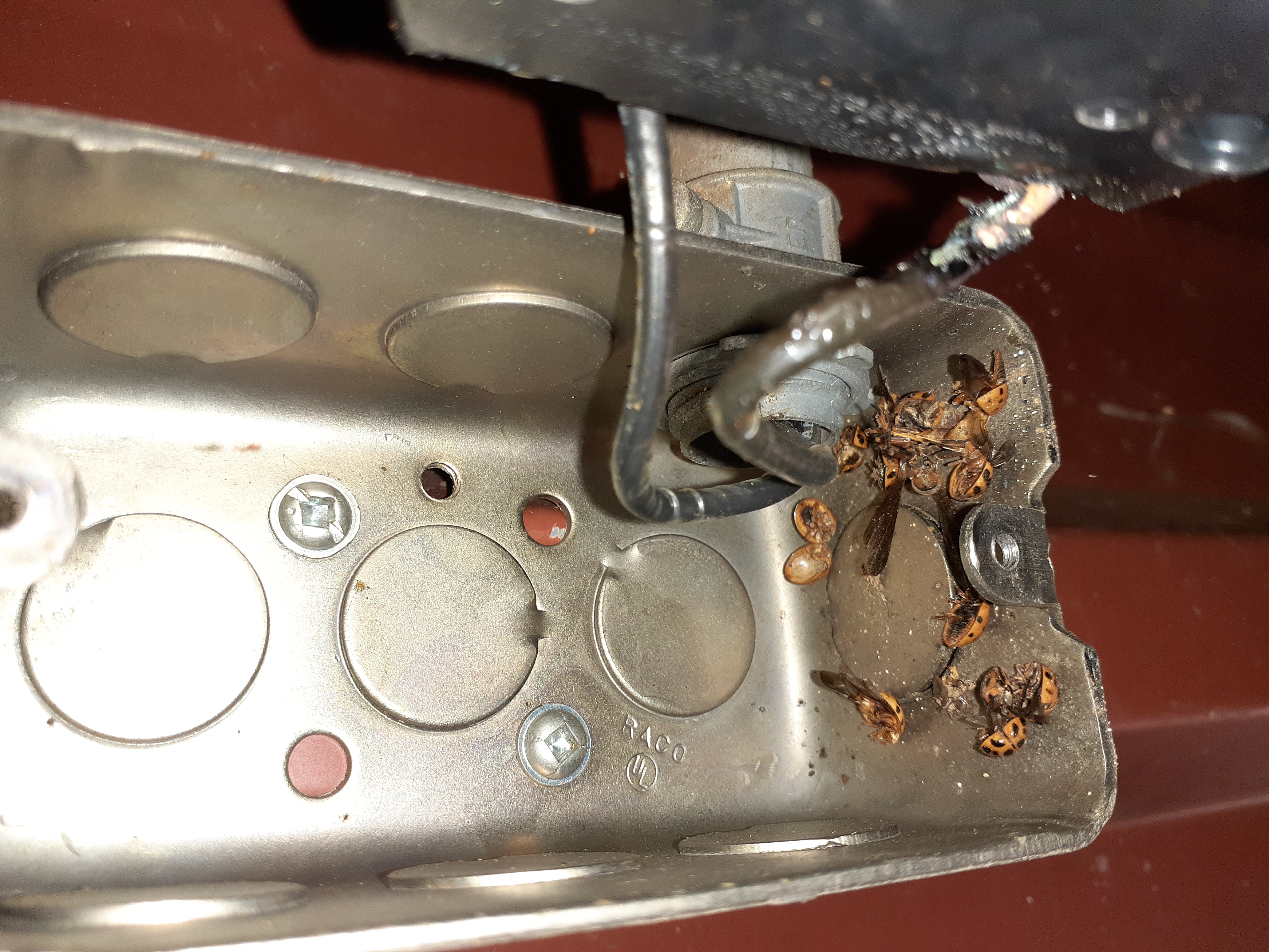

I've a switch for overhead lights in one of my workshops that started acting erratically.  I hate working on electricity ever since I shorted wires on a wall plug when I was about 4 years old.
The switch wouldn't turn off and was slowly smoking. Opened up and found about 10 dead lady bugs.
/edit - don't know why the pic shows up landscape until I click on it.:confused:

Couple questions/observations.
All the knockouts appear to be in place in that box, so how did they get in there?
Ladybugs aren't known to eat wiring (they eat aphid, mostly)... did you see any damage to the wire?
I would guess the switch was bad/going bad, or, the wire connections to the switch weren't tight, and that caused the heat and switch to malfunction. Ladybugs are known to seek out warm spots, so it wouldn't surprise me to see them in there, however they got in.
Got a picture of the switch?

@MossRoad most "Rainproof", aka 3R, enclosures have pretty substantial weep holes by design, and many that I have seen have screw holes used in other versions of the enclosure but open in the one in question.

Yep. I just didn't see any obvious holes in the OP's picture for the ladybugs to get in.
