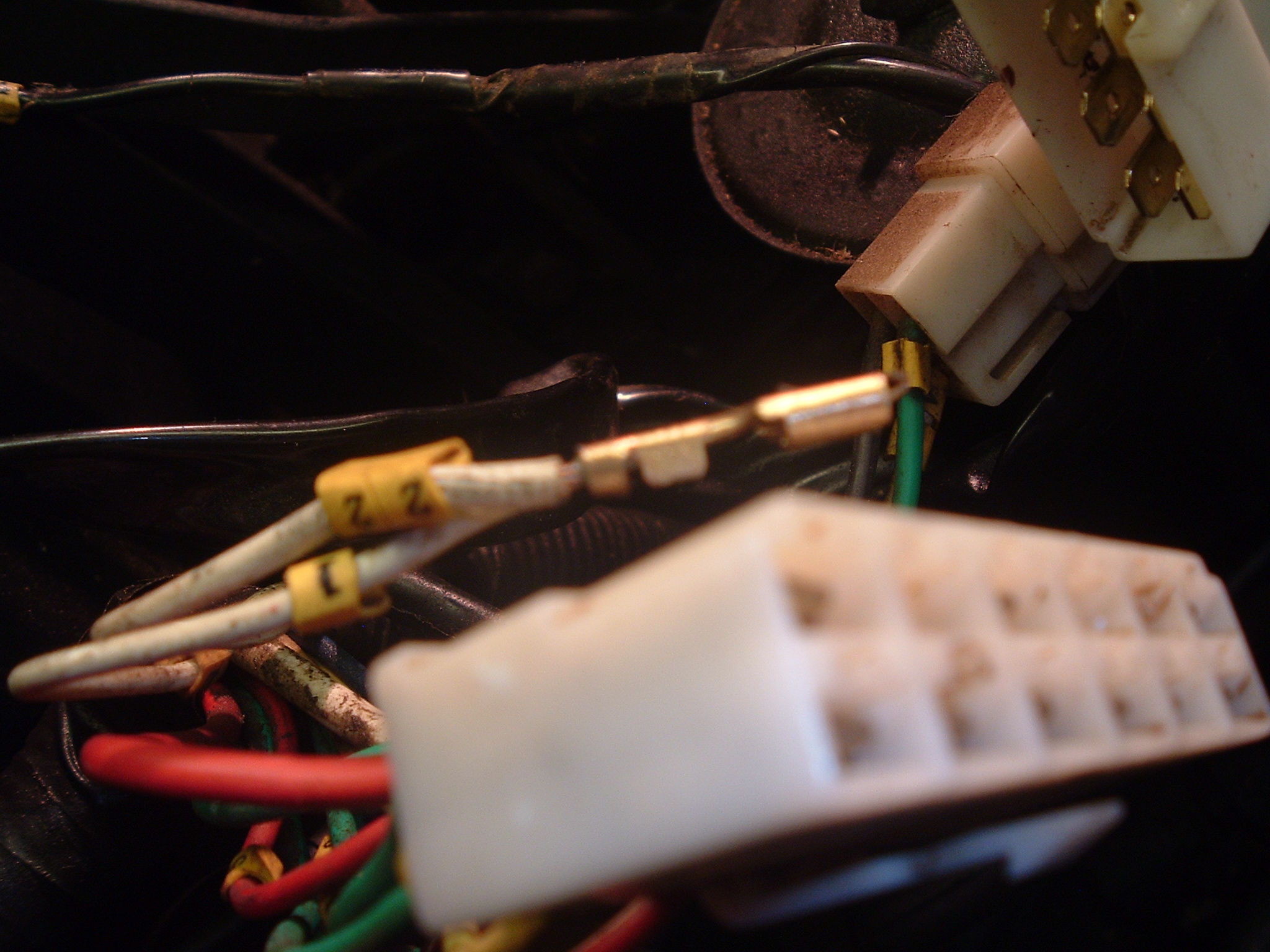

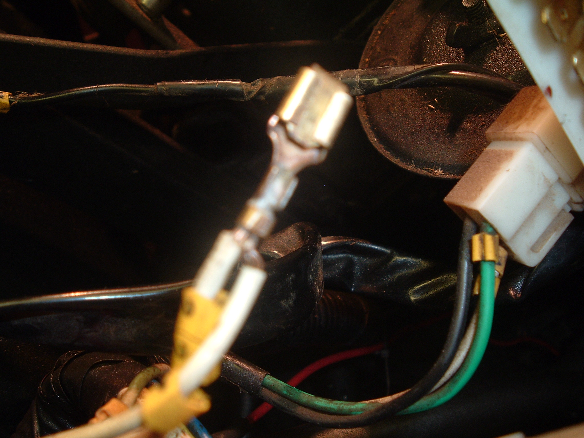

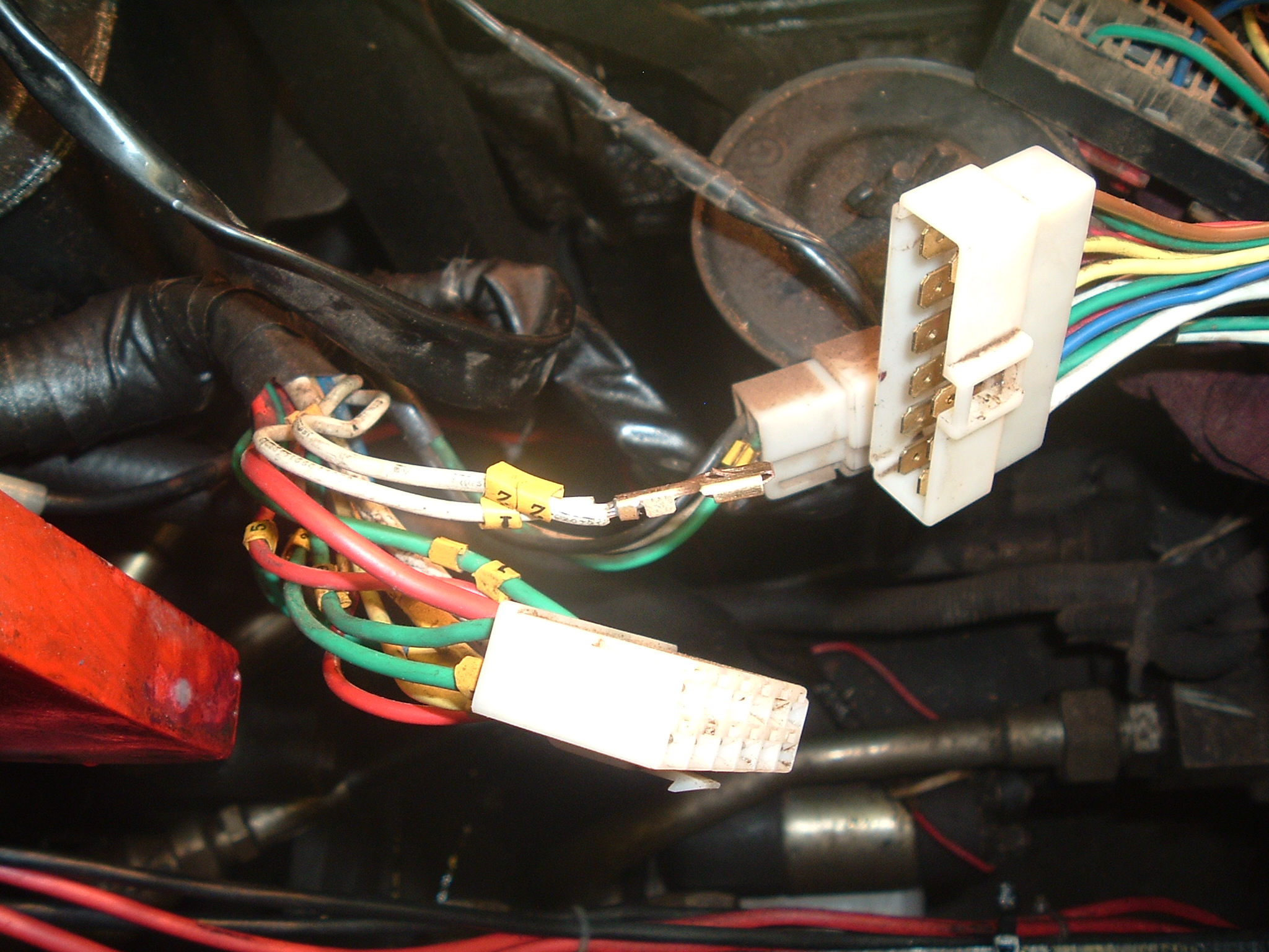

I had problems with my Jinma 254 too. When I turned on the headlights the fuel gauge stopped working. I found that the 12 pin electrical connector (located beside the fuse block) had some loose connections. I removed each female spade from the connector and closed them slightly with a pair of plyers. I then tested how tight they were on one of the male spades before reinserting them.
The are easy to remove by sliding a minature screw driver between the spade and the connector block. This will push in a small release arm and allow the spade to be pulled out from the rear. Bend the small release back out again before reinserting back into the connector block.
