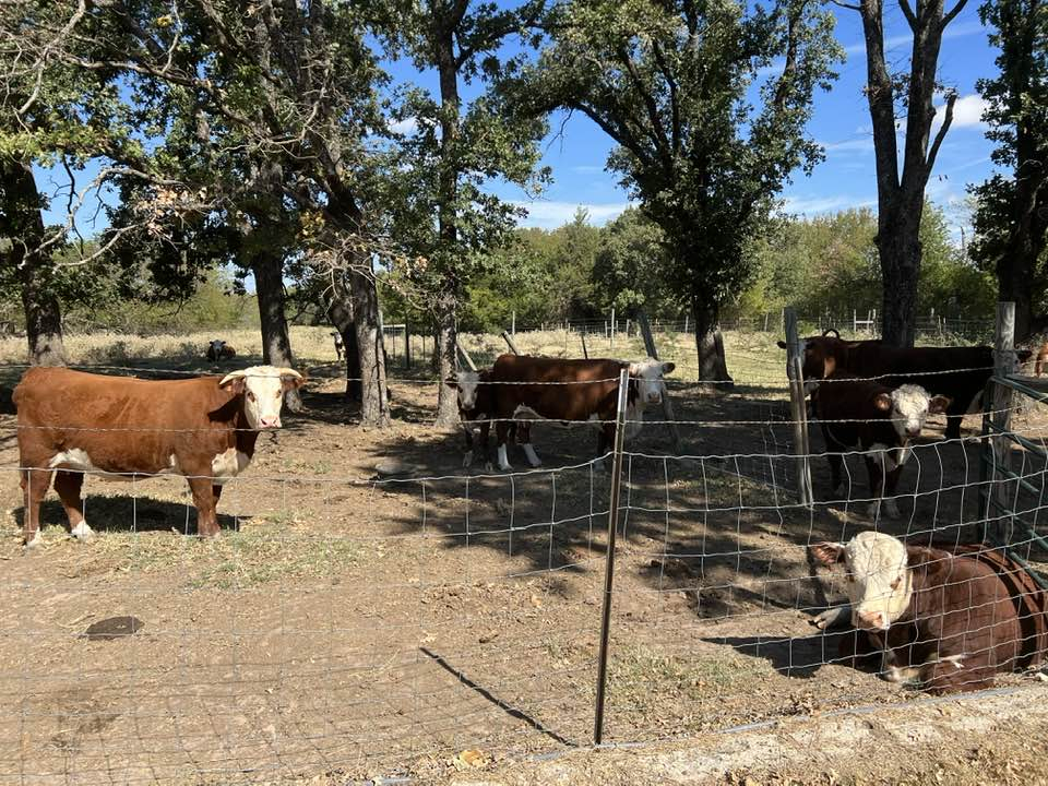

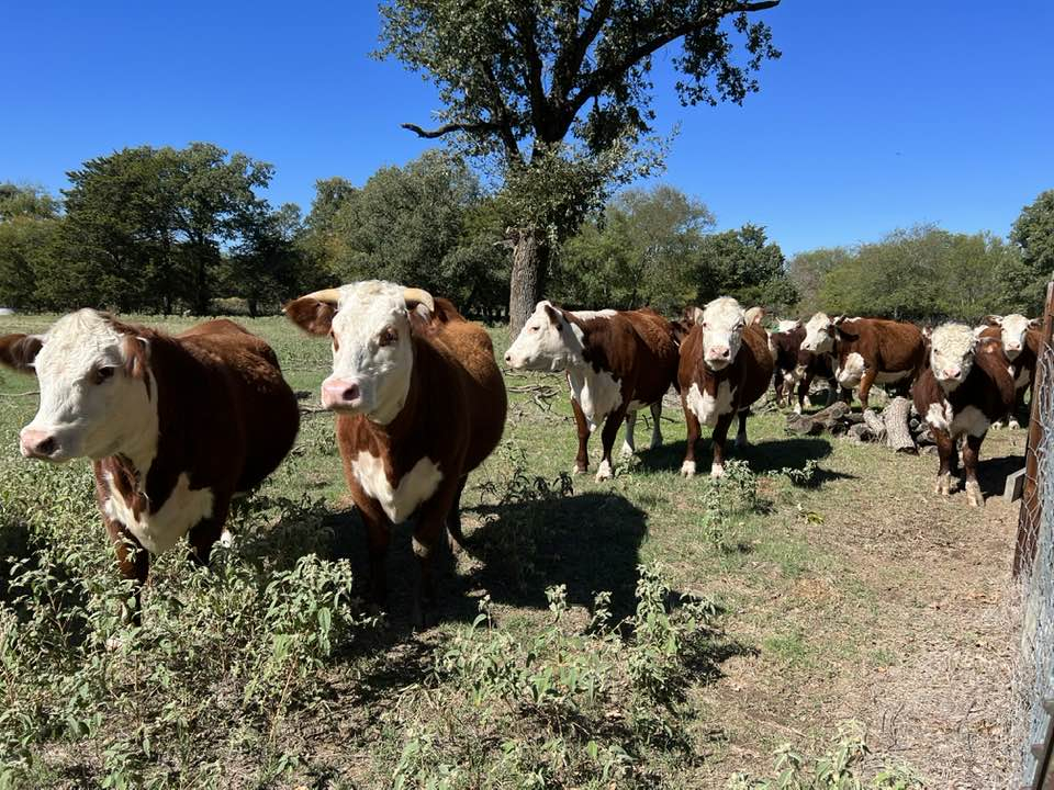

With the recent passing of my brother, I'm in the process of taking ownership of his cattle. He has a 40 acre farm about 60 miles from my place. I have 68 acres. He has 15 Herford's and one Angus bull. From what I understand, he just bought the bull for $3,500 and he was wanting to cross breed the Herford's with the Angus to create Black Baldies.
Of the Herford's, there are 11 cows, but some might be heifers. I don't know their ages or history. There is one steer, and three intact, young bulls.
He does not have any type of handling system. From what I've been able to figure out, the got them into a fenced area that's probably 100x100 feet, then he used gates to funnel them into his trailer. I don't know how often he loaded them up, but I did find a receipt from the Van Zandt Livestock Exchange from earlier this year for a single cow.
Some of the cows have ear tags, some don't. None of the bulls have ear tags.
Some of the cows might be pregnant. They look like they are getting big around the belly. A lot wider then some of the others.
I do not have any records of any of them, but there might be something in his safe, which I still have to get into.
I'm currently feeding them 3 round bales a week of hay that I had planned on feeding my horses this winter. They are eating a lot of hay, way faster then I expected. I do not have enough hay to feed the cattle and my animals, so I'm going to have to buy a lot more, which is going to be expensive.
I need a plan.
I've started fencing part of my place that will be 24 acres when done. Eventually I'll fence in all of my land, but it's slow going and expensive. I do not have anywhere to put his cattle on my place right now, I'm maxed out with horses and goats.
Option 1 is to leave the cattle there and fence in my place, then bring them here and create a handling system, bigger barn and improve my pastures.
Option 2 is to do the same, but only bring the cows and Angus bull here, and leave the Herford bulls and steer there. I also think that I need to turn the bulls into steers, but I've never done this, and I don't know if it's too late or not. I will have to build a handling system to do this too, but I think I need to build it just to load animals.
Option 3 is to sell some of them right away. I'm planning on going to the Van Zandt Livestock Exchange next week. They have it every Saturday, and I drive right past it getting to my brothers place. The parking lot is full of trucks with trailers. I've never sold cattle, or been to an auction. So I need to figure this out right away. I think that the bulls and steer are too young to sell, but I don't really know for sure. I could get rid of some cows, but I don't know how to tell which ones should go and which should stay? My brother has a few friends that raise Herford's that have offered to help, but have been very slow to respond when I've asked questions. Or they reply that they will get back to me, and haven't. I think that I'm going to have to learn this on my own and help from others isn't gonna happen.
Option 4 is to sell all of them, cash out, focus on getting my land ready for cattle and my pace, and then buy cattle when I'm ready for them. I think this is the easy way out, and maybe the smart thing to do, but it goes against everything I believe in. My wife and I really want to keep the cattle, and build up a program to raise and sell them.
What would you do?
If I sold them at the Livestock Exchange, what should I know? Will they want proof of ownership? Proof of shots or medical records? I'll ask when I go there, but I'm hoping to have a small amount of knowledge before walking in there blind. Livestock Auction | Van Zandt Livestock Exchange | United States
And then there is the ultimate dream for all this as of right now. We buy the 40 acres, develop it into a hay ranch. The grass is really nice there, but its being chocked out with weeds and mesquite. I can clear the mesquite, spray and mow the weeds and end up with some really nice hay. I don't have any hay equipment, so that will be another challenge, but not too significant. Then it will also become our steer pasture, where we bring the steers from our place and let them grow out on his place before selling them at the Livestock Auction, just down the road. The cows and Angus Bull will do their thing at our place and we'll focus on breeding them here.
Doable? bad idea? other then spending lots of money, and there not being enough time to do all of this, what else am I missing?
Thanks
View attachment 769357 View attachment 769358 View attachment 769359 View attachment 769360 View attachment 769361
