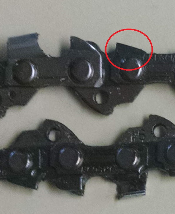

I found the paper...
It says it fits Echo 18" CS400, but the two chains from the box are bigger looking than the original Oregon chain.
In the 4 chain pic, top is still brand new, 2nd is Oregon, 3rd is the other one from the 2-pck, the bottom is off my Stihl 18" MS261 18"and it is longer/bigger...
Hmmm... I'm still confused.
David
The second chain is some sort of safety chain.
note ramp
You should be able to pull the chain down slightly when it's "tight", and always tighten while lifting up on the end of the bar.
/edit and you are probably running the wrong chain for the sprocket.
It wouldn't be the first time a retailer put a saw together wrong.

Lay the bar on a flat surface and make sure it has no warpage, that the bar groove is open all the way around with no pinching anywhere along it's entire length and once you've verified that install the correct chain, tighten it enough to allow you to move the chain, with gloves on, to verify it does not bind anywhere along the bar. Run the chain from the master link, (where two teeth are on the same side of the chain in sequence), all the way around the bar to where you began- again with no binding or tight spots. You should be able to pull the chain down maybe a half inch near the bottom of the bar close to the entry of the chain into the sprocket cover area, when the saw is cold.
